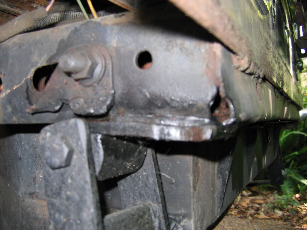

Since funds are tight, we are going to have to complete the suspension upgrade in stages. First, I needed to address the rear crossmember where the PO welded some angle iron to it and attached it directly to the body, which resulted in a crack shown here:

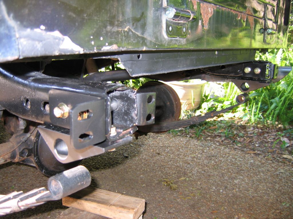

I assume this was done to remove damaged ends from improper pulls etc. The remaining crossmember was bent in spots as well. I used a cutting disc to cut out sections of the crossmember so I could get to the welds attaching it to the frame rails. I didnt get pics of the process, but here is the end result.
Removed the monster rear shackles. These things were 6.5" bolt to bolt and the bushings were pretty worn.
With a combination of me on the cutting disc and Dad on the acetylene torch, we removed the welded on shackle hangers.

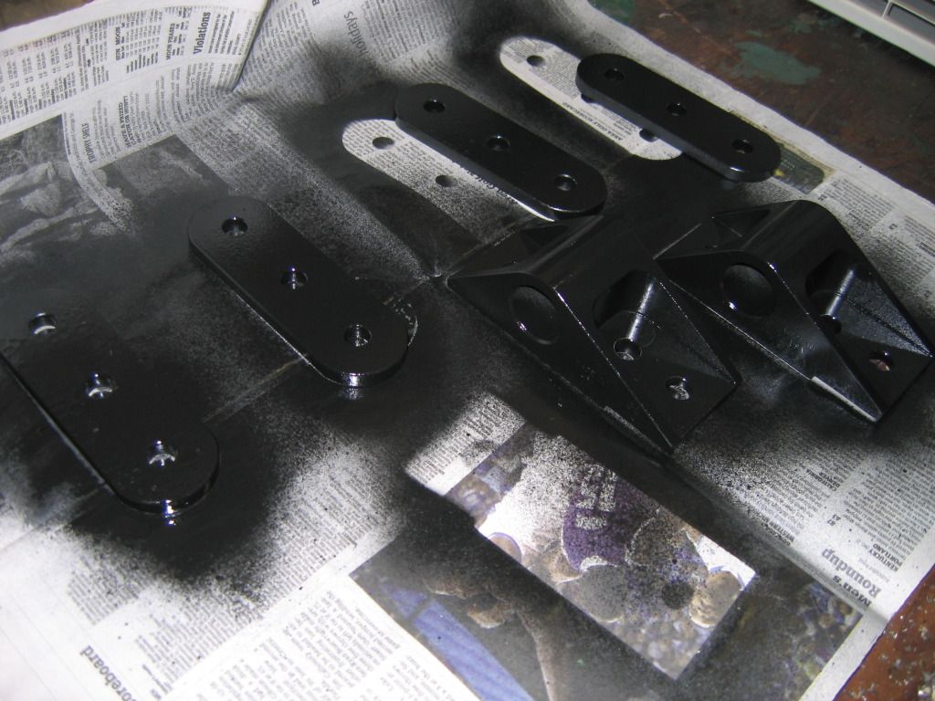

The Crabtree Shackles and Hangers arrived. Precision craftsmanship, made in the USA! Shot them with some paint. Pictures do not so them justice.
Also received some frame rail tie ins from Besrk. These these things are heavy duty as well. Both Jim Crabtree and Eddie supplied great hardware kits with their stuff. Mocked them up and assembled them along with the factory tie ins.

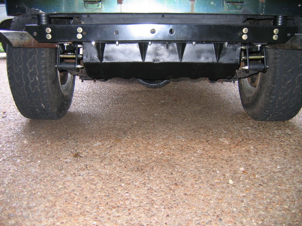

Next was the new crossmember, rear body bushings, fuel tank and skid plate. Finished up by connecting the new shackles to the leafs.

That does look nice! Is that the genright bumper/ crossmember?

Thanks....Its just a replacement crossmember from morris4x4. But anything looks better than what was on there.
