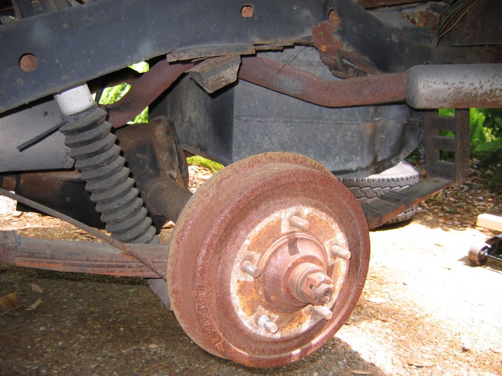

Took a look at the rear brakes today. Jacked up the rear of the Jeep and put it on jackstands. The drivers side was spinning more freely than the passenger side. Removed the wheels so I could pull off the rusty drums.
Drivers side came right off, but I had to coax the passenger side drum off by tapping with a hammer, wiggling and pulling by hand.
I believe the shoes on the passenger side were making slight contact with the drum causing it to bind. I didn't really notice anything that indicated replacement was necessary. What do you guys think?
Brakes look to be new in this pic, the little horseshoe clip at 1 o'clock needs to be pinched closed bringing the ends together will allow it to stay put and keep it from sliding off the park brake retaining pin.

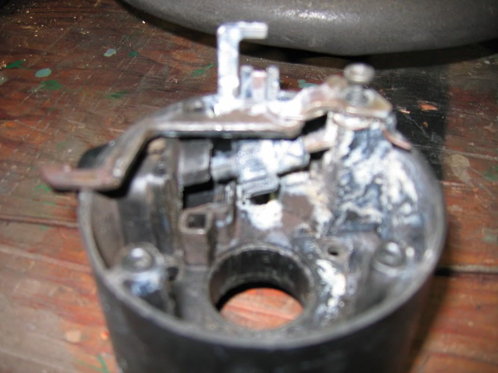

With some help from Skerr and mopar346, I was able to figure out how to get to the rack and sector gear in the column. Thanks guys!
Slid the rack out and pulled off the sector gear. Both looked slightly worn when comparing them to new ones I replaced them with. That being said I believe the majority of the problem was being caused by the weak leaf type spring (pictured to the right of the rack sticking up in the pic below) that puts pressure on the rack to keep it pressed down on the sector gear. Sorry for the blurry pic.
Since the spring was weak, when I would turn the key which rotates the sector gear, the rack would rise up until the teeth would lose contact causing it to skip instead of pushing the actuator rod and in turn, the ignition switch. I could not find a new spring anywhere, so I decided to try to re-arch the spring by bending it carefully. After we got everyting reassembled, it worked as good as new.

Turtle.... late to the party but was looking at the pic of your brake drum and if that is a pic of the driver side you have some things backwards. The self adjuster wheel should be toward the rear as well as the cable should be on the back shoe. The way it is now I am wondering if you have the right hardware on the left drum and vice versa.
Paul
Paul
Thanks for pointing that out. This is how it was when I got it form the PO. Will have to figure it out as I have never done drum brakes. They seem to work well considering.
