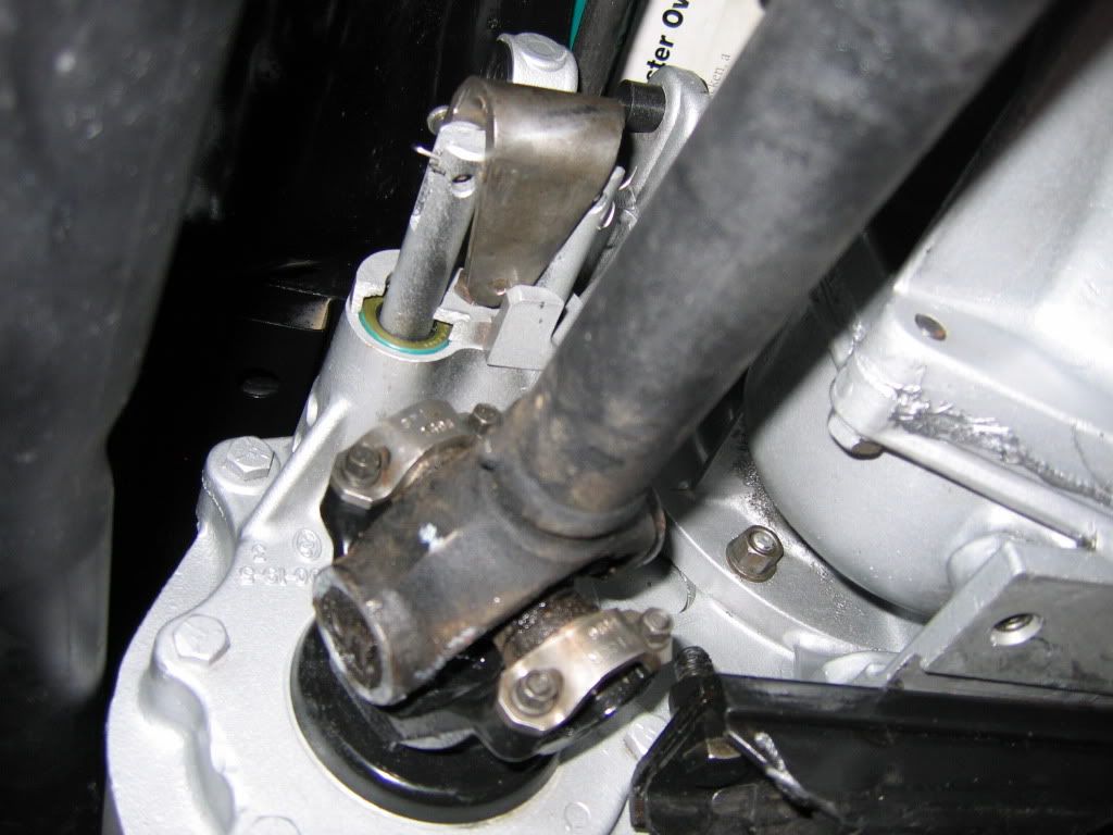

Didn't have as much time as I thought I would today. But I managed to install the drive shafts, speedometer cable, transfer case vent hose and some of the shifter linkage for the D300.

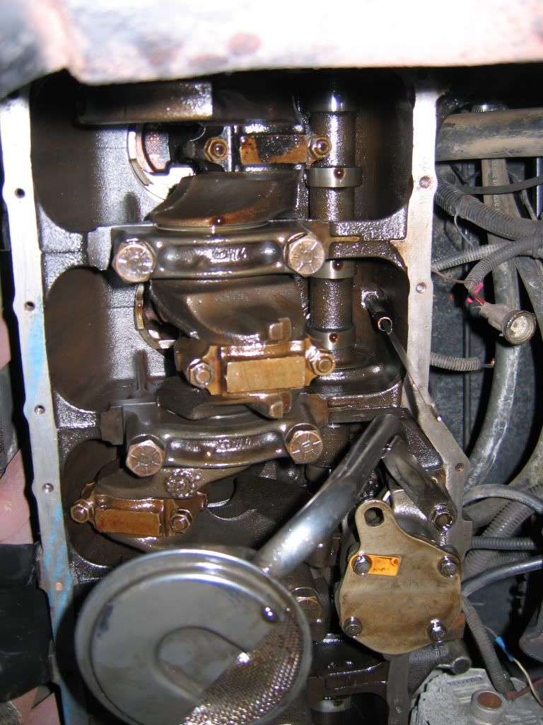

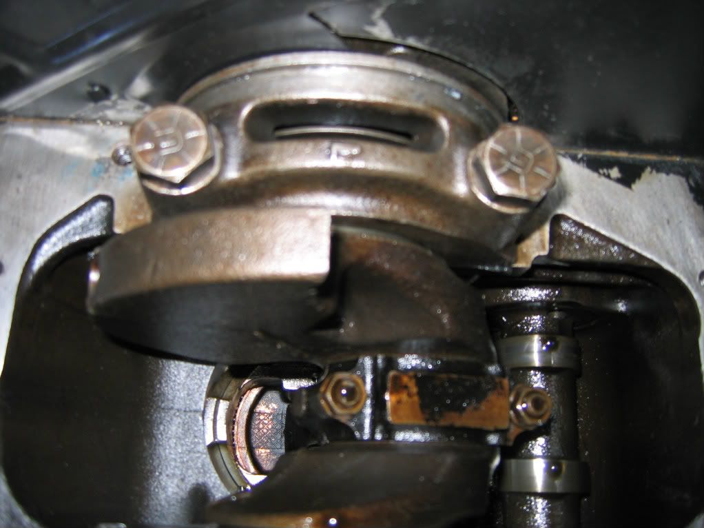

After removing the passenger side motor mount and the oil pan, the rear main seal was next. Sorry, didnt take many pictures at this point, but it has been covered many times by others here on the forum with better detail. I used the how to on MoC's build page for reference along with a few tips.
Wire wheeled and painted the oil pan.
Layed on the new one piece rubber seal and tied it loosely to the pan with sewing thread to keep it in place when reinstalling it. Used rtv in the corner areas where it looked like it needed it. Once I had it in place, I threaded in the bolts at the 4 corners, cut and removed the thread and put in the rest of the bolts. It seemed to take forever to torque them all. Next replaced passenger side motor mount, the bar between the frame rails, and the starter.

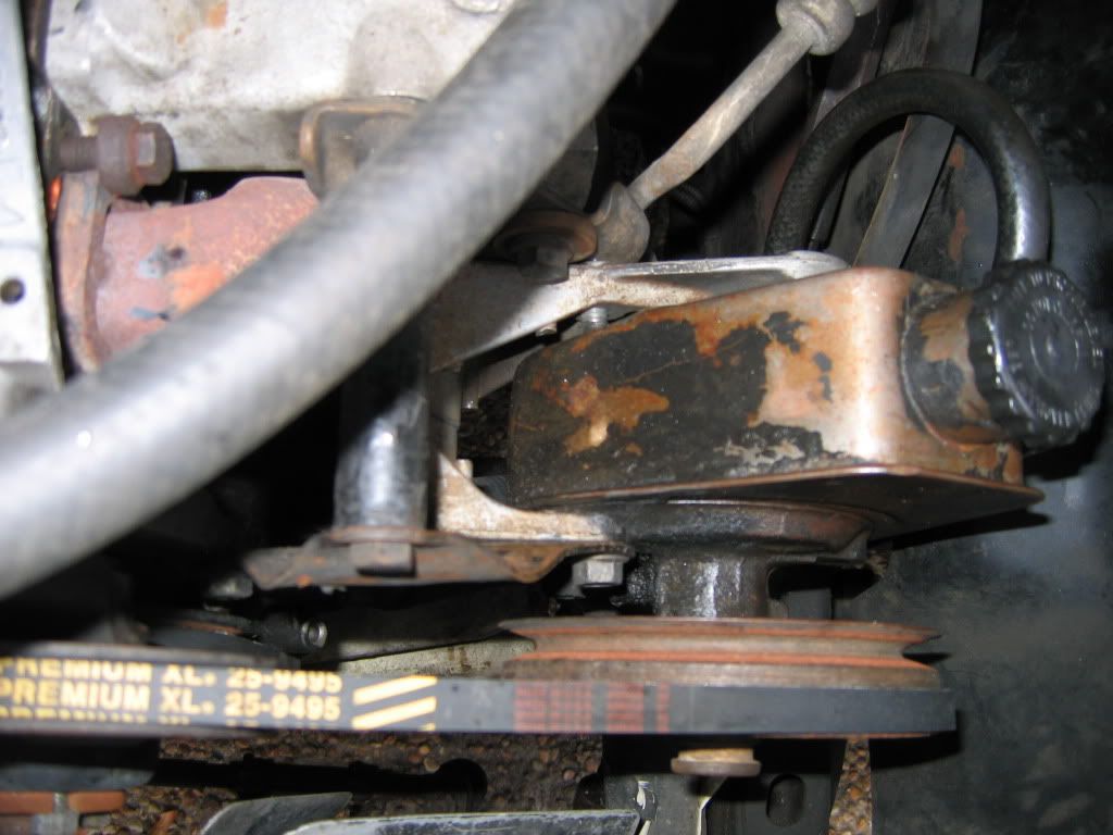

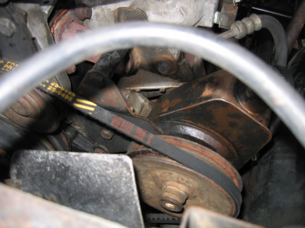

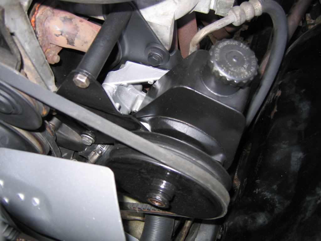

The few times I ran the Jeep before doing all this work, the power steering pump was very loud and kept getting low on fluid. It looked pretty beat up. Covered in grease and looked like someone had pryed against the resrvoir to adjust the belt at some time and dented it.
In the pic below it shows where the hose fittings on the back are located. The return line seems to be different from others I have seen as well as the new unit I will be replacing it with. Normally the return line is routed through the triangular hole in the middle of the bracket. For those that dont know, the square hole above that is what you use to adjust belt tension. Just use a 1/2" drive in it for a leverage point.
It was obvious that it was on its last leg, so I decided to replace it, and clean up some things along the way. Wire wheeled, primed and painted the brackets and pulleys. Flushed the radiator, and used JB weld on a bracket that was coming loose off one side. Then painted it with a light coat of high temp paint and also painted the fan.
Next, replaced the upper and lower rad hoses. Found cracking on either end of the return hose for the power steering. Since it was extra long from the previous routing configuration, I just cut off then ends an got rid of the cracked areas which allowed me to reuse it with the new pump.

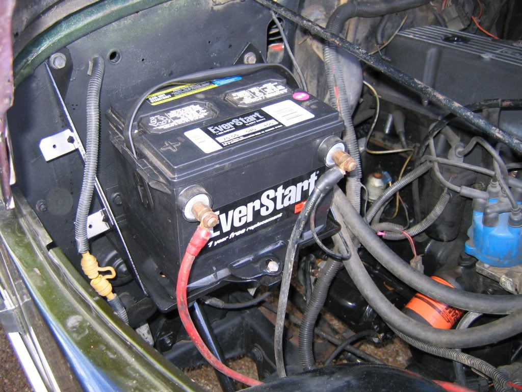

The battery tray was rusted through. After the new one came in I noticed that not all of the supports were included.
So I wire wheeled, primed and painted the old supports and painted the whole assembly to match.
My 83 CJ7 Build:

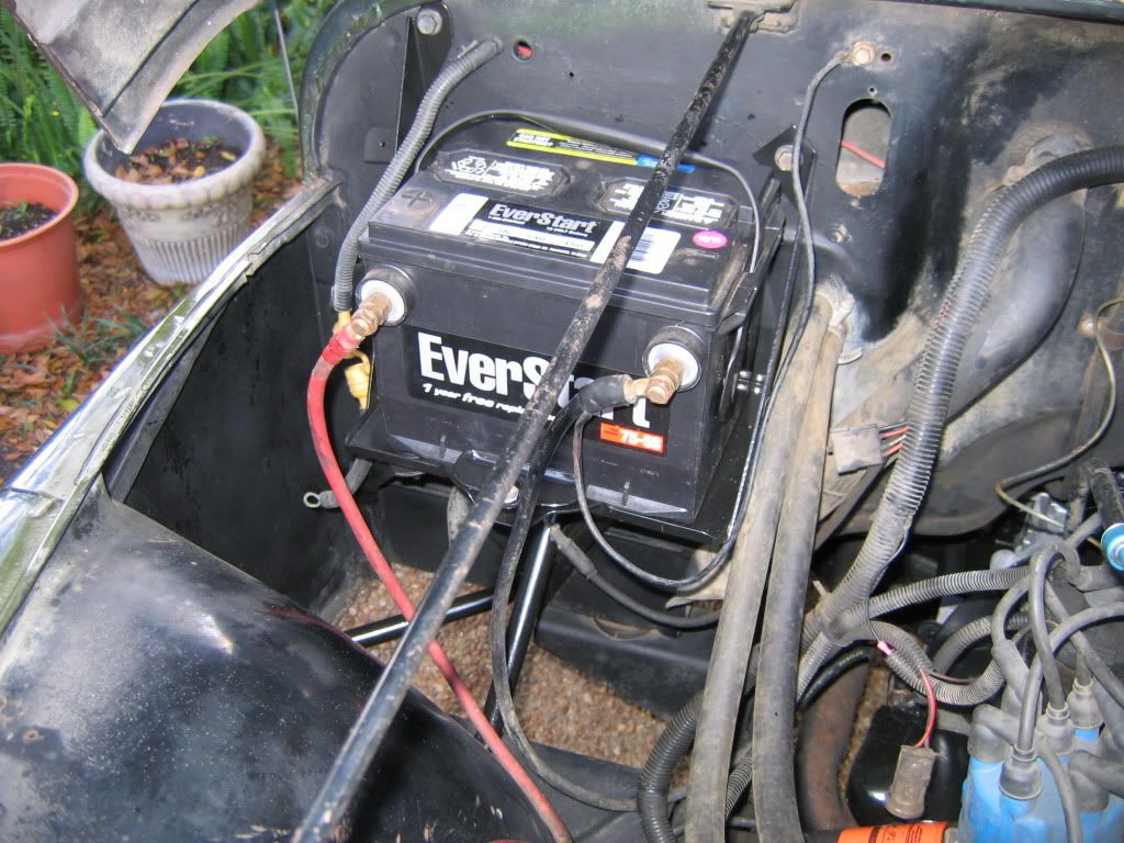

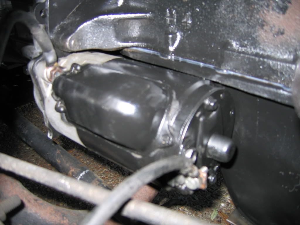

As you can see I finally reinstalled the battery after charging it. Ready to start this thing up...has been a long time coming. Started doing my checks on fluids. Oil...check, coolant...check, PS fluid...check. Keeping some extra ready for replenishing when needed.
Poured a little gas in the carb. Turned the key and it starts up on first try..........and dies immediately. I noticed the key seemed to stick with the starter going and did not spring back, so I turned it off and tried to start again......nothing.
The key cylinder always felt a bit off and it was sometimes difficult to get it back to the lock position so I could get the key out. Tried to start it several times. Sometimes it would seem to click and jump past the start area. I could see the rod moving down on the column, but could get a hold of it to move it manually. The rod also seemed to have a slight bend in it.
Seems as though the issue could be in the cylinder area, but I read somewhere that the switch down on the column had a spring in it that is supposed to push the rod back (and in turn rotate the key counter clockwise) which mine was not doing so I decided to replace both the switch and the key cylinder.
After getting all back together its still doing the same thing!!! I have read about the sector gear and rack that is activated by the key cylinder, so this may be my next step. Got to figure out how to get to them first. Does anyone have any other ideas?
