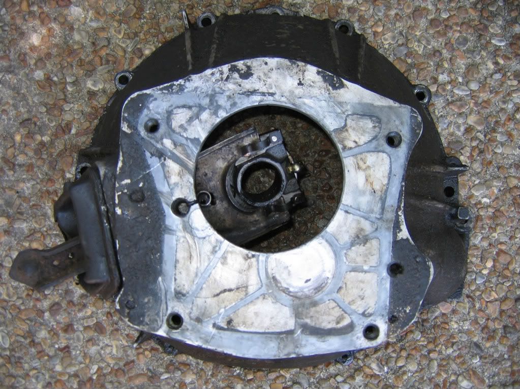

Removed the skid, shifters and tunnel cover and supported the engine underneath the oil pan with a jack stand. Then tried to remove the transfer case but couldn't get it to separate form the trans. Since I didn't have a transmission jack, we used a regular jack underneath. For added safety and support, we looped a ratchet strap under the trans and through the hole in the tunnel, hooking each end to the seat frames on either side. Sorry no pics of this since we were trying to move quickly and not stress the motor mounts any more than necessary. With one person operating the jack underneath and the other in the Jeep pulling up and back on the ratchet strap, we were able to support and back the trans out with the transfer case still connected.
Turns out there was one bolt still holding the two together. I didn't see it since it was in the recessed area near the shift rods. After removing it, they were easy to separate as there was only rtv used in between the two cases.
Removed the starter, clutch linkage and bellhousing.

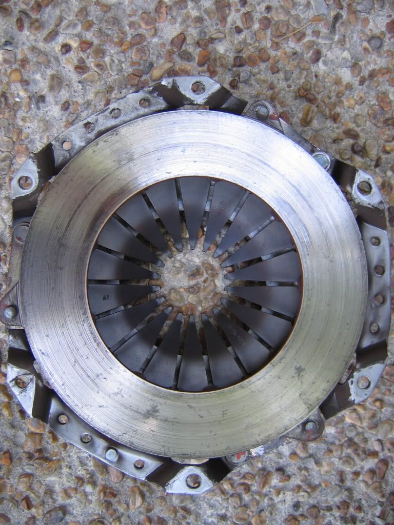

It had so much oil/grease all over it that you would think it was black. Next was the clutch pressure plate/friction disk which turned out to be made by Luk. I'm not an expert on clutches, but they seem to be in pretty good shape from what I can tell. What do you guys think???

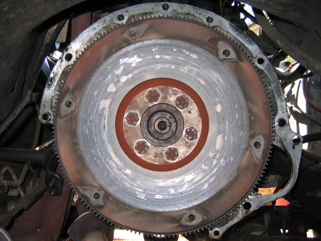

Heres a look at the flywheel. Any opinions???

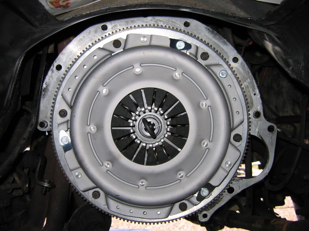

May be a little late to comment but I'd say you should have the flywheel resurfaced and go ahead with a new clutch and pressure plate. The time to do it is when you've got it apart anyway. Kinda late posting though and you may already haver it back together.

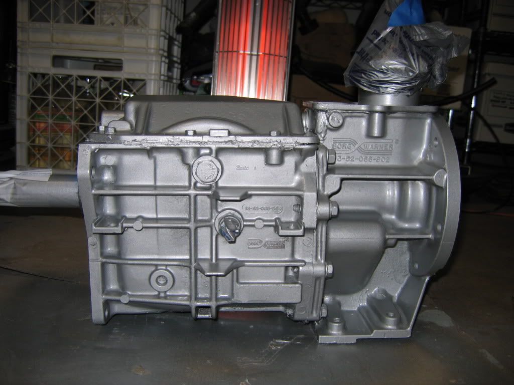

Took me a while but I found a replacement for my T5 last week. I was hoping to get something beefier, but its not in the budget right now. I think the T5 will be fine for what I will use the jeep for at this point. I do want to change the front and rear gears though. I agree about the flywheel/clutch. Right now I'm looking for a place to resurface the flywheel now and need to pick up a clutch kit. Considering buying Timken release bearing and pilot bushing separately. I'm not sure what comes with the clutch kits and have heard of people having issues after getting everything back together.

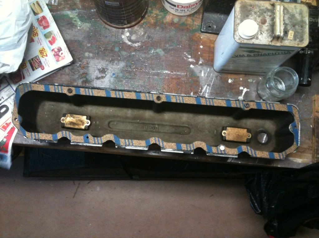

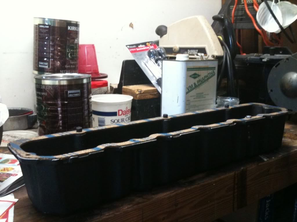

After seeing how filthy the bellhousing was inside and out, I figured one of the causes was likely the valve cover gasket leaking down the back and on to the bellhousing. So after a little trimming to make the new cork gasket fit right, I skim coated the mating surface and buttoned it up.
After that I cleaned up the bottom of the tub by pressure washing, scrubbing and wire wheeling it. Then primed and painted as many areas as I could reach while some things were out of the way. Sorry, forgot to take pics at that stage but you can see a bit of that in others. Next was the removal of the old pilot bushing. The grease hydraulic method did not work for me, so I "rented" the slide hammer tool from AZ and it came right out. Then I went through 2 new bushings to get it right. The first one mushroomed slightly because I used a socket as a driver. Got it all the way in after hammering for what seemed like a lifetime only to have the outside edge layer crumble at the end. That one came out in pieces with the AZ tool. Second one I threw in the freezer overnight and used a light oil along with a wooden dowel. The "hardwood" dowel I got from HD mushroomed on the hammered end and eventually split. Switched to an old oak driver my dad found in the garage and it went in much easier. Turns out the supposed "hardwood" was not very hard and was absorbing too much of the blow from the hammer. After finally finishing the pilot, I put on the spacer, new flywheel, friction disk and pressure plate.

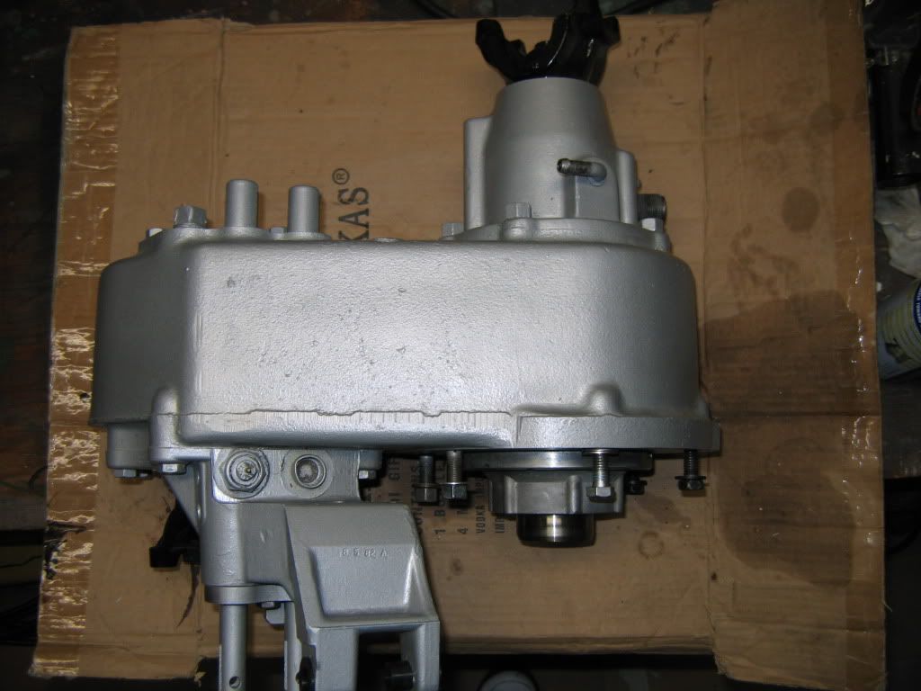

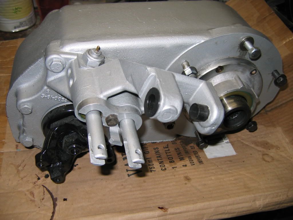

Since then I have spent my time on the new to me T5 and my D300. Opened both of them up and everything looked and felt good, so I replaced the seals on both and painted them up.
