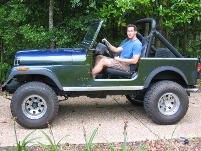

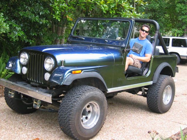

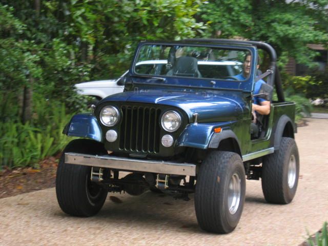

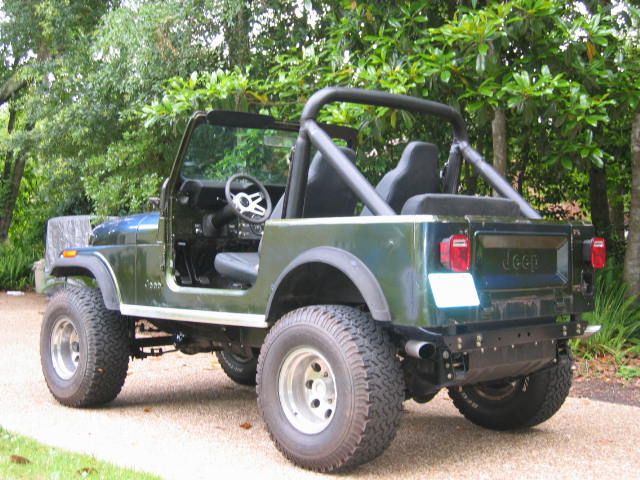

I figured I should update the thread. Not much work has been going on. The most recent thing is shown in this thread:http://www.jeepforum.com/forum/f8/sh...oving-1520281/ Thought I had a cooling issue, which after much testing, turned out to be the just the gauge. That would be next on the list.
Mainly been driving it a few days a week. The wife and I take our dog down to the beach in it almost every weekend. Its been nice enjoying the great weather we've been having with the TOP OFF!!!

Looks great Turtle. You've done a great job. Wish I had one to drive!

You mean we're supposed to drive these things? I thought we all had them to work on. The Jeep is looking great dude! I like those tires you're running. Seems to me for every day driving and some off road they can't be beat. They're great in snow and ice too.
