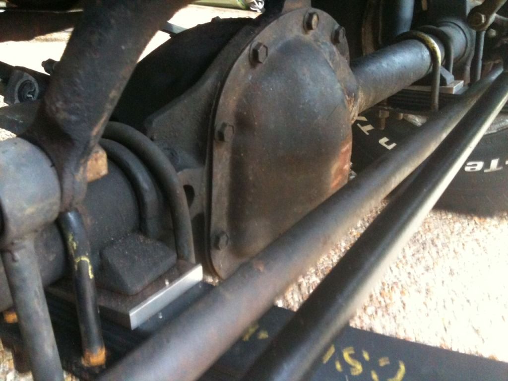

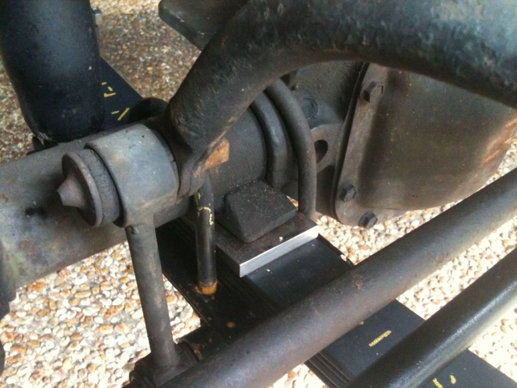

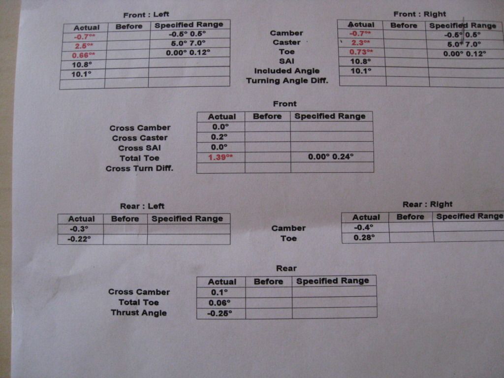

After taking it to an alignment shop, I found the caster was way off.
The caster was showing at 2.5 and 2.3 degrees left and right respectively so I ordered these 4 degree shims.
http://www.amazon.com/Warrior-Produc.../dp/B004JARX70
Fairly simple install. Dropped the spring plates. Clamped the leaf packs from side to side and top to bottom to keep them from coming apart. Then removed the centering pins. Installed the shims and reinstalled the centering pins since they were plenty long enough. Removed the clamps and reinstalled the spring plates.
Much easier to handle now going down the road. I can now drive it with one hand! Still doesnt return to center very well though.
