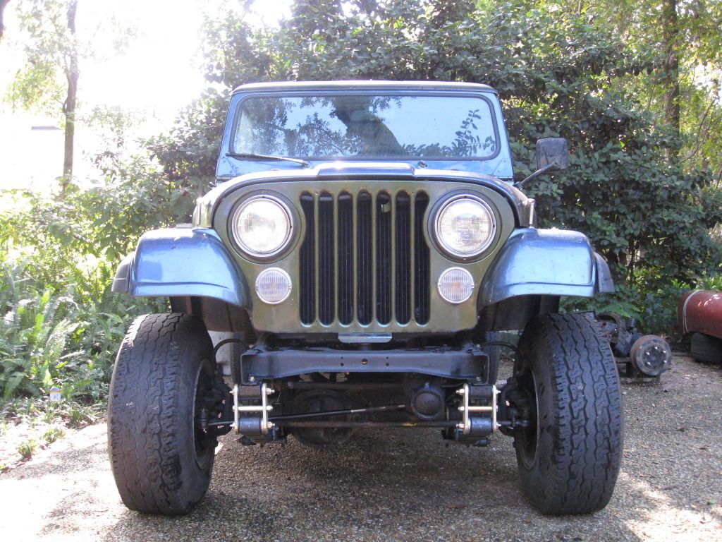

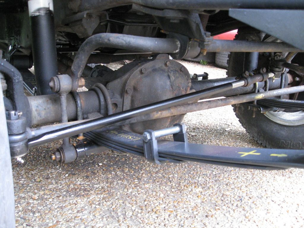

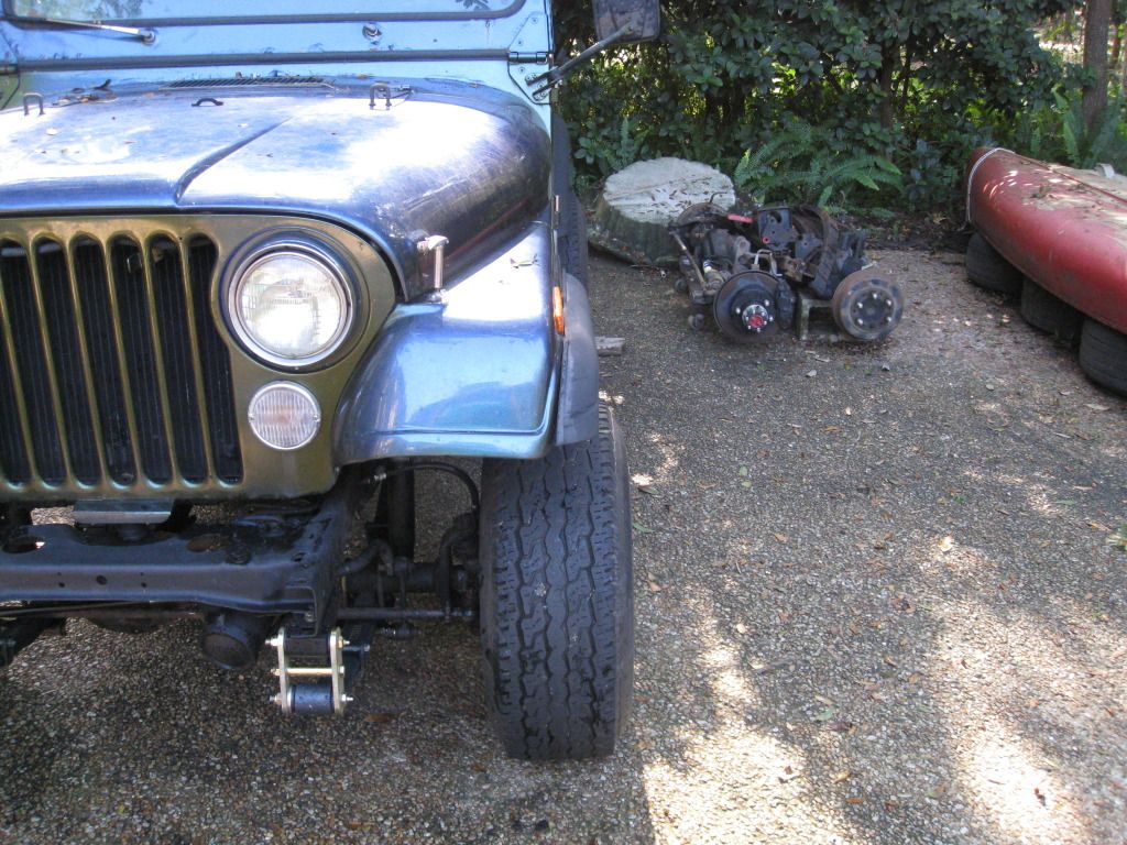

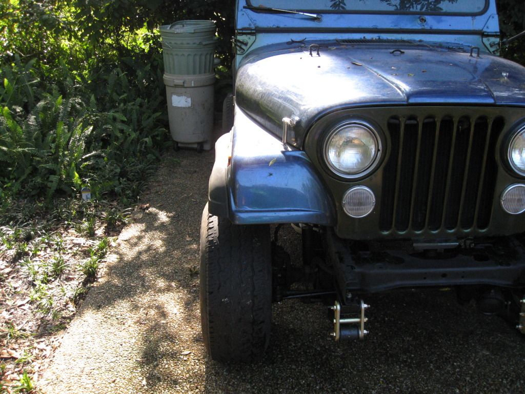

Ok. Here are some pics I took today to show how it looks now. Actually looks pretty straight.
Whats funny is, I took front and back measurements of the front tires and if they are accurate, it is actually towed in 3/4 of an inch now. It is supposed to be 1/8 to 1/4" from what I have found. I neglected to take before measurements since it definitely looked out.
All I can figure is, I may have been thrown off visually by the uneven tire wear that occured before I bought it and replaced the extremely worn wheel bearings.
