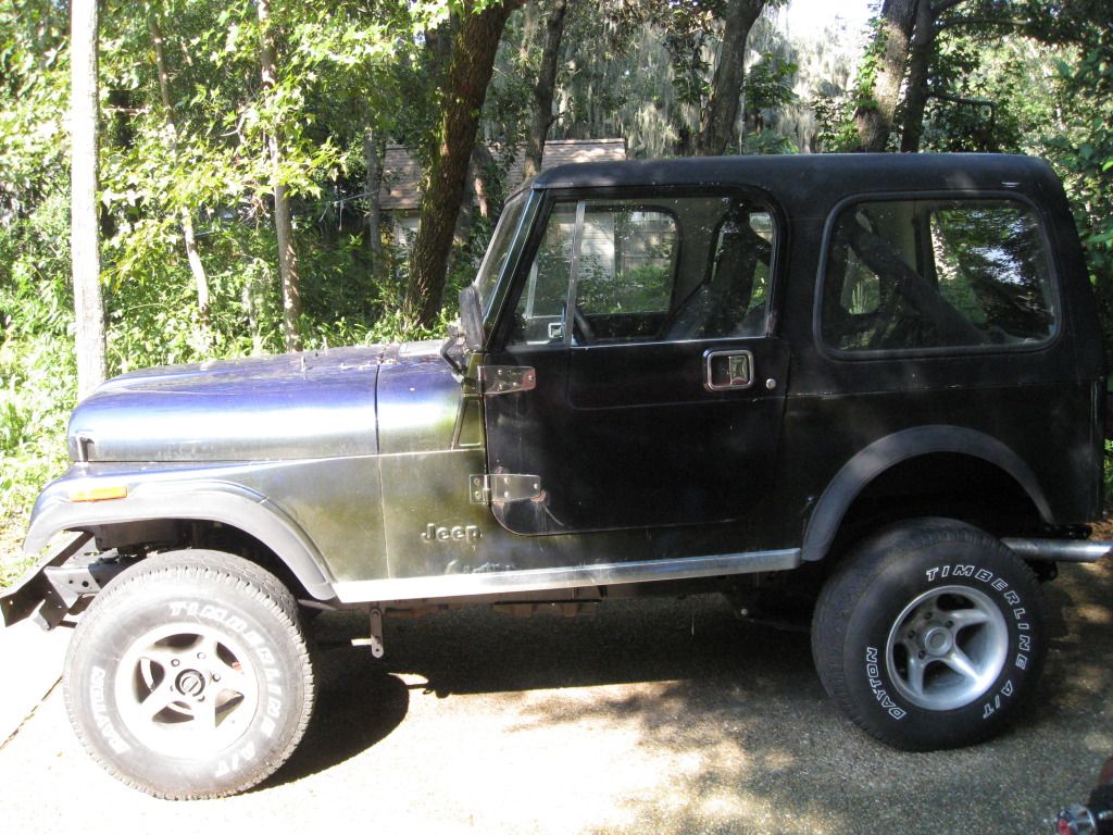

After many delays I've slowly been making progress on the suspension. Figured I would need to install the new leafs before correcting what may be a caster problem since the steering wheel does not return to center.
So I bit the bullet and ordered up some Old Man Emu leafs. Took advantage of the Quadratec's free shipping offer for forum members.

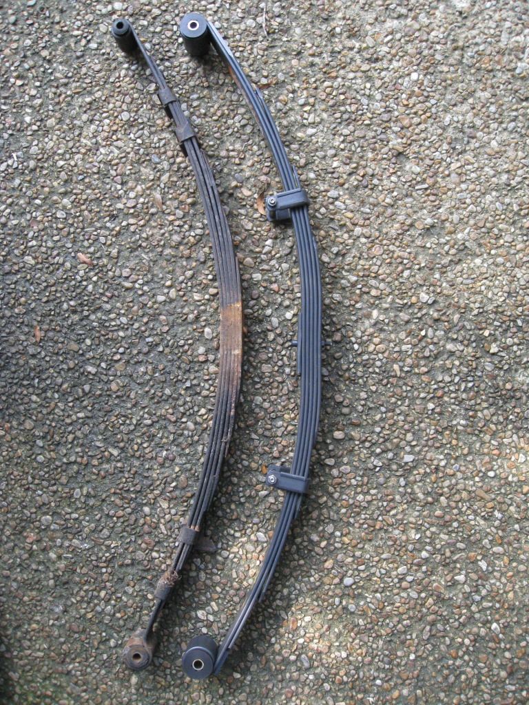

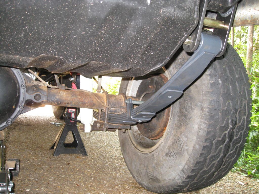

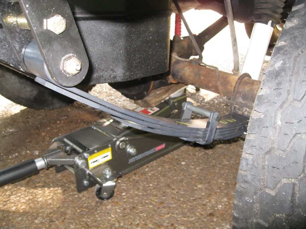

Started with the rears. Install was fairly pain free since I had been PB blasting the necessary areas for a while now. Just put it up on jackstands and used my impact wrench to remove most of the nut and bolts to drop the old leafs and install the new ones.
Old leaf and new leaf:

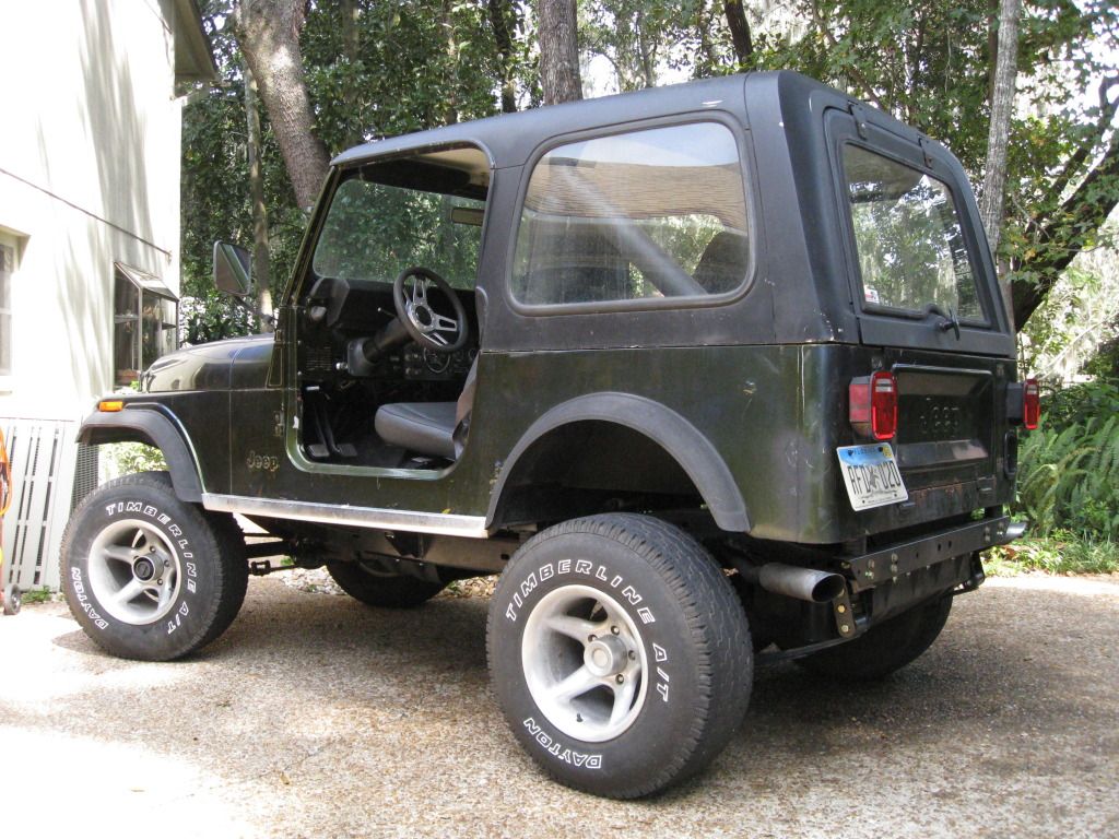

Here is how it sits with just the rears done.

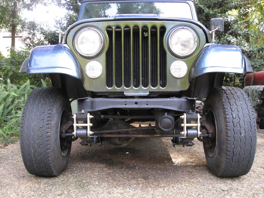

Front spring hangers/crossmember thingy.
All nuts/bolts came out pretty easily....except for one bolt that started to turn but then snapped. After wearing out my shoulder trying to drill it out I remembered an idea out of a thread I saw. I believe it was ErikEastman's......the "redneck drill press". Worked good! Then tapped it.

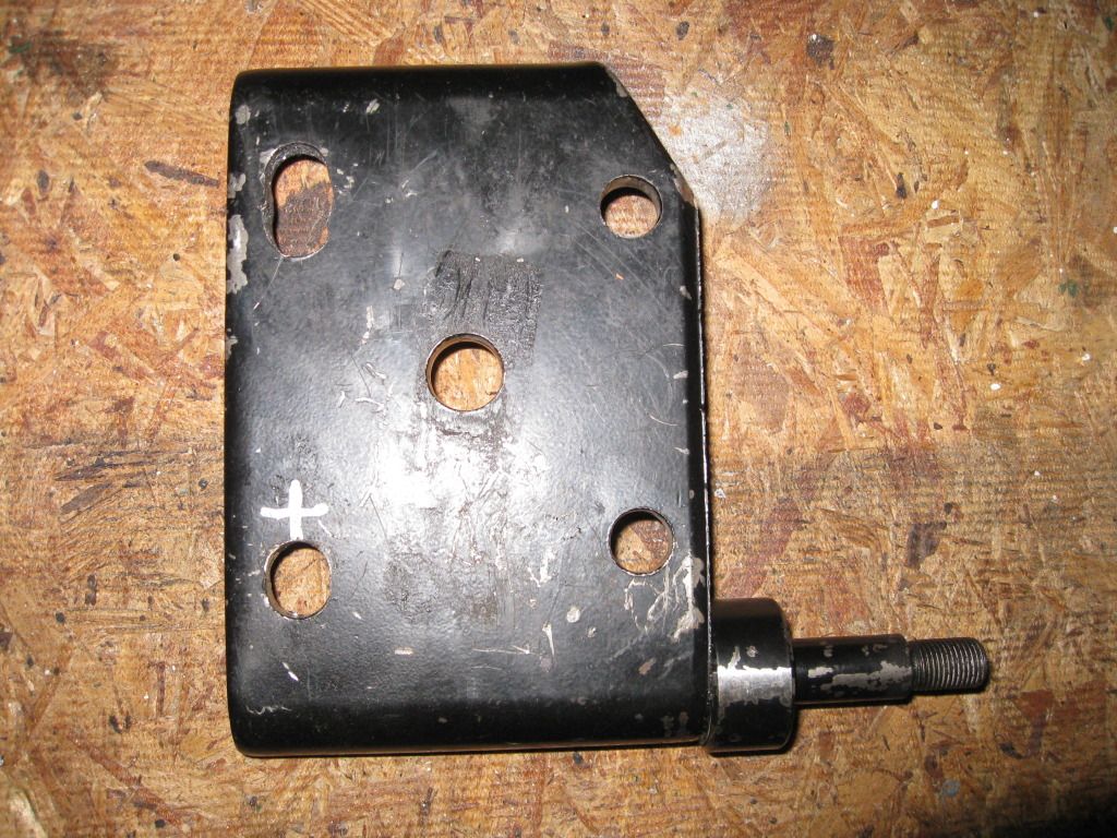

Next was the removal of the shackle hangers.
It now awaits the install of Jim Crabtree's stout shackle hangers.

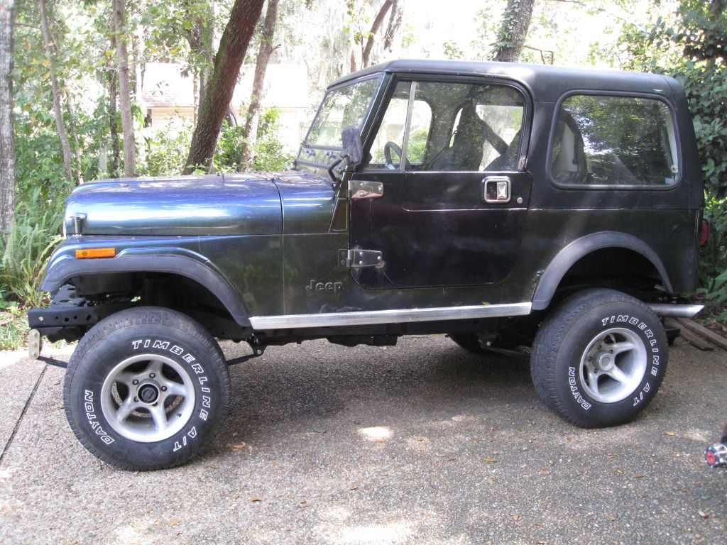

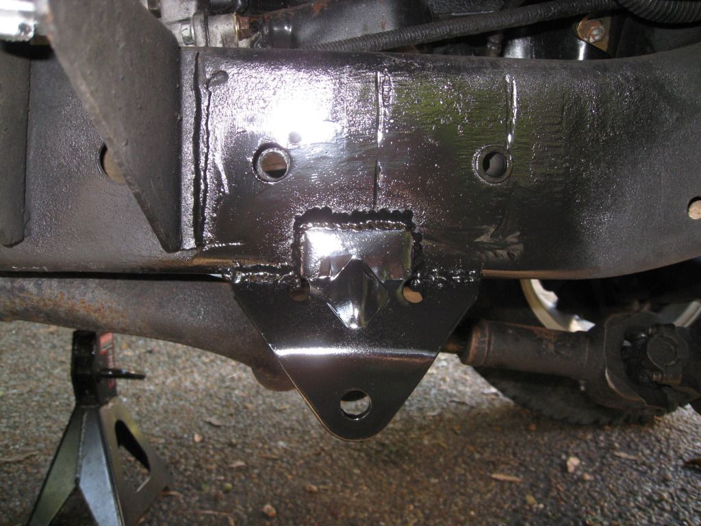

More progress....installed Crabtree Shackle hanger and shackles. I cant say enough about these things. Heavy duty, quality and ease of install. Not to mention Jim's customer service is second to none!
Got the main eye hangers welded on.
Used YJ spring plates to fit the new wider leafs. Just had to elongate the rear inner hole on the drivers side so the ubolt would fit properly.
Then installed the front leafs.

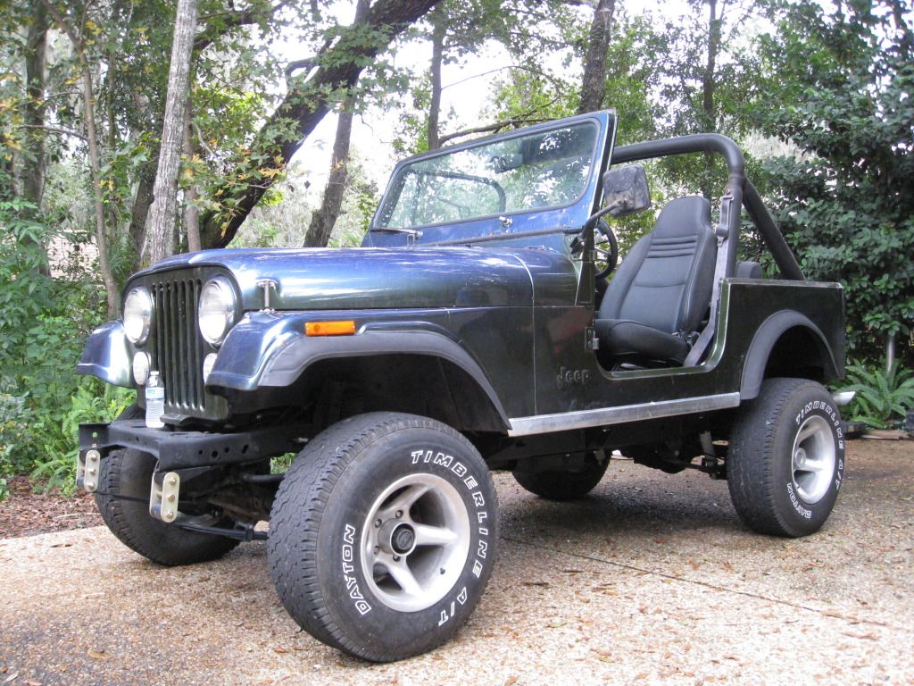

Here is how it sits now.

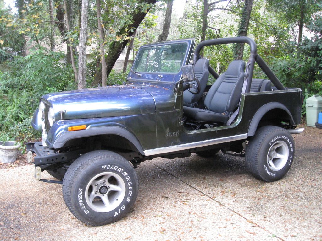

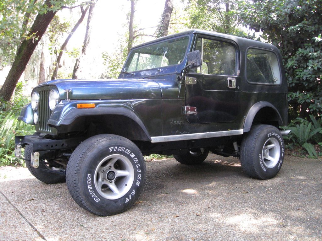

From checking the before and after measurements, it is now a full 2.5" higher from the suspension lift alone, and 3.5 including the 1" the body lift. Very pleased with the ride as well.

Thanks MoC. Now I need some new and bigger tires!
I sold the top that came with it yesterday since I had another one in slightly better condition. This is the first time I have seen it with the top off!
Can't wait to drive it on a regular basis!
