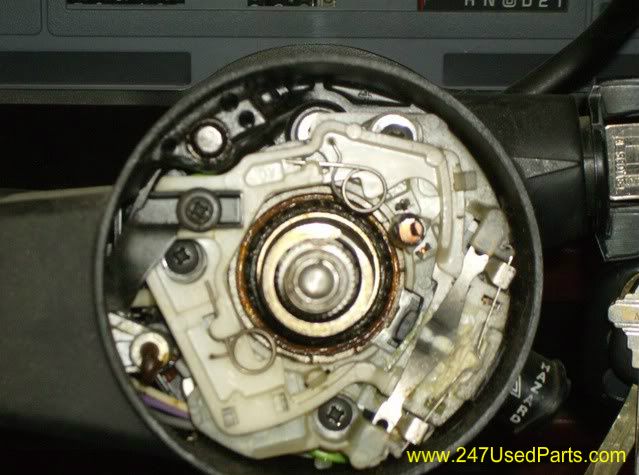

I have a 1986 Jeep CJ7. I had to replace my turn signal piece in the steering column with a turn signal rebuild kit. Now when I put the turn signal to go left and I turn left it works fine. But when I correct the wheel the left turn signal does not turn off. Same with the right indicator. Any suggestions or pictures as to where I need to check?

I would take it back a part and make sure that the springs are seated correctly in the turn signal plastic switch thingy. the springs tell it to snap back to its original position. They should look kinda like this, they are the circular shiny things in the pic.

It'a a cam on a plastic thing-a-ma-bob that pushes against the spring doo-hickey that makes it turn off when you turn the wheel.
You can see the two little bumps on the underside of horn contact ring. Did you remember to put it back in? :

I will take it apart this afternoon. How does the plastic thing-a-ma-bob supposed to be inserted into the column. meaning its placement. where does the flat outer edge supposed to rest in the column. any pics?

Right here. Probably the first thing you put in after the turn signal switch

In Jeeps as old as ours the turn signal cancel cam in the steering column probably has a groove worn so deep it doesn't work any more or it may work in one direction but not the other.
I had to buy a new cancel cam at Autozone.

Is there supposed to be a spring underneath the turn signal cancel cam?
