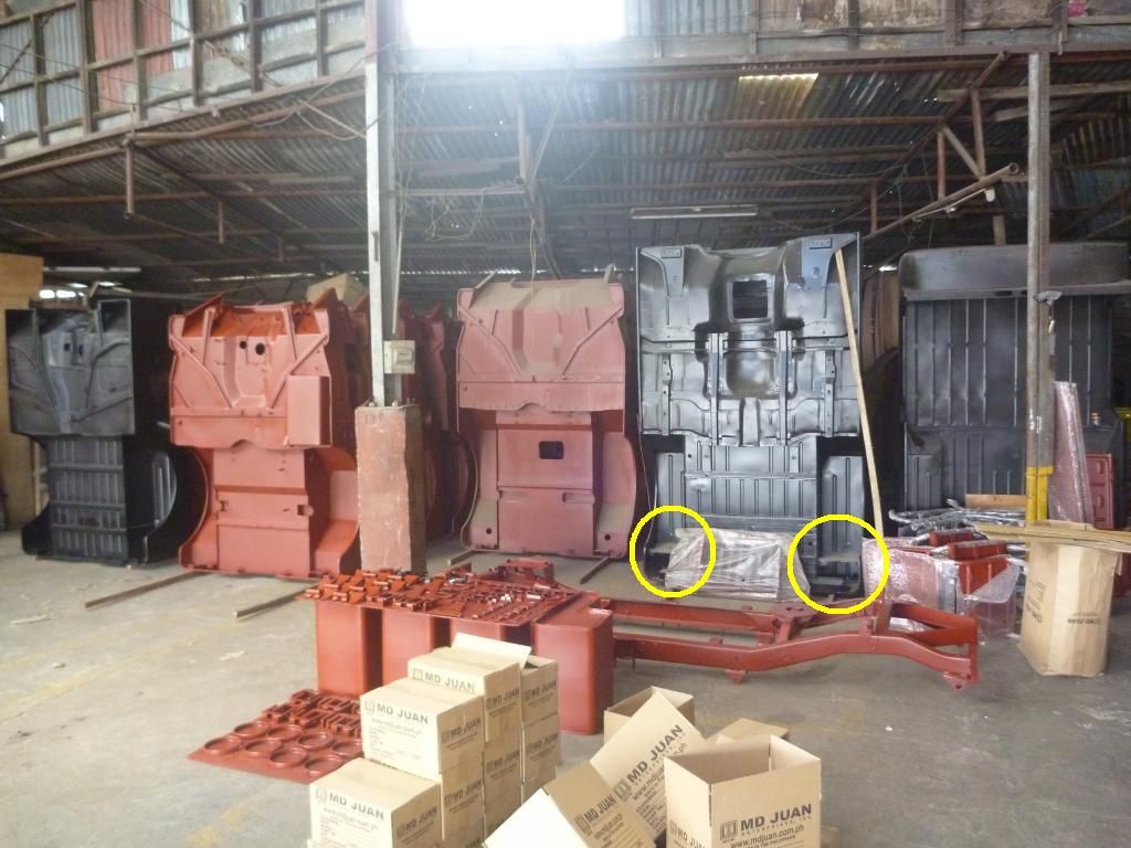

It will be very important to note, however, that the CJ7 encountered other changes that making a blanket tub to cover 1976-86 leaves us to have to make many modifications to fit.
1976-early '79 had the roll bar mounted to the sides of the tub, 1980 intro of the Dana 300 and light duty trannies brought the need for a larger transmission tunnel hole to cover the options of SR-4, T-4 and T-5 extended length transmissions, 1981 introduced the "B" pillar behind the door, the mid-'79-on roll bar mounted to the floor in front and wheelhouse in rear makes the rear wheelhouse baffles absolutely necessary (see my yellow circles from pictures). 1976-1977 had the smaller hole in the cowl for the heater system.

Originally Posted by BlkCJ7Laredo View Post
Just for clarification I have circled the baffles in yellow so you know what I'm talking about. It also appears that the wheelhouse ribs are properly stopped before and after the baffle as the OEM tub was. As I said, mine and Keith's tubs aren't this way and really need to be to attach the roll bar properly.
Is this the part you encircled in the picture?
There should probably be three versions of CJ-7 tub:
CJ7 Early A: 1976-1977 due to the smaller cowl hole size
CJ7 Early B: 1978-1980 due to larger cowl hole but no B-pillar
CJ7 Late: 1981-1986 due to B pillar, enlarged transmission tunnel hole
Can anyone confirm when the indentations were added to the sides of the cowl below where the windshield hinges connect?
All good points and accurate and I'm almost 99% sure the indentations were added beginning on late 1979 or early 1980 model year.

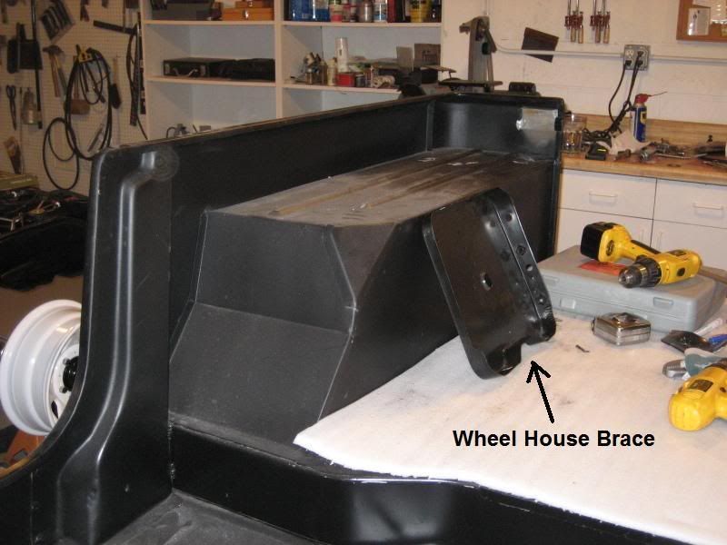

No, the part that is missing is for supporting the Wheel House.
Wheel House Brace taken out of a "cheap" Taiwan made Wheel House.
Added to the Repli-Tubs by means of spot welding into place.
