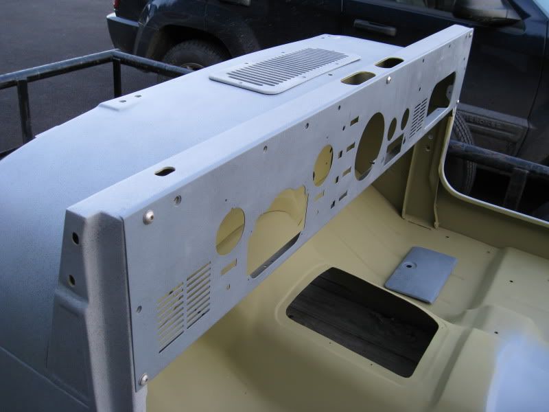

Keith, did you need to enlarge or relocate the holes for the windshield hinges in the tub? On my repli-tub i can't get the top of the hinges flush with the cowl. They are about 1/4 too high which results in a gap between the seal and the cowl.
Yes I did. Had to slightly elongate the holes in the Repli-tub to get the hinges lower to match that of the OEM tub I still had on hand. Just another peeve on the Repli-tubs that needed to be done.
Once they were filed and the upper hinges mounted, I used a 3/8" threaded rod as a jig to setup the bottom hinges. Factory settings are 12-3/4" spacing between the hinges center-to-center measurement. The threaded rod will align the bottom hinge pin hole with the upper hinge pin hole and use nuts to lock it into place while mounting the bottom hinge to the body. I saw them use a similar jig at the Jeep Toledo Ohio plant back in 1980 when I did a factory tour of the assembly line. I remember things like that but of course their jig was much more elaborate.
You can see them slightly elongated in the pictures below

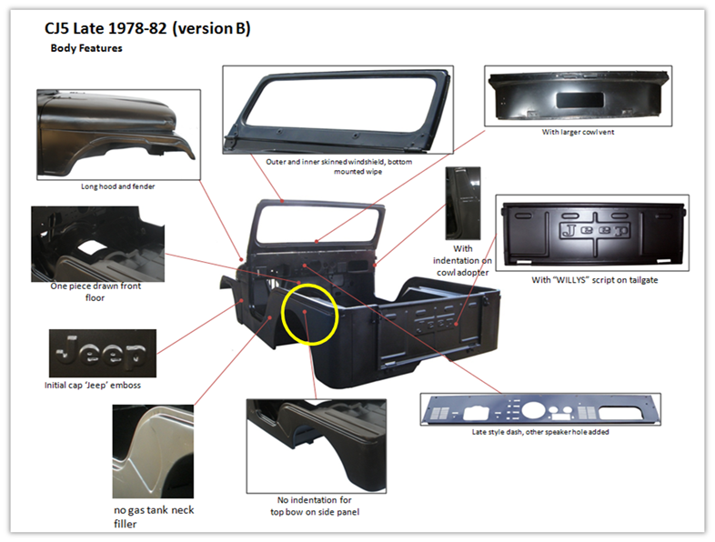

Below are product features of our '78-'82 reproduction. There's no indentation for top bow mount.
Although we can do a no tailgate version for this, it is better if offer you the with tailgate version, and offer the tailgate chain later.

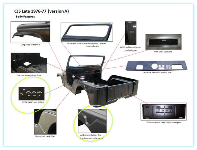

Posts: 3,241
Rommel, I just figured out that the Early Versions are pre-1976, because of the front floor; is there a "Body Tub CJ-5" that has the indentation, like the 1976-77 had, and also has the Jeep script?
Fred
Retired Army Guy
High Plains Drifter
1976 CJ-5
Lime Green
Black Wellington Vinyl Bench Seats
258 I-6 1bbl
T-150 3-Speed
3.54:1 Open Gears
FLynes is offline
post #626 of 795 Old 01-07-2014, 07:10 PM Thread Starter
RommelJuan
1980 CJ7
Join Date: Feb 2013
Location: Paranaque
Posts: 220
Yes, there is a 1976-77 CJ5 Body Tub that came with a initial caps "Jeep" script. Please see the illustration below:

Hi Rommel,
Thanks for posting the diagram. I take it then that you can do a tub with no tailgate if needed but generally don't make them or stock them regularly? You mention offering the tailgate chain later, I'm not sure what you mean. They don't come with the tub?
