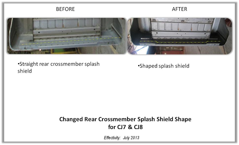

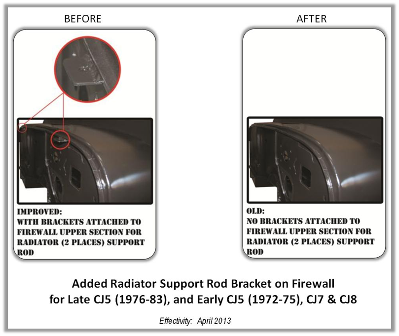

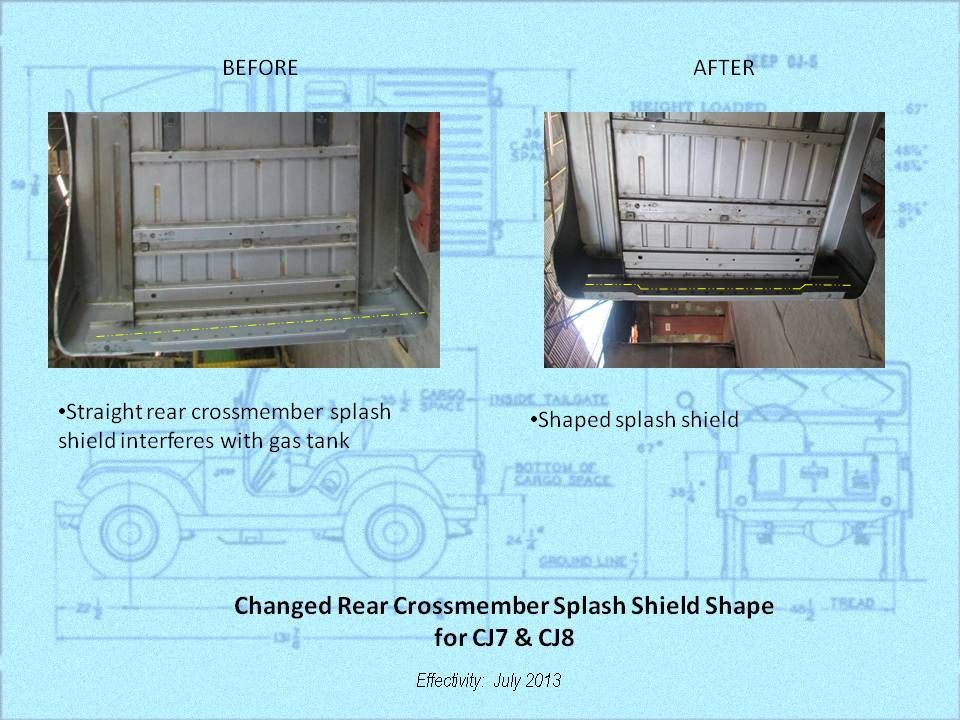

you got it Keith!
anyway here are the things we've corrected with our tubs.

Originally Posted by RommelJuan View Post
you got it Keith!
That part looks ok, but what about the wheelhouses and the baffles in the wheelhouses? Also has the angled square hole for the throttle cable been added?

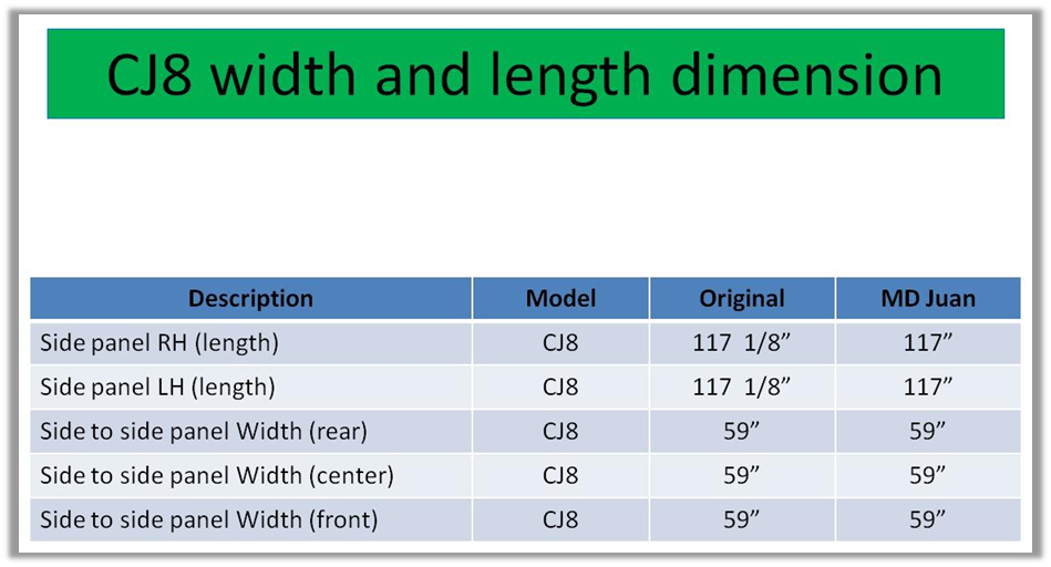

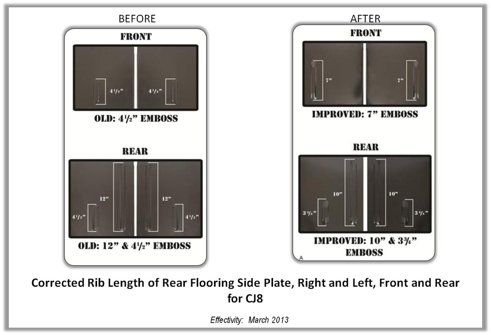

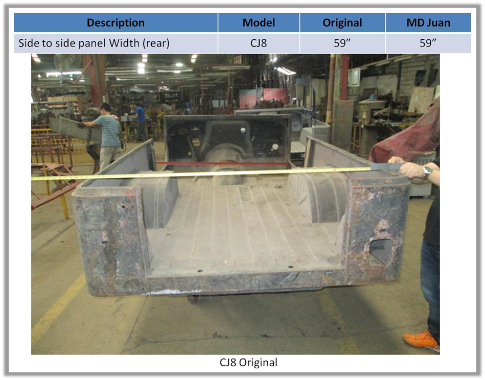

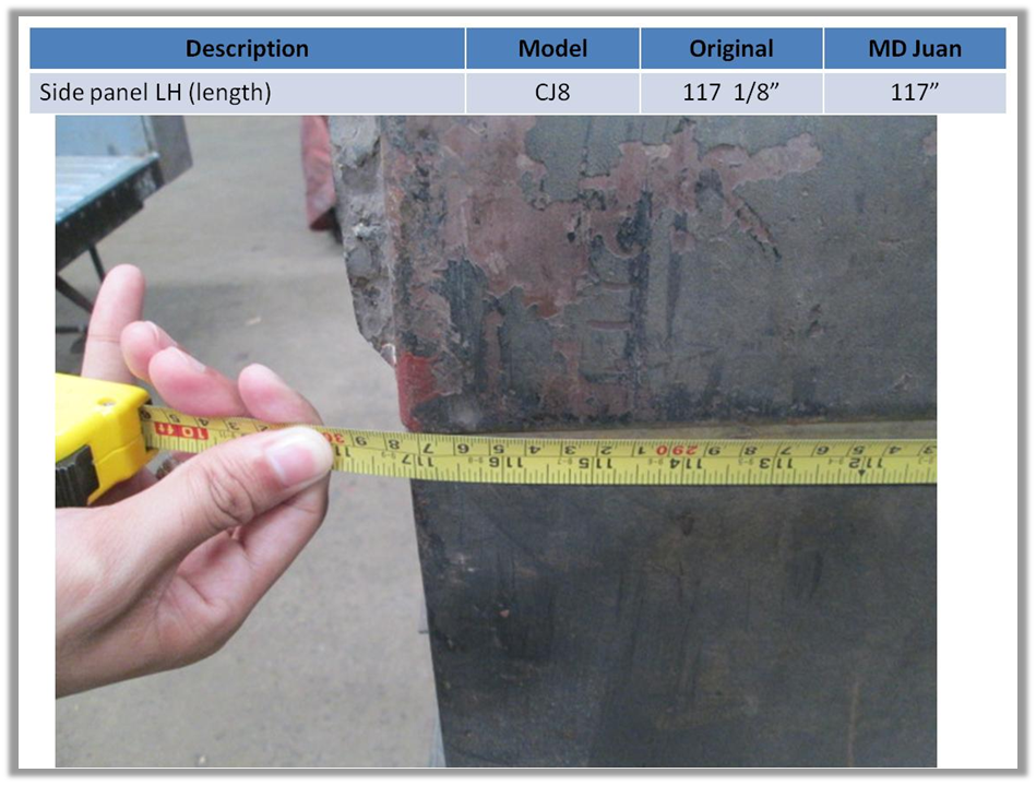

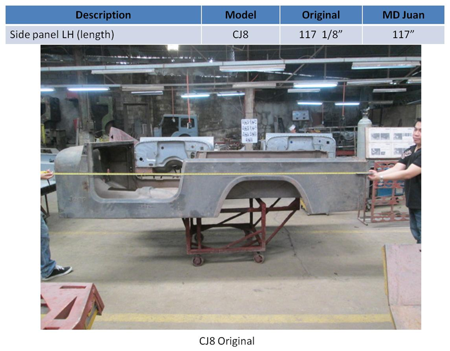

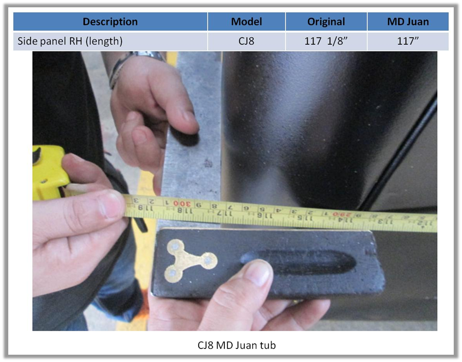

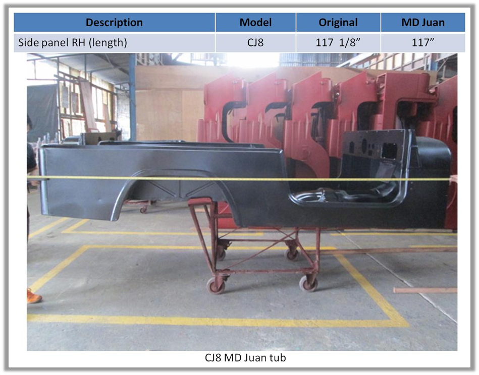

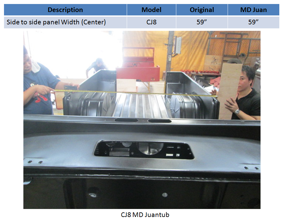

The following are the improvements we've made so far for CJ8 as well as the pictures of our tub showing the length against the original. Our present production is 1/8" short. We our now fixing our main assembly jig to ensure the correct length of every tub produced.

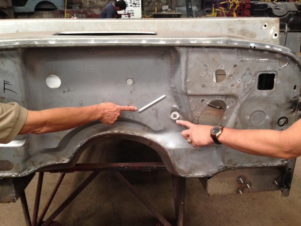

we made new holes and indents on our firewalls!

Looks great Rommel!!! The angled throttle cable hole would have been something very difficult to add in the field on an already built tub. Holes are easy to drill or cut but stamping the sheetmetal and reshaping it is rather difficult without specialized equipment.

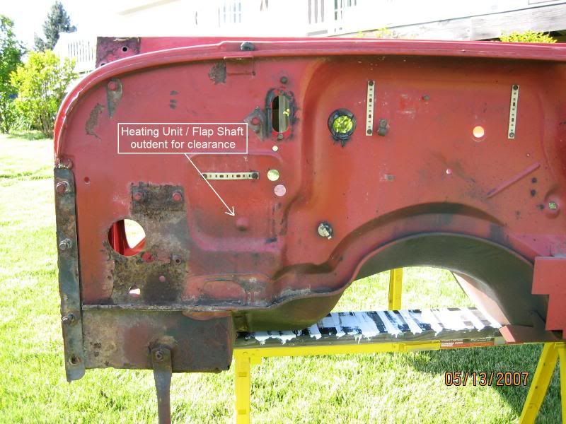

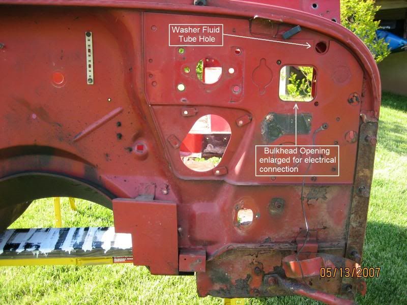

Looks great and I might point out that you still need to add another indent/outdent for clearance of one of the heating units flap pivot shaft.
How about the hole for the washer fluid hose? Adding that in?
The electrical bulk head connector is also too small for the later model CJ's as well. The square opening needs to be enlarged to almost the same size as the steel overlay or reinforcement plate.
Your making headway though, and glad to see the improvements.
