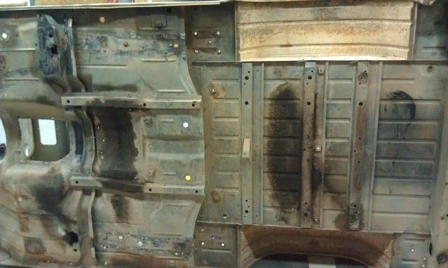

sevensandeights
Location: Erie
Posts: 73
Aluminum is tempting!
I bought my Scrambler in Columbus, OH. It used to be a desert tour vehicle and the 2 forward most body mounts were completely toast! No rot or rust, just major cracking/bending. The PO tried a ghetto booger weld repair. I have already drilled all the spot welds and plan to get new pieces from Classic. There are several other small cracks and holes that need filled and the floor boards probably should be replaced (again - no rot just some thin metal and cracks). I have looked at the one piece floor assembly that is sold all over online but not many people have used this product and those that did had some fitment issues.

VooDoo2
1978 CJ7
Location: Brisbane
Posts: 692
That Tub is MINT. I just wish i had started with something that good
