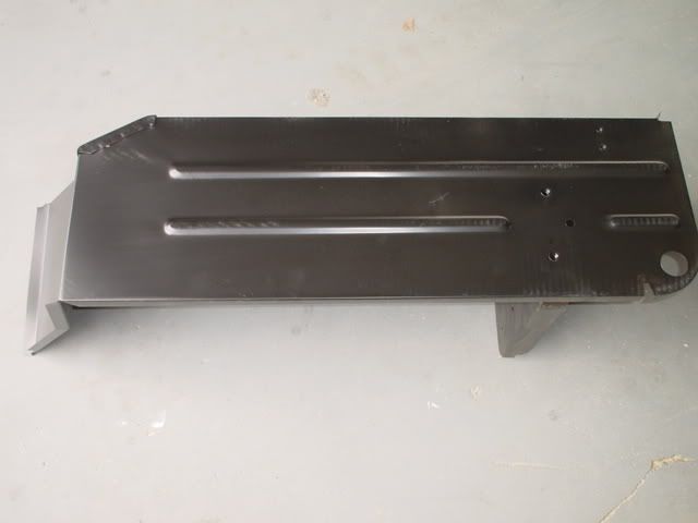

How about the Wheelhouse modification on top where the roll bar mounts? Still using the Wheelhouse from 1976-79 tubs with the bead ridges full length or 1980-86 Wheel house with the correct bead ridge that has an interruption for mounting the later factory roll bar on top of the Wheelhouse as pictured below?
How about the hole for the electrical wiring harness on the drivers side back corner?

Hey Keith,
Can we use the YJ Wheelhouse as reference? This is the sample that we have. If this is correct we will revise our dies to adapt to this change.

Hi Rommel,
The YJ wheelhouse is the same as the CJ7 wheelhouse for Mid-1979-1986. The fold and tumble seat hold down bracket holes are the same also. The only difference would be the spare tire reinforcement bracket holes that are located on the passenger side wheelhouse on the bottom near the tailgate opening.

Yes Rommel, as BlkCJ7Laredo has pointed out, the wheelhouse for the YJ is the same as the later 1980-86 CJ's.
I wouldn't add the fold & tumble seat mounting bracket as many Jeep CJ's did not have them until the 1985 model year. That can be added by the owner if they wish. And besides, aftermarket rear seats do not attach to the wheelhouse anchoring point unless you have an older Bestop brand rear seat.
The only items I would add are the wire loom hole on the drivers side and tailgate cable brackets for both sides.
I'm out on a limb for the condensation drain hole on each wheelhouse for the roll bar seep hole when mounted. That is where rust usually starts but if one were to paint the tub and roll bar separately, should be OK.

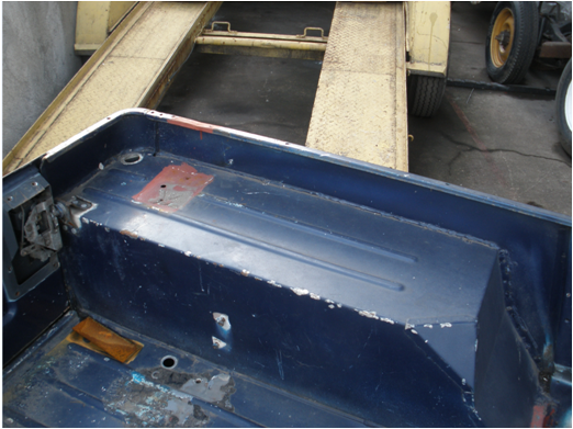

Yes they do. It must be a Jeep thing. Another place that these dimples could be placed are for the 16 floor drain holes. Then those who want them can put them there with a 1" hole saw and the rest of those who don't want them can leave them undrilled.

16?
Are their really that many?

Originally Posted by keith460 View Post
16?
Actually I stand corrected Keith. There are 17 by looking at pictures of that 6,000 mile CJ that a forum member here sold to Collins Bros. It may vary by year. My '89 YJ tub only has 13 drain holes.

17 holes huh? any chance you can show them to us?
Sure thing Rommel, There's definitely 17 on the later CJ tubs. The pictures of the stripped out blue CJ below are a 1982 model.
