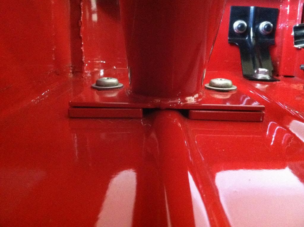

The 'B' Pillar is the vertical support structure where the door latch and seat belt anchoring would mount to. Of course mine was completely rotted away at the bottom. The threaded hole needs to be 7/16-20 for the seat belt anchor and not 3/8-18 like you make them.
Roll Bar mounting after 1979 (1980-86) changed from mounting to the sides of the tub wall to the top of the wheelhouse like your YJ sample tub. That was another modification that had to be done for your tub in order to fit my 1984 Roll Bar. Support baffles had to be installed and shim plates had to be made in order to fit and mount the Roll Bar over the 'bead' ridge in the wheel house.

Spon on Keith! That's exactly what I was looking to describe. Also the support baffle under the roll bar mount in the rear wheelwell.
