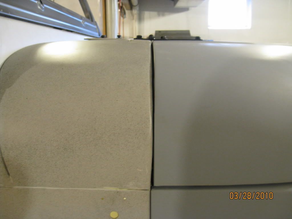

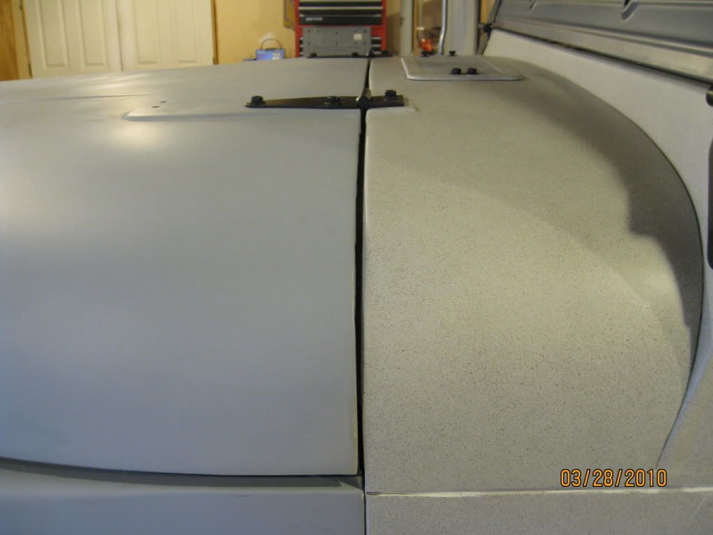

Cowl section of the Repli-Tub where the front edge is suppose to match the contours of the OEM Jeep hood is without a doubt one of the worst features that is an eyesore to look at.
The wavy line of the Repli-Tub, which I think is hand formed on a block of wood or something, compared to the straight crisp line of the OEM hood.

Pictures posted of the mismatch of the OEM Hood-to-Cowl section.

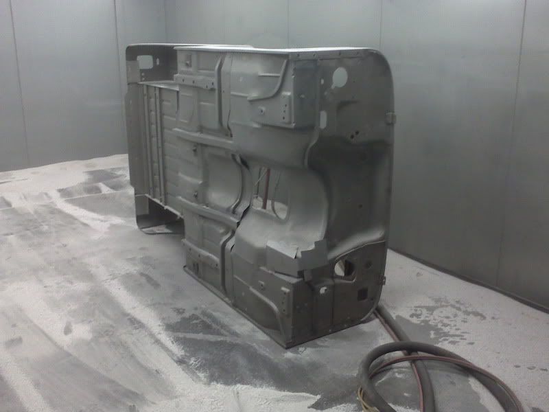

I would not trust that so called E-coating because it is NOT. It is merely a cheap primer that is used to protect the body from salt water contamination from shipment across the great Pacific Ocean to here. It easily came off with a blow gun and plastic media blasting. E-coating is an expensive process and one must have special equipment and chemicals to apply. E-coating does not come off so easily even with sandblasting. I would compare it to good powder coating which is also difficult to remove.
Took the media blaster about 15min to remove every trace of the black primer applied by MD Juan Company. Came off very easy and if you failed to remove it, you are going to have your finish coat coming of in big chunks of paint peelings.
