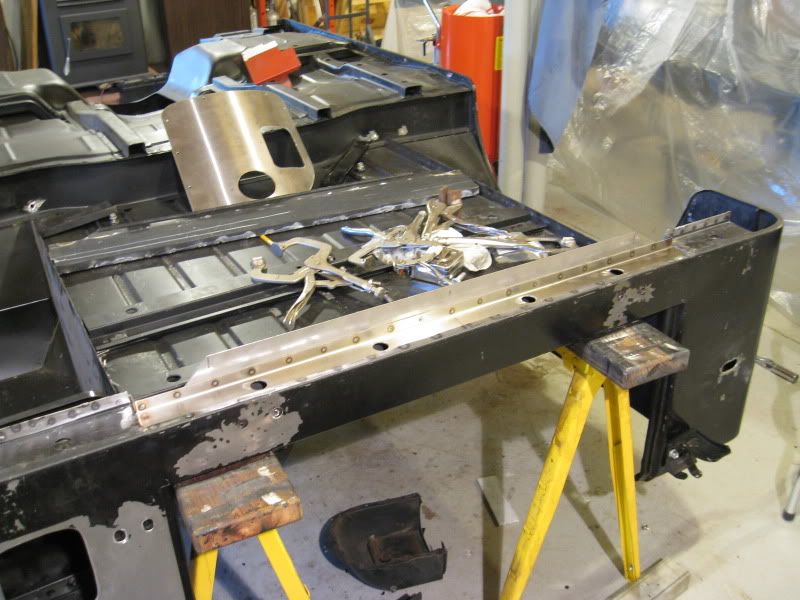

I am so excited for this announcement.
I am glad to announce that because of this thread, and Keith's pictures (Keith you are a godsend):
We are now implementing the correct rear splash pan/tailgate support or as we call it the rear crossmember.
Our old one was straight and did not have a depression to make way for the gas tank.
check out this old and new picture:
and check out our new implemented change side by side with the original.:
Guys, Again I thank you for all your help. And as promised I will implement all the changes and corrections that you will share with me and the rest of the Jeep community in this forum!!

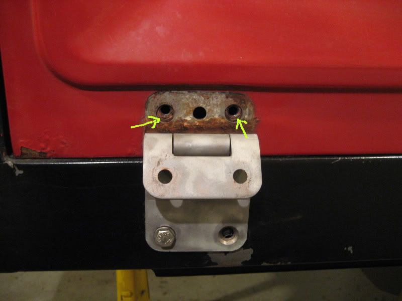

That's great news for the CJ-5,7 and 8 rear crossmember! That was a PITA to change out at the time.
How about the captive nuts housed inside that panel that are used for mounting the tailgate hinges? You make them a 3/8-16 threaded, which is incorrect, where they should be 5/16-18 thread.
I had to drill them out and tap for a threaded insert to accept the 5/16-18 Flathead Torx Screw which is the most common size thread for anything bolted to the body like windshield frame, steel doors and tailgate.

Hi Keith I'll get right on this.
