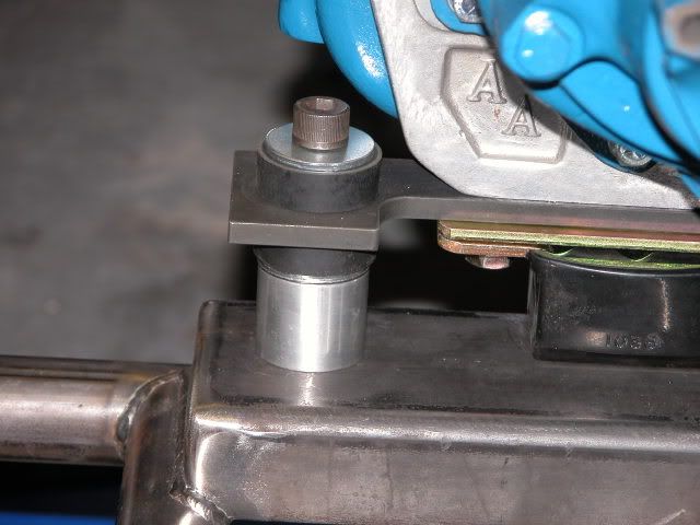

That would defeat the whole purpose of the torque arm. Here's a pic of my install:

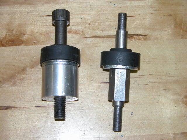

Note: This is a custom (Hack Fab/Diablo Machine - Father/Son) stud, which is about 1/2" longer than the OEM. The problem I had was the Energy Suspension trans mount is 'taller' than the OEM rubber mount. A call to ES 'tech support' was of little help: 'its the same'. Right...
Originally Posted by wmsthree View Post
The problem is there's 1/2 inch between the top of the top bushing and the top washer, so the bushings are sliding up and down. Not cool. Anyone else run into this problem?
Add more washers to the bottom. Or go with the 'Diablo Design' alternative:

Not that I'm aware of. The one in my build was machined from hex stock.
