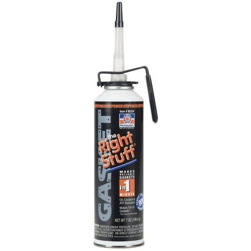

Ditto.
Also, I did redo the gasket on my inspection plate and that started leaking also. Forget the gasket and use this stuff instead... worked great for me.
