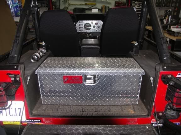

Tuffy sells this one. It fits nice. IIRC it uses the same mounting bolts as the rear seat.
Beat it to fit, paint it to match!
Wheel, Wrench, Repeat.

When I had my first CJ5 Jeep years ago (no tailgate) the rear tire mount was cracking the sheet metal at the welds of the back panel. So I drew up some plans and a local HVAC company welded me up a tool box that I drilled and bolted in place of the rear seat. Then I bolted the spare tire mount through the sheet metal to the back of that locker box eliminating the stress and it made for one heckofa bass box for my stereo. This was one of the first things I did when I picked up 'Black Betty' in more recent years and it only cost me only $50 clams

After looking, reading, thinking of building a bix, at a local feed store I found a lockable BetterBilt tool box 32"x12"x12". It's just a little small lengthwise to hit the outside seat bolt holes but I decided to mount it on 3 pieces of 1/4x2 extended out to capture the bolts. Set up so I can turn it around if wanted. Secure, lockable, waterproof, thick gauge and only $110 for everything.

Got mine from a place called agrisupply.com. Not Jeep specific but the prices are right.

I have had one of the big Tuffy boxes in my TJ since '99 and love it, but no back seat of course. It will be moved to the CJ shortly.
