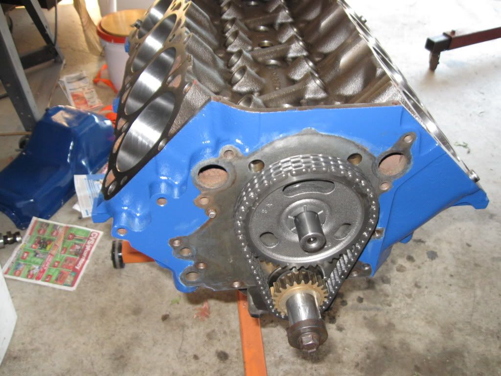

I just noticed there are 2 holes in the front of the block that do not have plugs in them. They are shown in this picture directly above the upper timing gear sprocket. I'm pretty sure there where cup plugs in there when I disassembled, looks like stake marks around the holes. I'm having trouble figuring out their purpose, and the purpose of plugging them, they go from the inside of the timing cover to inside the lifter valley. I don't see where plugging them or not plugging them would make a difference either way, can anyone help me out here?

the only 2 holes that get the screw in plugs are behind the cam gear the 2 top holes are for drain back of the oil and you can se on my block I droped the holes down to the lifter gally floor to help keep it from laying in there
