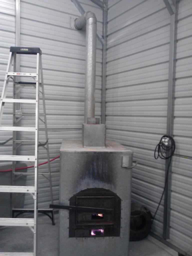

The office is almost completely wired and waiting on interior sheathing on the walls and ceiling. My Dad gave me an old wood stove that was in our house when I was a kid. I got it in the shop and burning. He also gave me a Ford 9 inch that was in a '63 pickup that's was used on the farm as long as I can remember. The truck was scrapped but saved the axle. I don't know much about these axles, but I'm hoping its got 4.10 gears in it coming out of a truck. I hope to use this axle and a Dana 44 front one day to swap axles and go SOA. The current rough country lift is sagging and needs to be replaced eventually. Hopefully this will be one of the first projects in the new shop.

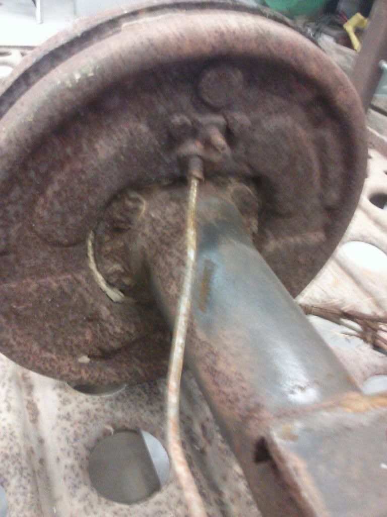

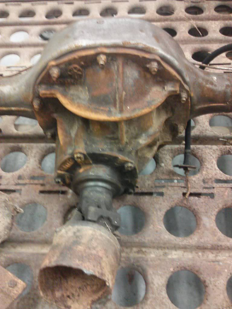

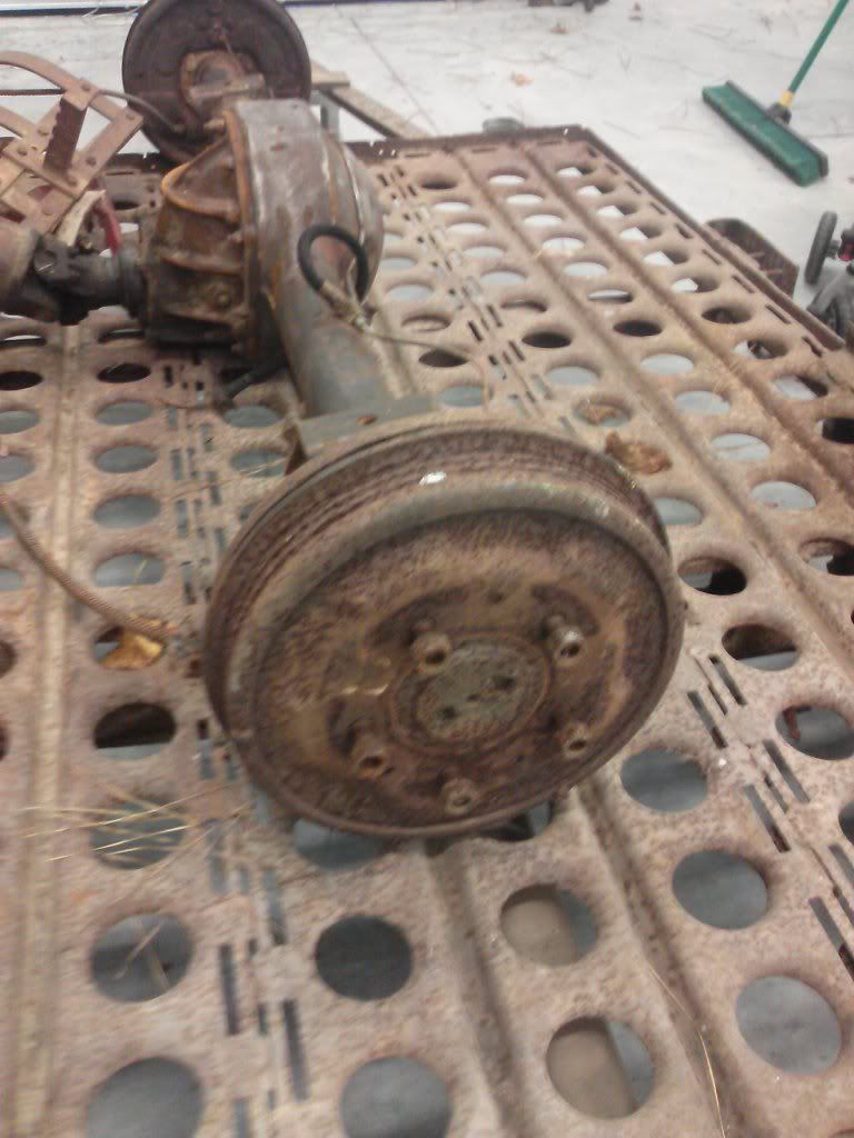

I did some reading and tore into the 9 inch. I found out a few things. It currently has a wms-wms measurement of around 62" inches. It has 3.25:1 gears, open carrier, and 28 spline shafts that can not be shortened and resplined. It is a big bearing version, but has the old style bolt pattern on the housing ends. So to use this axle I'll need new gears, a locker which I haven't choosen yet, new shafts and shorten the housing with new housing ends. I have too many projects and not enough funds for them.

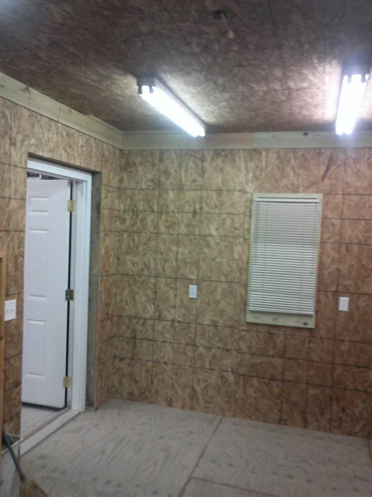

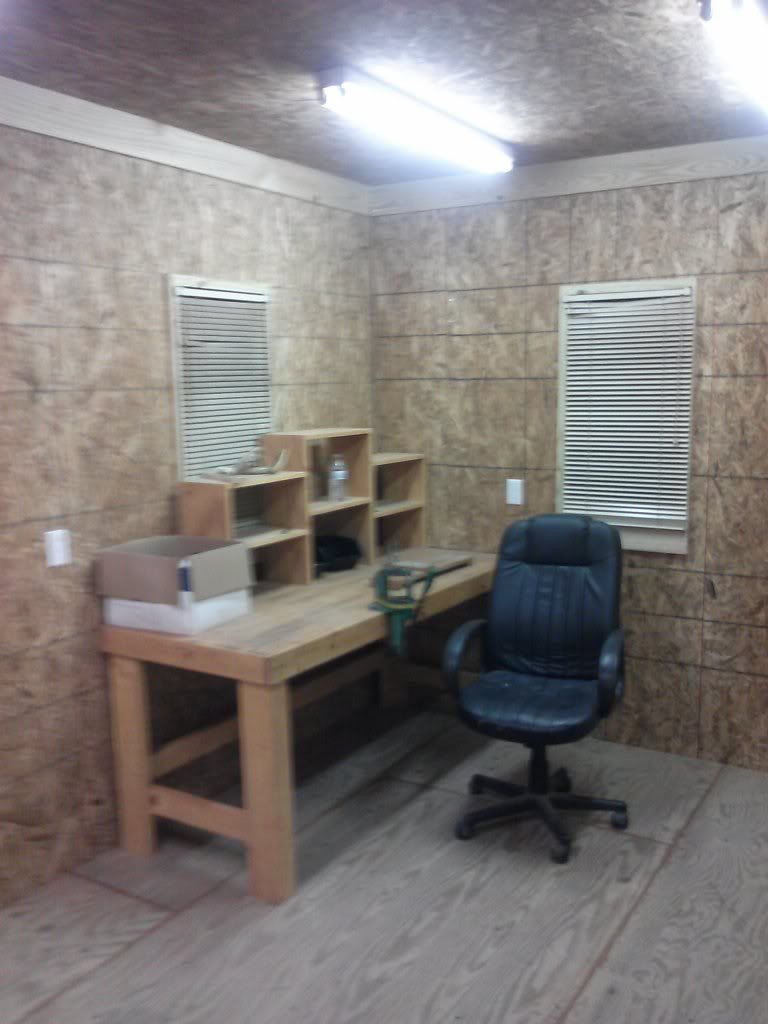

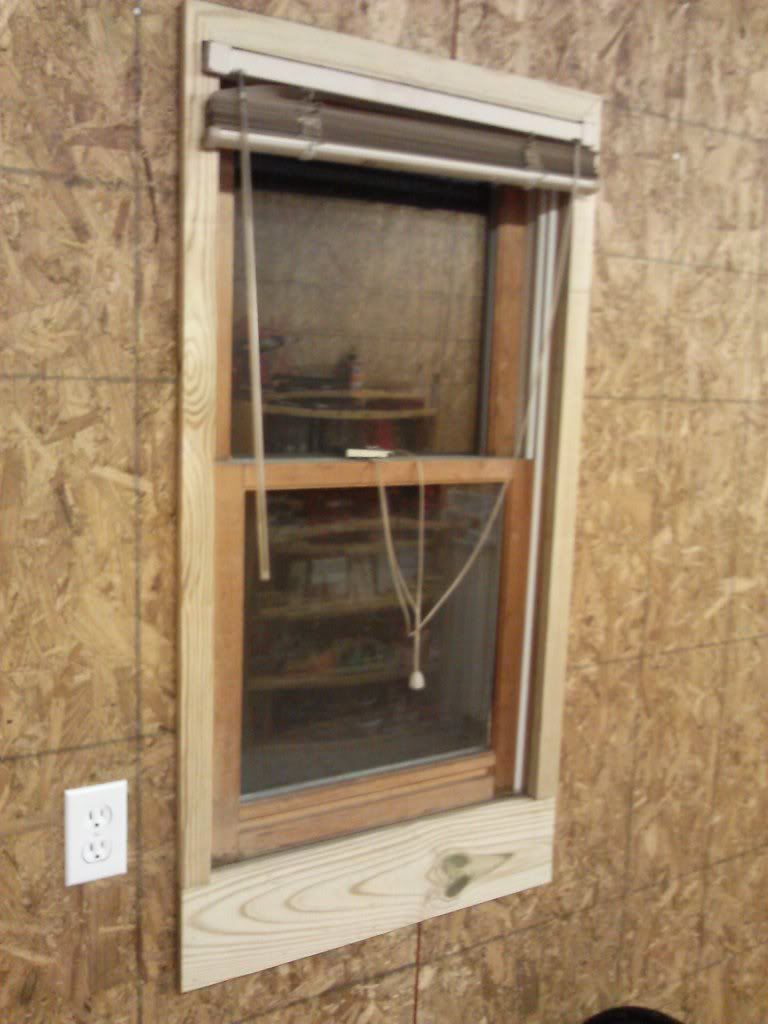

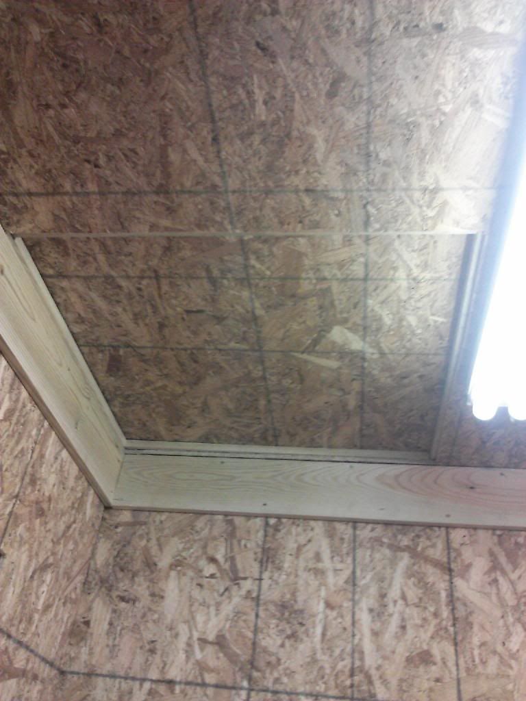

I finally finished construction on the office. I got the walls and ceiling in, and trimmed it out using 1x6s. Trimmed around the windows with the same 1x6s ripped down to 1 1\2" to make molding. I added a access to get into the attic space for extra storage. I still need to hang some cabinets and finish moving in, but the main construction is done. I think the next project will be plumbing the air lines in more permanently, then maybe I will return to tinkering on the CJ. I have been planning on running 3\4" air lines with 1\2" drops to the connections, but I haven't found any 3\4" hoses to use as a whip between the compressor and the hard lines. I think I'll have to see if someone locally can make one, possibly someone who makes hydraulic hoses.

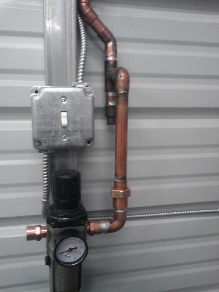

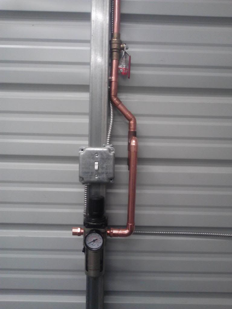

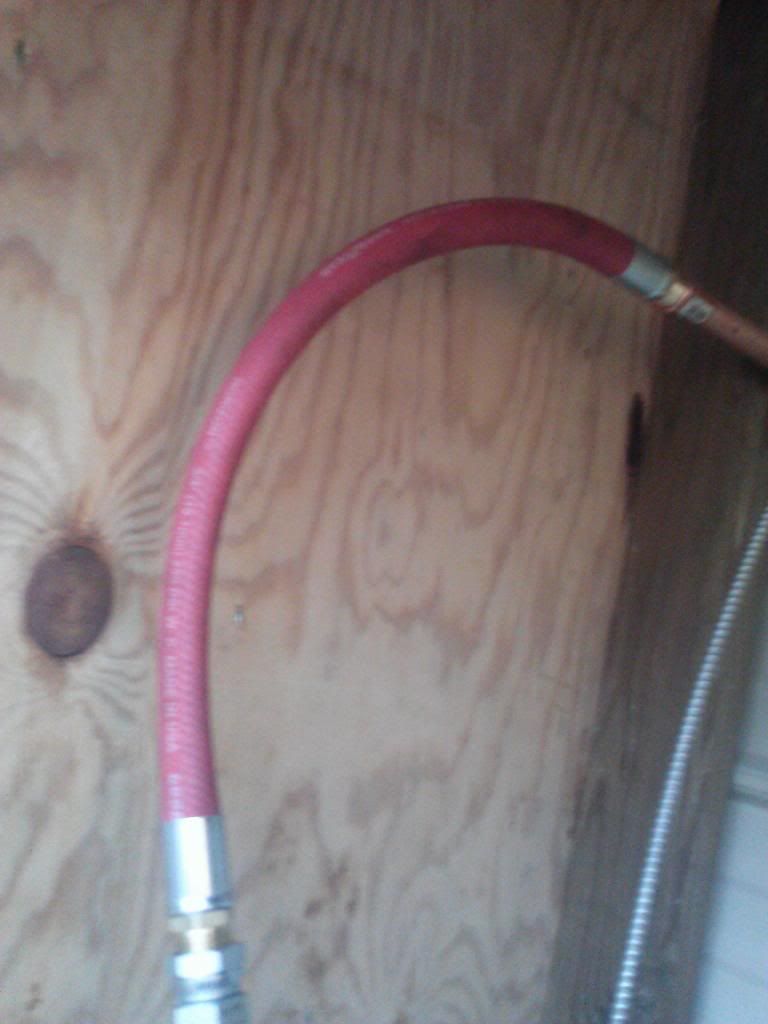

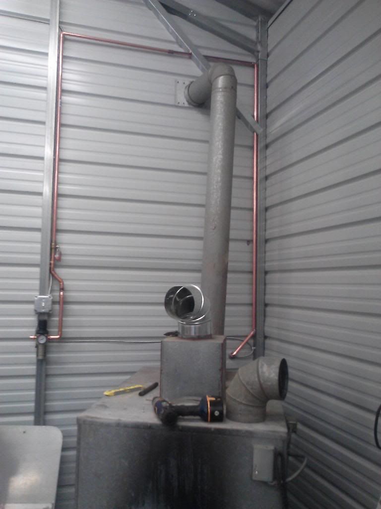

I went by a local hydraulic hose shop this morning and got them to make me a 3/4" 2' long hose for the compressor. I then bought some copper pipe and fittings and started mocking up the airlines. The line comes into the shop, then up, over and back down another post . I did it this way to add a little distance between the filter/regulator and the compressor to help dry the air some. There is around 20' of line between them. I realized that I need a union in the line beside the filter to install everything, may come in handy in the future anyway if I need to swap out the filter. Nothing has been soldered yet, just mocked up into place.

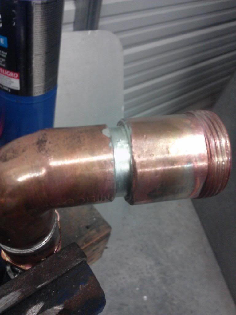

I soldered copper pipe for the first time today. I saw it done when I was a kid, but this is the first time I've done it. Once I figured out where to put the heat and that it takes very little solder to make a good joint, I got the hang of it and was able to charge the system up to the regulator. I added a union to the line which has to be tightened surprising tight to keep it from leaking. I had two other leaks, but they were at threaded connections that had to be turned to point a specific direction, all soldered joints were fine.

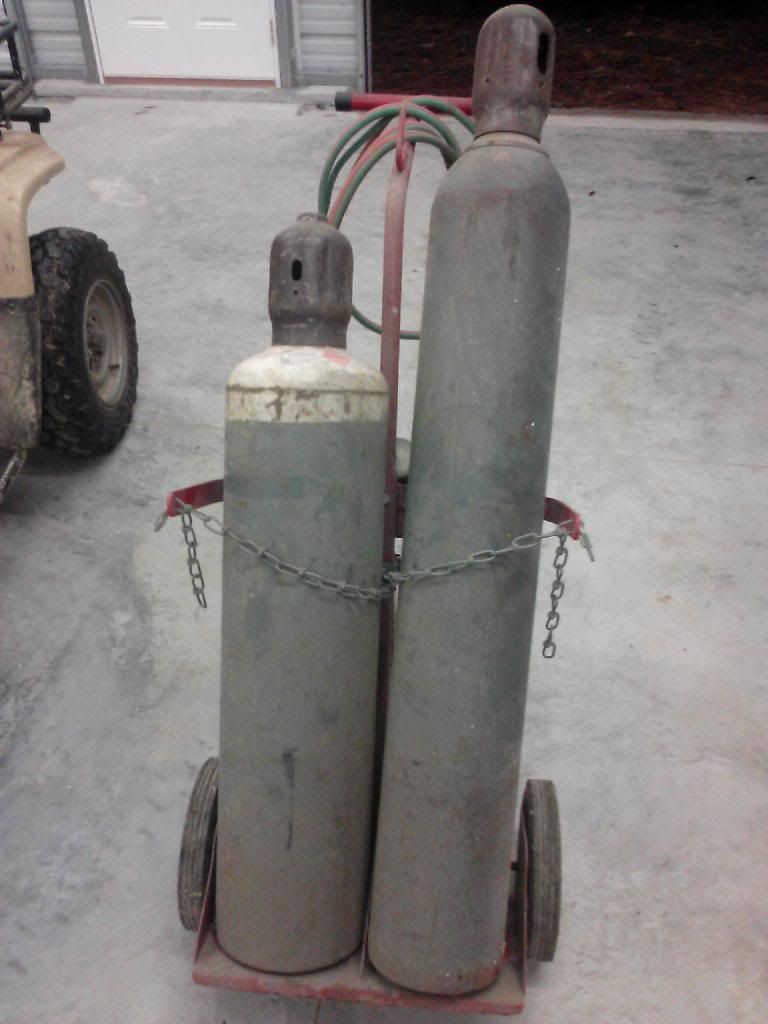

I haven't gotten much done in the past couple of weeks, but I did acquire an oxy-acetylene torch that used to be my grandfather's. I got it home to find the oxygen tank was empty and the acetylene tank has about 100psi. I exchanged the oxygen tank this morning, my old one was around 125 cuft, but they gave me a 150 cuft tank, the closest they had. I hooked up the regulators and both leak, with the T handle screwed out. Also I don't think I have any flashback preventers.
So now I'm in the market for a torch kit. The local welding shop has Radnor kits made by Victor for $215-$275 depending on size, but I also see off brand kits available in the $100 range. I don't know much about torches, can y'all tell me if the name brand kits are worth the cost difference, or oes anyone recommend a specific kit? I appreciate and advice on this y'all have.

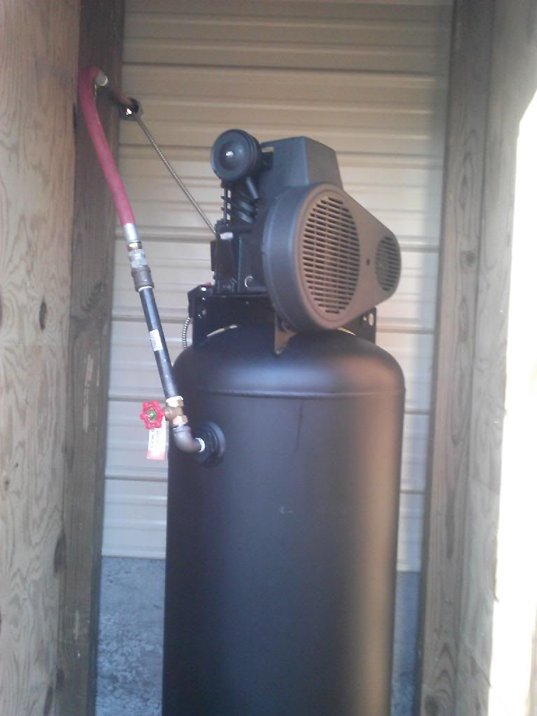

Bought and installed a new compressor today. I got the 60 gallon CH that I posted earlier. I followed the break in procedure and it should be ready to go now
