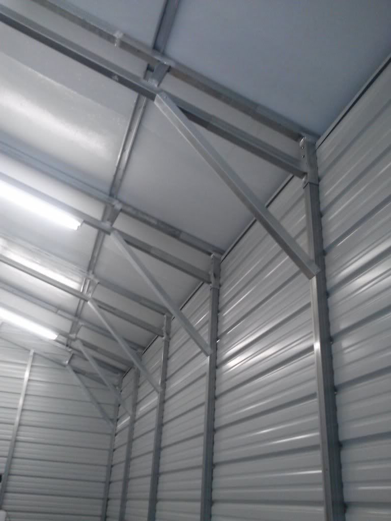

I got the braces installed today and everything is ready for a re-inspection. It'll probably be Tuesday before I get a chance to have it inspected. Hopefully it will all go well and I can finally stop trying to make someone else happy with my shop and start making it the way i want it. I also got some light bulbs, shop is lite up nicely.

Final inspection was today. Everything passed and signed off. Now I can really start setting it up the way I want it. There is a lot left to be done, but don't have to worry about inspections anymore

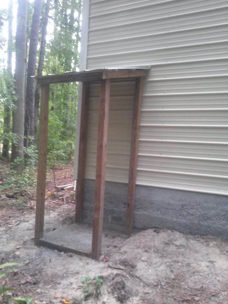

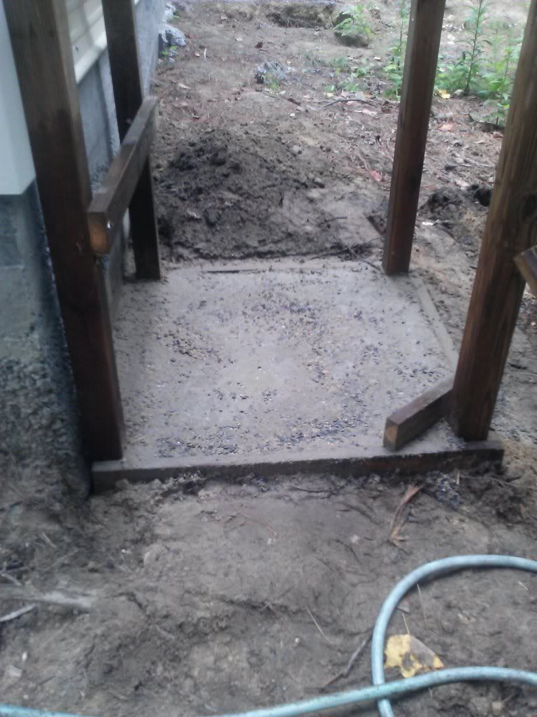

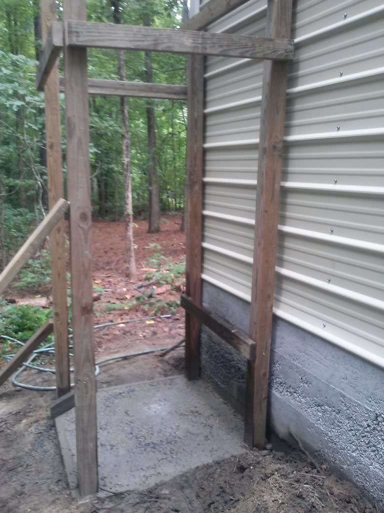

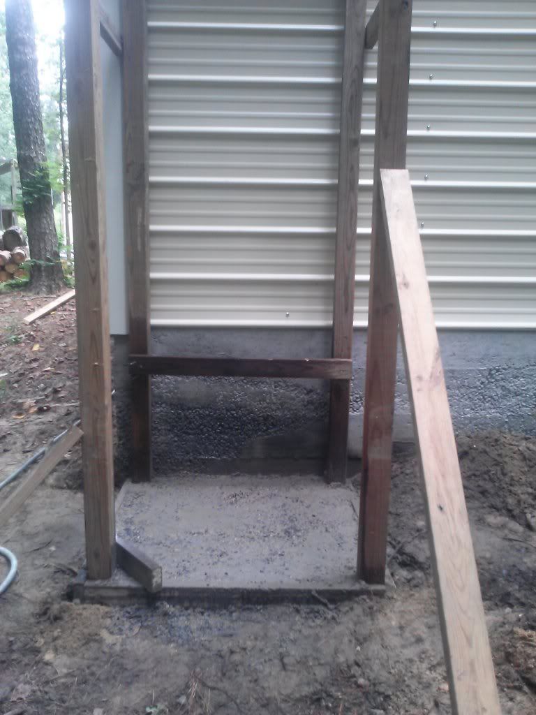

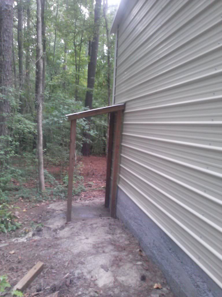

Started on the future home of my air compresser. I've never done concrete like this before, but it should do just fine for its intended use. The compresser is 220v but only has 2 hots and a neutral coming out of it. Can I use 12-2 mc for it, since the ground is covered in the cable or do I need 12-3? I was thinking black and white for hots and the green as the nuetral.
"If your gonna be dumb, you gotta be tough"

I plan to enclose at least two sides of the compressor house. I plan to leave one side open, as long it stays dry for air flow and cooling. The pictures make the posts look like they are not plumb, but they are. It sounds like you have a huge air compressor setup Jim. Mine won't be anything that complicated. I was thinking about coming in, going to the ceiling, over one stud then back down to the regulator/filter, then back up to a distributor line around the ceiling. This will put about 20' between the compressor and filter. Hopefully that will be enough to dry the air decently.

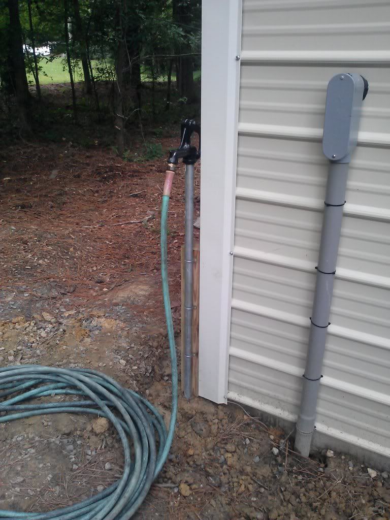

I've been pretty busy the past week, but got some stuff done. I put two coats of oil based paint on the doors and jambs to protect them. I ran some more wire for receptacles on the back wall and air compressor. Temporarily wired the compressor so I could use my framing nailer. Cut the posts off and put the roof on the compressor shed. Its taller than needed, but I made the roof line up with a seam in the siding, then slid a piece of flashing under the siding and on top of the roof to seal it up. Still need to add the side walls and permanently wire and plumb it. The discharge on my compressor is sized for 1/2" pipe, but I guess running 3/4" in the shop would still be a good idea for possible future upgrades.
