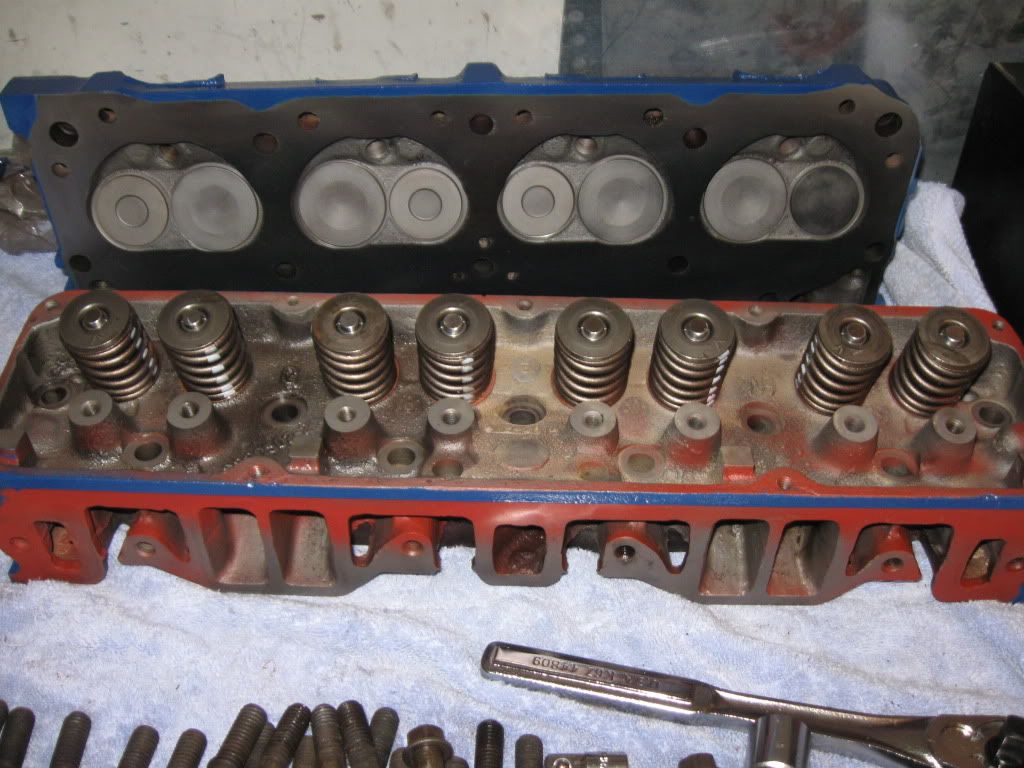

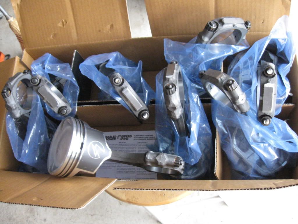

Well its been a while since I updated this. I picked up everything from the machine shop, hoping to start pre-assembly and paint this week. Here is the story from the machine shop
Block
Align honed
Bored/honed to 4.195" .030 over
decked to 9.190" from stock 9.205, so about .015 off the deck
cam bearings and all plugs installed
Heads
New guides
surfaced by .010"
valves ground
valve seats machined
2 new intake valves
new springs, locks, seals, rockers and bridges
new freeze plugs installed
Rotating Assembly
crank ground .010 under on main and rod journals
Rods reconditioned
Pistons installed
assembly balanced first spin off 14.3 grams front and 48.2 grams rear
final balance 4.1 grams front and rear
Other parts bought

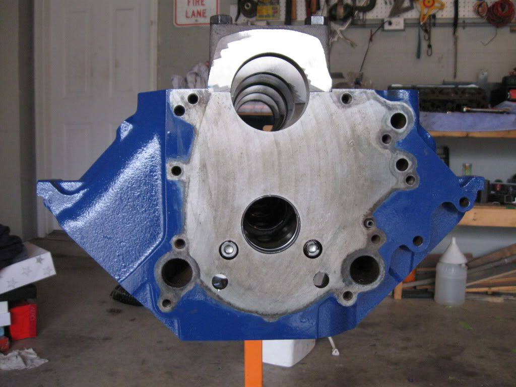

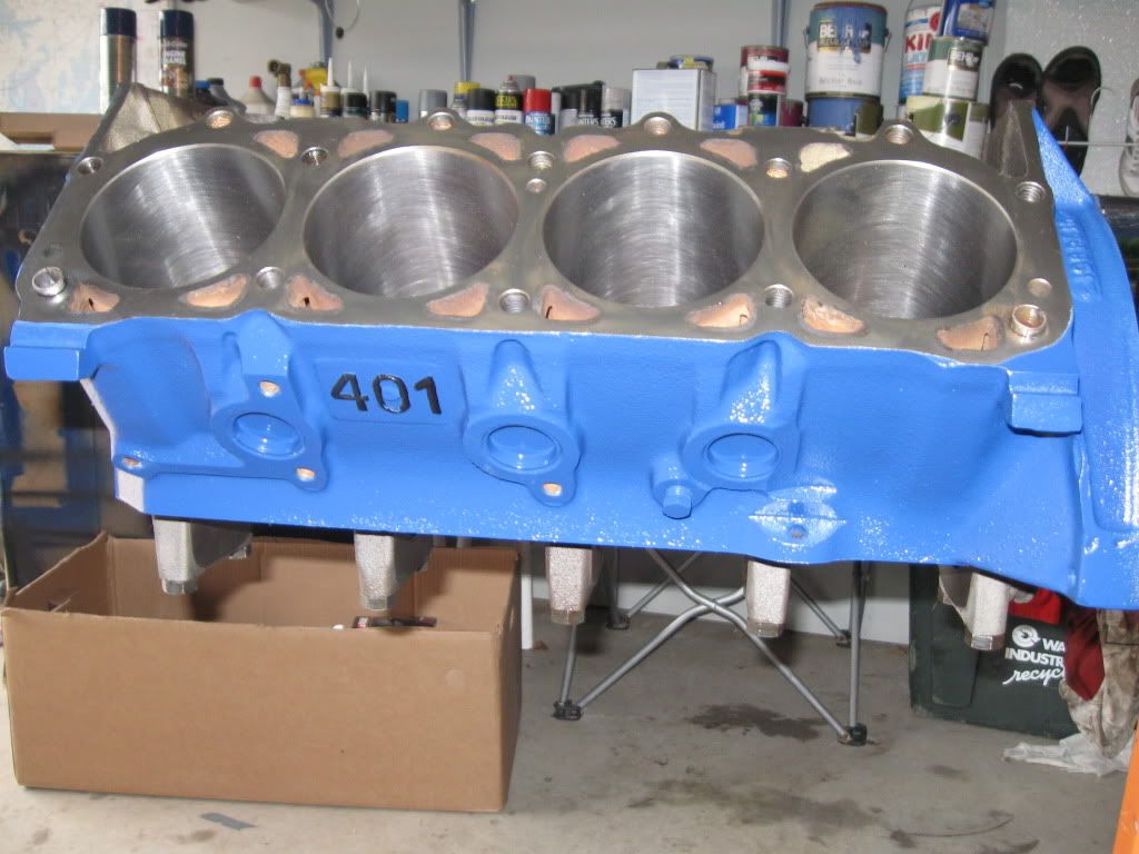

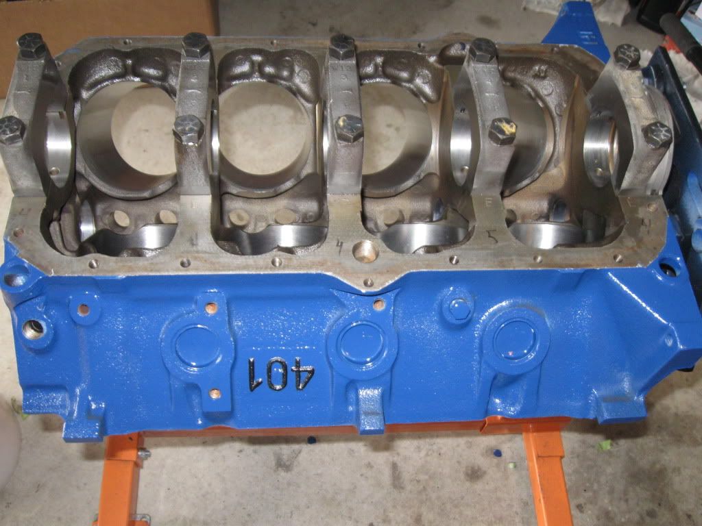

Got everything painted today, and checked oil pump clearance in housing, got a little bit more lapping to do. Thursday I hope to give the block a good cleaning, oil it lightly and start checking main/rod bearing clearances.
Anyone know where I can get the alignment dowels for the heads? I have all 4, but one is bent and i would like to replace it, or all of them.

What color of blue is that? It looks just like the color I used on my 360.
Beat it to fit, paint it to match!
Wheel, Wrench, Repeat.
82JeepCJ7 is offline
post #73 of 1018 Old 01-25-2011, 05:04 PM Thread Starter
TKFireman
1980 CJ7
Location: Apex
Posts: 1,295
that is Duplicolor Ford dark blue, got the idea of coloring the "401" from your pictures I've seen in the past, first picture looks a little lighter in color because of the light.
