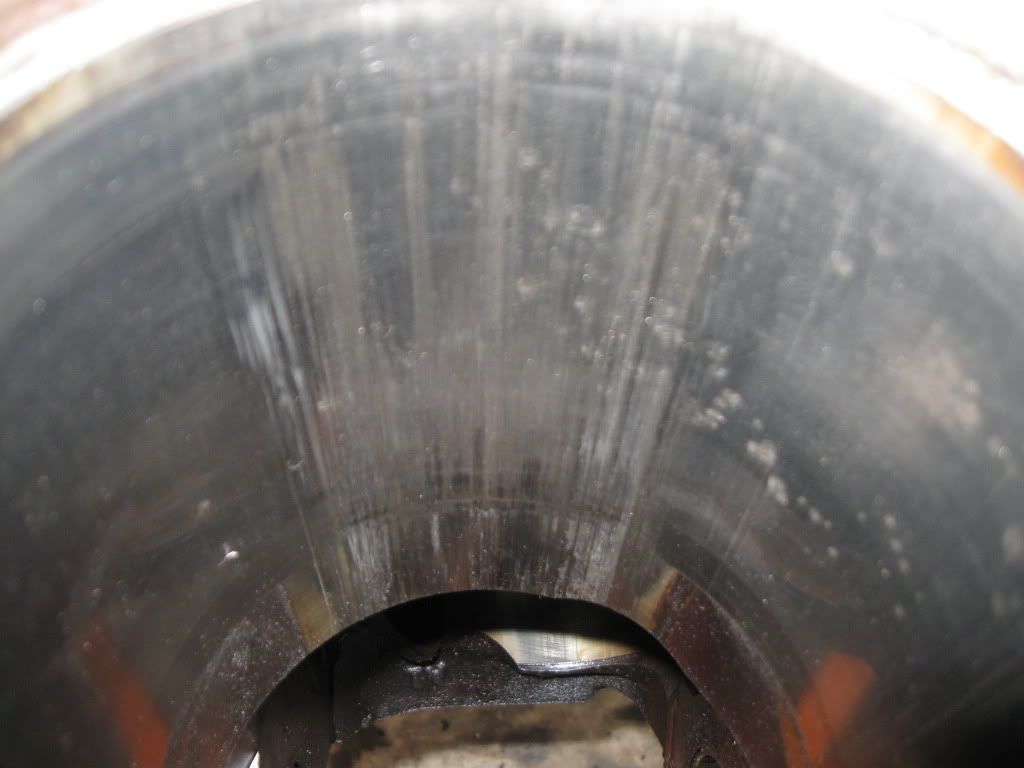

Finished getting everything apart today. The more I got apart, the more I thought I may get by without boring the cylinders, they were smooth with little to no lip at the top, then I got to cylinder #8, see pictures below. The grooves in the cylinder can be felt while running fingers over them, but don't know if they are considered real bad or not.

When the machine shop looks at it they can say whether it need bored or just re-honed they will have to measure the cyl. for the bore and the taper of the cyl. wall

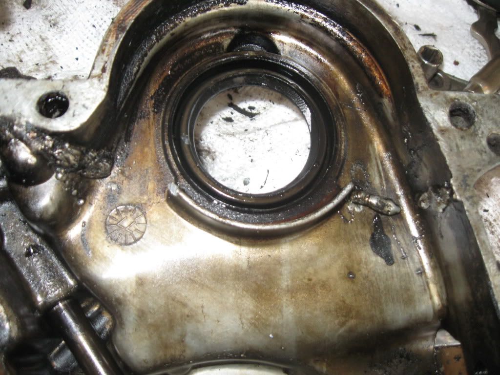

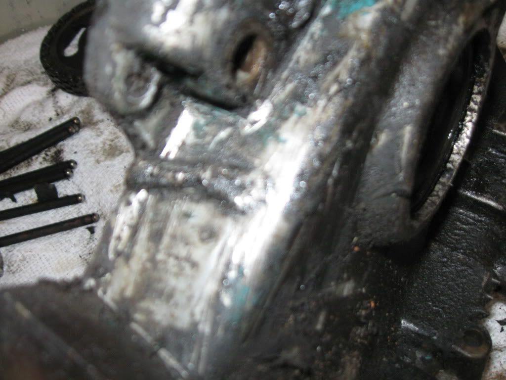

I found that the timing cover has been off before, cracked, and welded back, seems to be a working fix, we'll see if it is usable, or may be able to use one from the 304 that I'm replacing. I prefer not to buy a $200+ new one, but will if needed

Take the oil pump gears out of that timing cover case.. check the walls for scoring.. this is a big concern because the oil gets in the scores and oil pressure drops when the engine heats up.
You can buy entire timing case covers.. but they are a few hundred bucks. Bulltear has them I think. I still worry about my 360 rebuild since I kept the old cover. I have a mechanical oil pressure gauge that I will monitor when I do my first start!

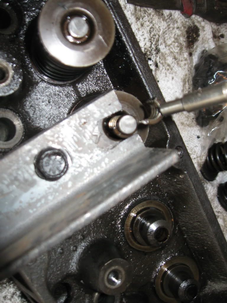

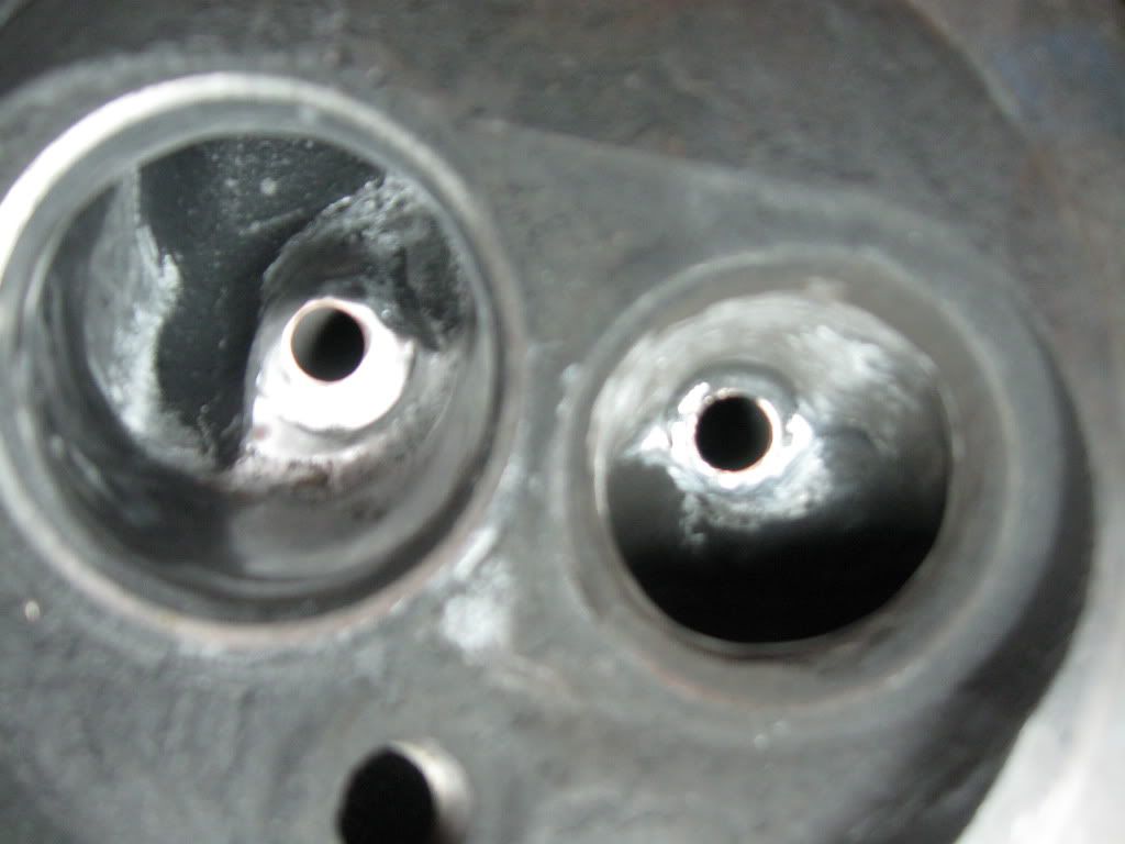

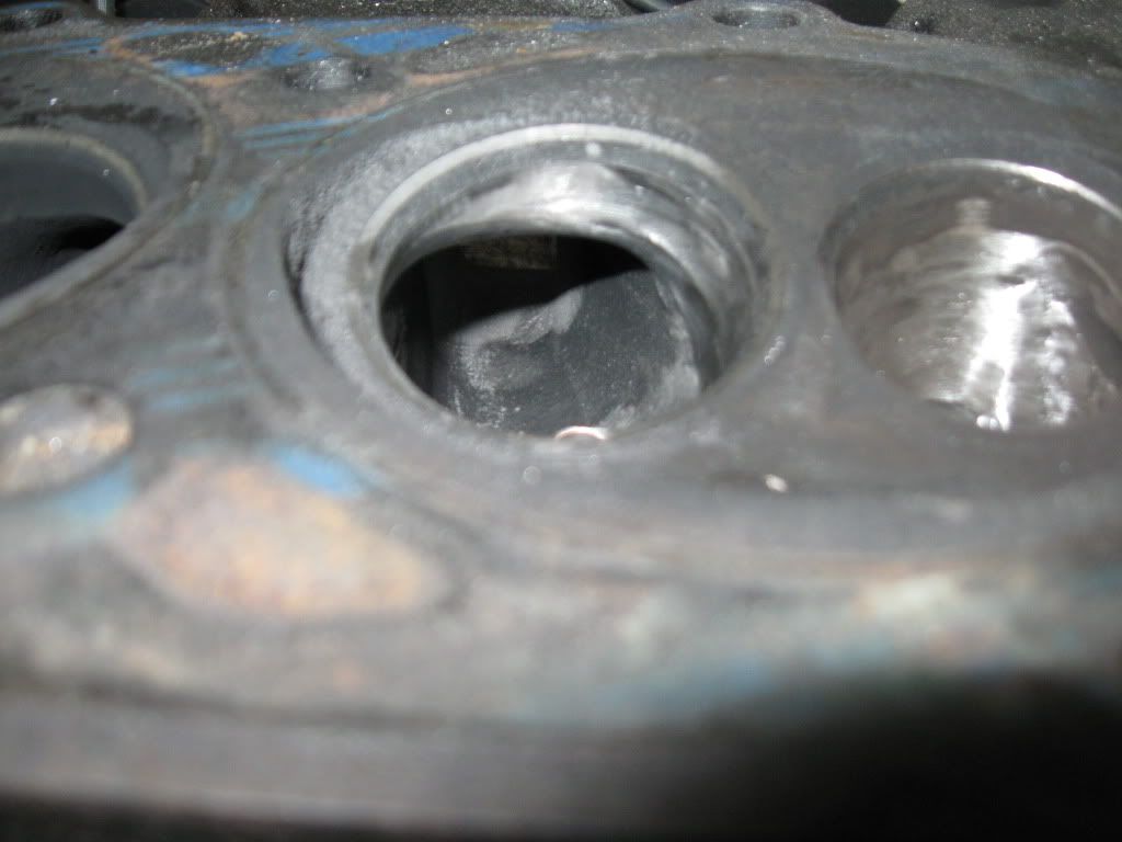

In the mean time, I have done a lot of reading about improving the air flow through the heads. So after talking myself into it, I made a homemade valve spring compressor which worked great, removed the valves, and inspected the ports. I found a few slags of material in there that can obviously be removed and some areas that look like they could be smoothed out a little. I'm not going to try to remove a lot of material, just smooth it over. Any suggestions would be appreciated or pictures from completed ports from an AMC V8.
I'll probably first try this with my dremel, if that doesn't work, I'll invest in an electric die grinder.

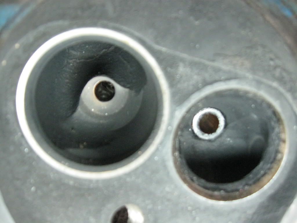

Well, I jumped in with both feet and gave it a shot, there is a good article here about porting, was very helpful.
Porting Cylinder Heads by Engine Masters Magazine

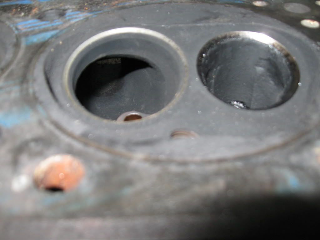

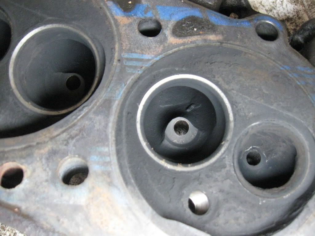

I rounded the edges around the valve guides, got rid of any casting imperfections I saw, and I think I made large improvements on the short side bend, getting rid of a ridge and rounding it out more, let me know what ya'll think. Not done, but think I got a good start, with hours more of work ahead of me

only do the short radis in the bowl area and get your self a 1/4 rod cut a slot in it and wrap sand paper around it to polish were you have ground any ques PM me
and the AMC heads flow better they start around test 3-4 factory and go up from there
Are you saying that I shouldn't do anything around the valve guide, or are you saying just stay away from the valve seat area? I have a flap wheel for my dremel that polishes decently, put the sand paper on a stick I'm sure will have more control and get into smaller places, I'll give it a try, thanks
