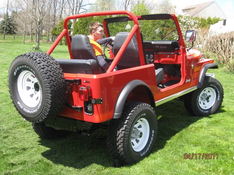

Another vote for 32x11.50 on stock rims!
I previously had 33" with stock gears (3.31) and what a dog it was on slight inclines. Now we have 4.10 gears and 32" tires and I couldn't be more happier. The 32" tires fill the wheel wells out nicely and they look like they belong right at home. Not to big, not to small.
