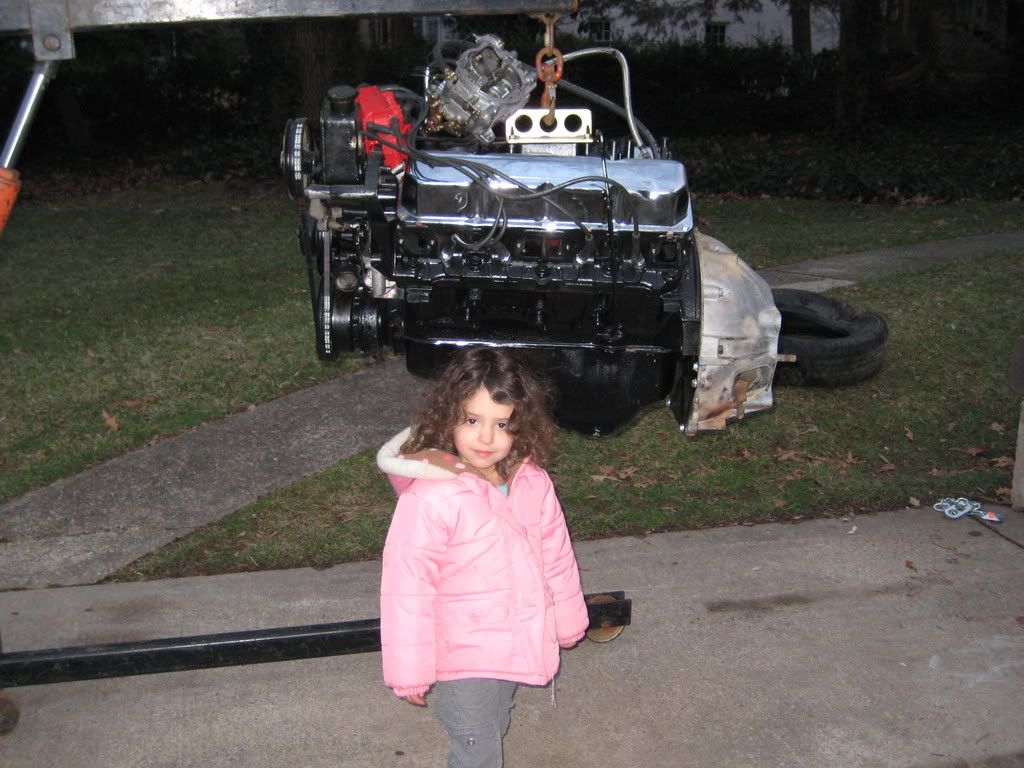

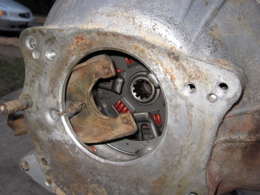

This is what I have, a motor with the bellhousing and new clutch kit as seen in the picture and the empty engine bay with the trans input shaft sticking out of the tranny. The missing part is the release or throwout bearing. Like I said I have not done this before so a simple answer could easily be evading me. I am on my way to the parts store to buy a bearing (actually order one, it takes a day or two). I am just hoping that it will be a simple fix and the bearing will go on easily.

Nice pics, excellent close ups. Your throwout bearing will have clips on one side of the bearing, they clip on the back where you can see the old marks on pic 3, bearing on the front side on the shift fork.

Yeah man see those scrape marks on the tips of the fork? That's where it clips on.. like the folks here were saying, it should take you about 30 seconds to throw that sucker on.
