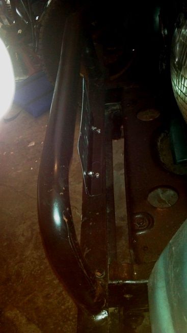

Yesterday I finally took the time to get the CJ5 registered. Slight PITA. Had to call the POPO to come over and verify the VIN, then to City Hall for the first part of the registration, then to the nearest state substation to get the plate. Then I discovered there was no front plate bracket. I got out the die grinder and cut off a piece of 1x1 steel angle. Used the cutoff wheel to round all the corners and edges, and to remove any corrosion. Drilled for license plate, slotted for bumper. Primed. Painted black. Bolted to center top of front bumper and then bolted the the plate on.
Picture is before bolting down, looks like it shifted in the slot a little bit before I took the pic
Yahoo, I am legal! Gonna make an appointment for inspection next week. I think the crud in the gas tank is impacting the fuel pump, thing is short of power and runs lean unless I pull the choke out just a skosh. Then it runs perfect. Looking forward to new tank/sending unit/fuel line.
