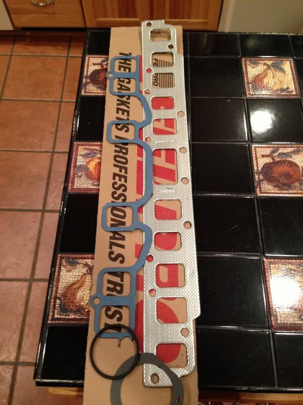

I have an Offenhauser intake and Hedman header installed on my 258 which I need to remove and reinstall to seal up some vacuum leaks.
I ordered a replacement gasket from Hedman, which isn't much to write home about - some kind of pressed cardboard, that seals the intake and exhaust ports.
Hedman
Just in case, I also ordered a gasket kit from FelPro.
The kit had a similar designed gasket, but laminated with a metal facing.
It also had a separate, rubber gasket to seal the intake ports. As well as a couple others
Felpro
So my question is, what gasket(s) do I use??
Sealant/ no sealant? If so which sealant? And where?
Thanks in advance!

I used both on mine but I don't have a header.
I probably just could of used the intake gasket with the stock exhaust manifold but since you have headers I would use both.
I just use HD axle grease, makes cleaning them off easier later but I'm guessing the header flanges may not be as flat as a machined exhaust manifold.

I would go with Felpro since I never had a problem with them.
The cardboard style I have had problems with since they are thinner and I have had them burn through with the heat.

I am definitely going to go with the Fel-Pro laminated gasket.
But what about the rubber intake gasket?
I think I have to call their tech Support regarding installation.
One of Fel-Pro's technical documents states:
"....one side is a fiber material and the other side is steel.
Just remember to install the steel side toward the manifold and the fiber side toward the engine block. This allows the exhaust manifold to slide along the steel surface during expansion and contraction without damaging the gasket."
There is no mention of sealant, which I think would eliminate this 'movement'.
I would think a rubber gasket between the intake manifold and exhaust gasket would hinder any 'movement' as well.
Thoughts?

The intent of the seperate intake gasket is so the clamping surfaces are flat across. In some cases like John mentioned without using the intake gasket its spaced closer to the head then the exhaust where the cupped washers clamp against the manifolds. In which case the intake never gets the same clamping torque the exhaust gets.
You may need to try mounting with and without it to see how it works for you and your combination of manifolds.

I think the Fel-pro gaskets are designed to be installed dry, but I don't think a little copper spray would hurt, just to help keep everything in place while you bolt it up.

I think I am going to go with the Fel-Prolaminated gasket AND the blue rubber intake gasket.

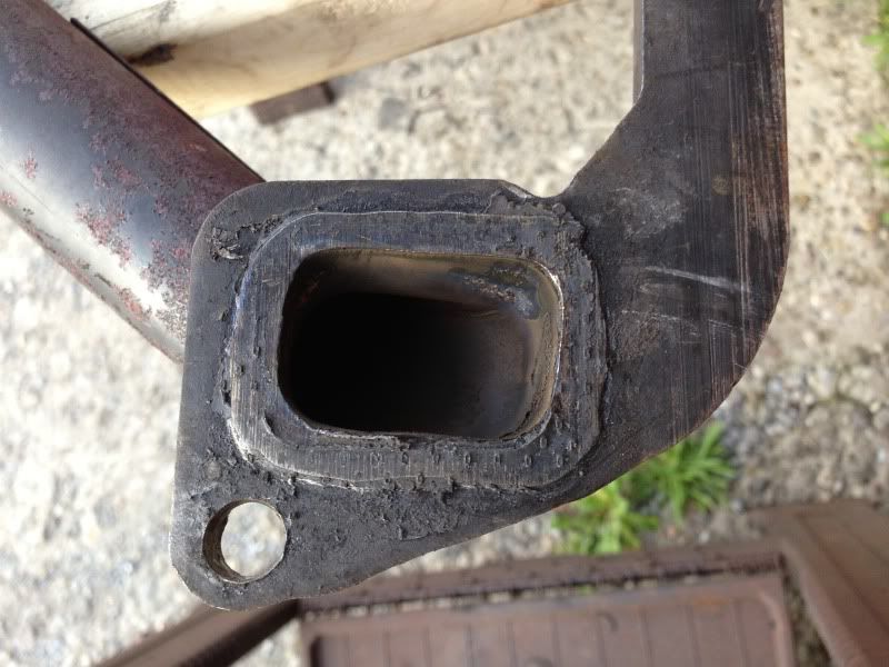

I was never happy with the workmanship of the Hedman header.
What do you guys think about this?
Should I grind it down?
Thanks in advance
2X

Eh, it might help sealing with the raised lip like that as long as it's torqued properly.
How would you guarantee your grinding will make it flat??

Fel-Pro's tech support claims their gasket is used to accommodate lack flatness found when using headers (to a point).
As you know there was no gasket from the factory as all surfaces were machined flat.
So U was thinking 'relatively' flat might be worth a try.
But I see your point with the extra material helping with clamping pressure....

I have the same header on the same engine, and I used the same Fel-Pro gasket set. No sealant. Clamp your headers in a vice. Use a long metal file and file across two of the header inlets at a time. Go slow and keep the file flat. I don't know what you call it, but there is a HUGE file board made to cover all of the inlets at once. Don't know if you can get your hands on one of those. My neighbor has one, so I got lucky. I have no issues with exhaust leaks.
