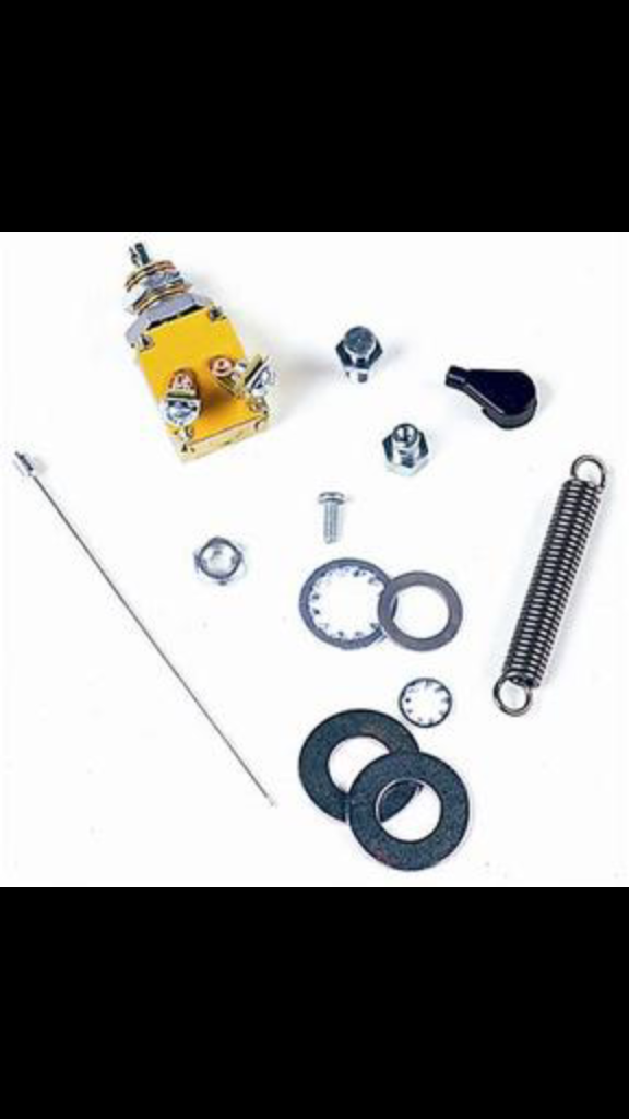

B&m makes a pull style switch for the th400 that mounts on the throttle linkage.

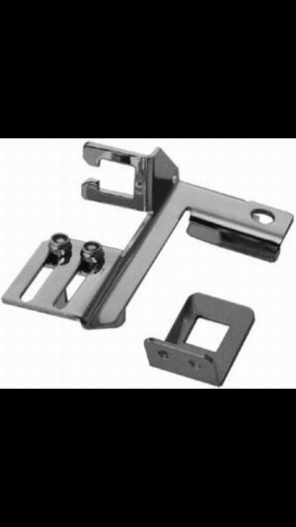

I assume you're runnig a gm motor, if so, get a cable bracket with an adjustable kickdown mount if you don't already have one. Oreilys has them on the wall and they are only about 10 $.

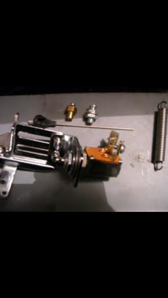

Here's how it will look in the mount. Its a pretty straight forward procedure. Then all you do is run a wire to a 12volt switched source then run a wire to the kickdown solenoid. Adjust the bracket to what throttle percentage you want tge kickdown to come in at. I usually do it a lil less than 3\4.
i saw that B&M one but was unsure because the descriptions i saw said it would work only if you had previous TH350 or 700R4 then you could use the old hookup for it so was unsure.

Any type of momentary switch will work. I've seen people use mirco switches, the same used in nitrous systems. But the bm will work. Its universal
