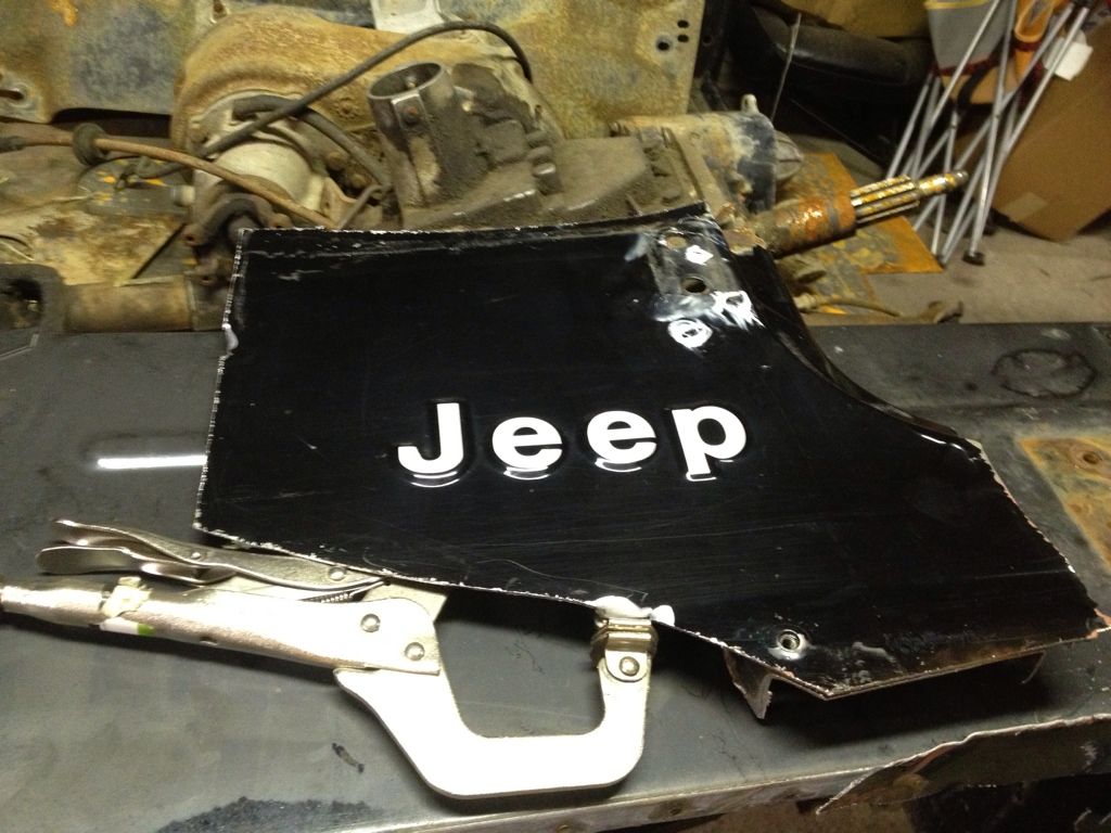

Got the Jeep back in the garage and finished getting the side panel and LH rear corner cut off. We had already patched the hole for the YJ fuel filler but since the side panel was coming off we decided to replace the corner as well.

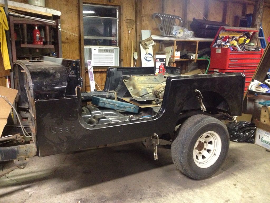

Test fit the new side panel. Looks like it's going to fit properly.
Cut the "Joop" stamping out of the original panel. This will need to be spliced into the new side panel since the "Jeep" stamping is not correct for the year of my Jeep (mid 84 and newer are Joops) and it's not even the correct font compared to the '76-mid '84 that were stamped "Jeep"
Now I need to do some repairs to the floorboards in the driver's foot area and where the B Pillar mounts to the floor. I bought new panels from Quadratec that are KeyParts brand that appear to be exact duplicates of the original. Hopefully when installed correctly you won't know anything was ever done to the floors.

"Cut the "Joop" stamping out of the original panel. This will need to be spliced into the new side panel since the "Jeep" stamping is not correct for the year of my Jeep (mid 84 and newer are Joops) and it's not even the correct font compared to the '76-mid '84 that were stamped "Jeep"
Are you saying the factory put out some "Joop"s? I never knew this. I always thought (when I seen them) people had repaired the area and were just too lazy to detail the putty back out of the eep centers.

All tubs from mid-84 on thru '95 were stamped "Joop" there's a few threads about it here.
Keith460's original tub was a "Joop" but his repli-tub is "Jeep". It is the correct "Jeep" stamping though unlike the replacement side panel that I bought.
I really didn't want to get into the body as much as I have had to. It just happens that the further I have went, the more I have found rusted. Right now I'm into this tub for about $600 in panels to repair it.
Had I known that there was this much hidden rust I would have purchased a "scratch and dent" repli-tub from Jeep Hut as they seem to regularly have the Jeep stamped tubs for about $2300 and the generic tubs for about $1900.
We will see how the installation of the floorboard panels and side panel goes and that will determine what I do from there. If it ends up looking like it's not going to turn out undetectable when finished then the tub will be replaced with a new one.
What makes that 'Jeep' script incorrect? Hard to see what's wrong in the picture and is that panel from Classic Enterprises? I've read somewhere that people who purchased the side panel from them did not like the Jeep script on their panels.
Hey Keith,
Check out my earlier thread on the side panels: http://www.jeepforum.com/forum/f8/ne...-jeep-1383012/
That shows what's wrong with the "Jeep" script compared to pictures from your repli-tub. This panel is another Cobra King panel like the first one from that thead except it's not dented and bent up like that one was.

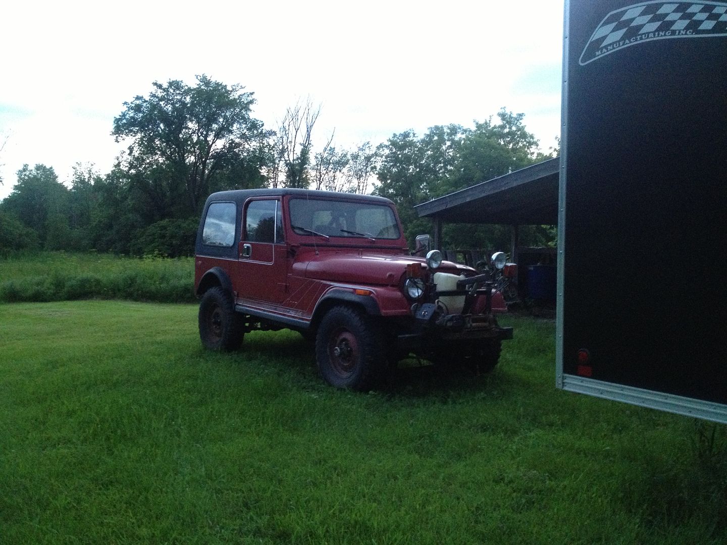

Thanks for bringing this up! It hasn't progressed much at all. I decided to get a new tub for this CJ (which I got when I was 16) but I don't want to take the YJ tub off my frame until the panels are reattached so it doesn't take the tub out of square. I need to find a new person to do welding for me as that's not one of my stronger points. I think I have found someone, it's just a matter of him having the time to get that done.
I purchased a 1985 CJ7 Renegade this spring that's in really rough shape to use for a plow Jeep. This tub will be going on that so once that's done I can begin concentrating on the restore again.

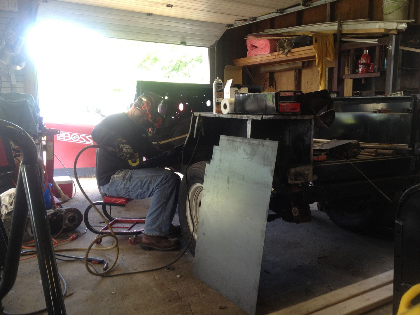

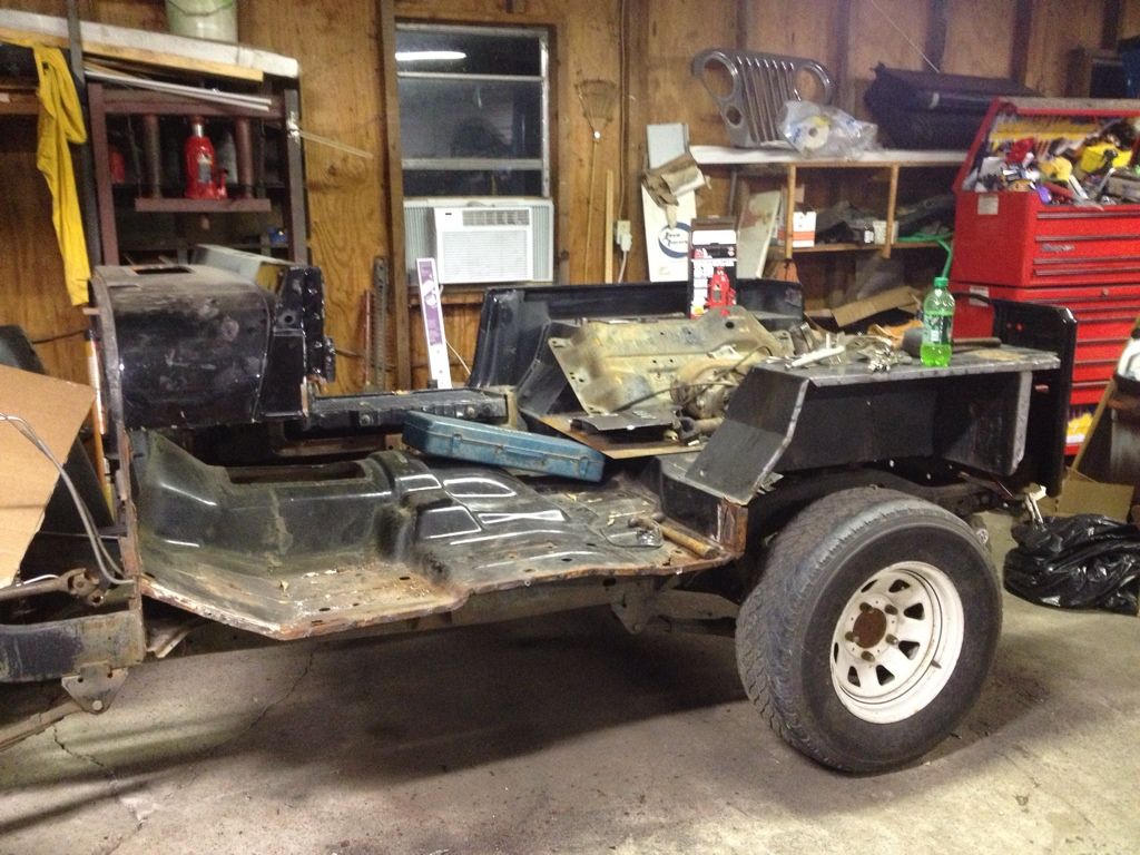

Finally making progress again!! This tub won't be staying on this Jeep but I need to put it back together before removing it because I don't want to get the tub out of square. I'll be using this tub on a Jeep I picked up for snow-plowing. Once the tub is together it will come off and then I can continue on the project.
I will be starting a new thread for the Project Plow Jeep because I'll be doing a little fixer upper on that which I have to do first so I have a plow vehicle for this winter. I'll be cleaning/repairing the frame and installing this tub, and also new fenders.
And yes, that's the gas tank on the front of it. I'll be installing a new tank and running new fuel and brake lines as well. This won't be a show restoration, only fixing it up to be solid and roadworthy as it will be exposed to salt in the winter time with plowing and all. I will repaint it in the original Garnet Red and if I'm feeling froggy maybe even splurge for the original Renegade decal set. I can see were the original decals were under the paint in places so I'm fairly certain it was a Renegade. 66000 original miles.
