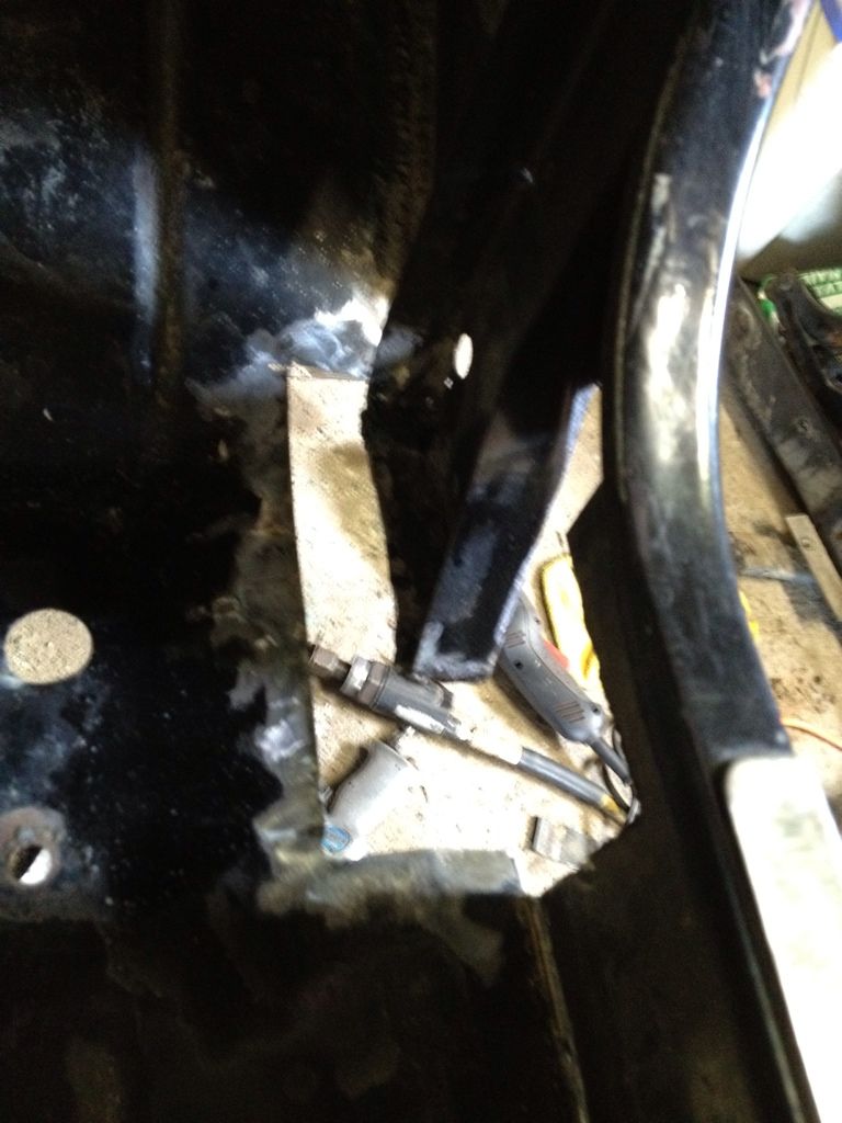

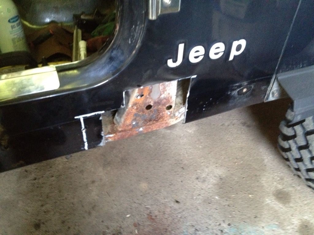

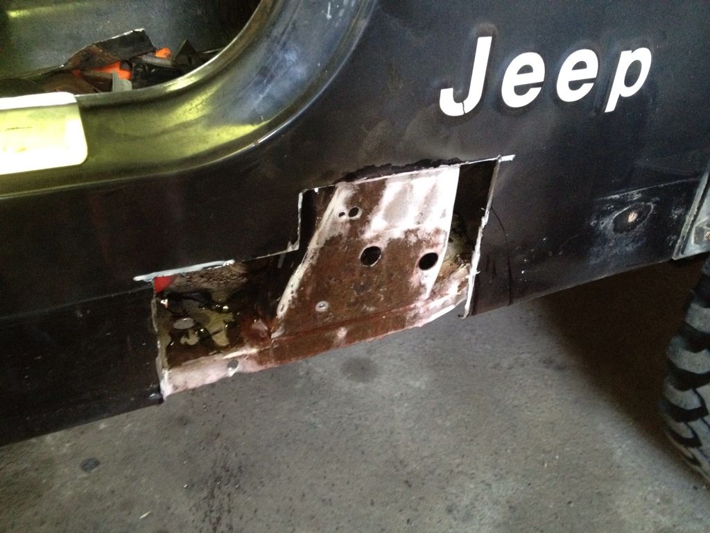

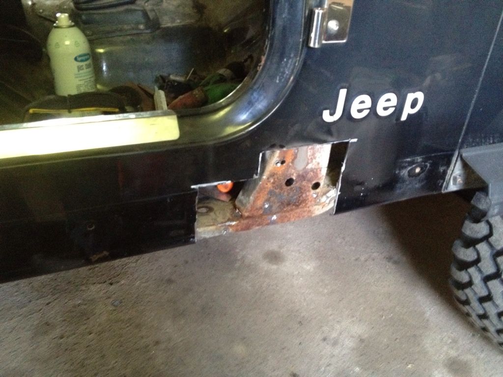

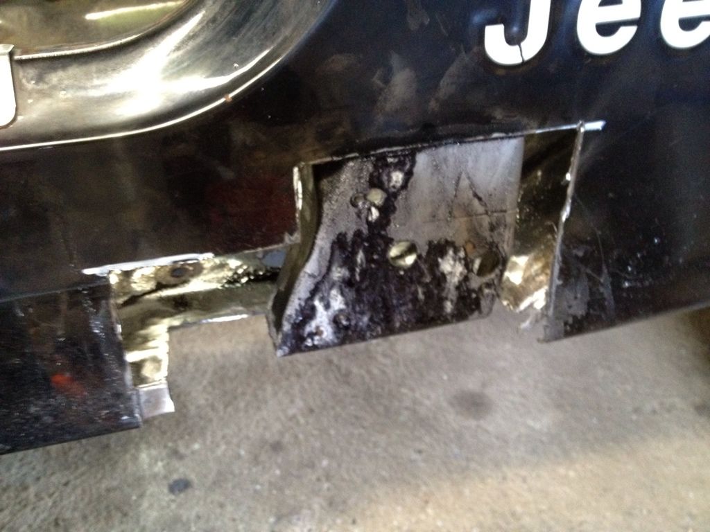

As you can tell from where I left off last night you can see that more needs to be cut out to get to the sound metal. I traced out a slightly larger cut and got the die grinder back out.
we are into good sound metal on the floorboard lip and much better metal on the cowl brace but not entirely rust free. I fear if I keep cutting though that I'll be all the way to the top so this is going to have to be good enough for now. I'm hoping with good paint on everything and seam sealer that it will keep most if not all of the two key components needed for oxidation (moisture and air)

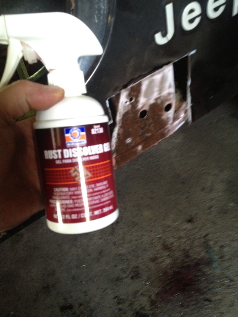

I couldn't find that Kleen Strip prep and etch stuff. I looked at Lowe's and at Tractor Supply. I did find this stuff though. Main component is Phosphoric Acid so I'm fairly certain it'll do the same job just a different bottle. This is a gel as well so it sticks and stays around better. I've got it soaking away right now after grinding off as much as I could with the die grinder.
Now I'll get my new patch cut out to hopefully perfectly fit the hole. This will be my first welding job so we will see how I do. I'll report back after I get that done.

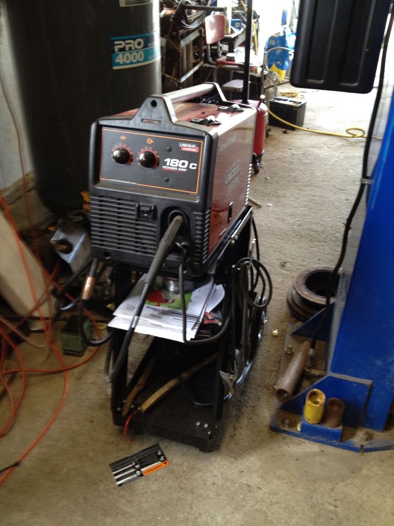

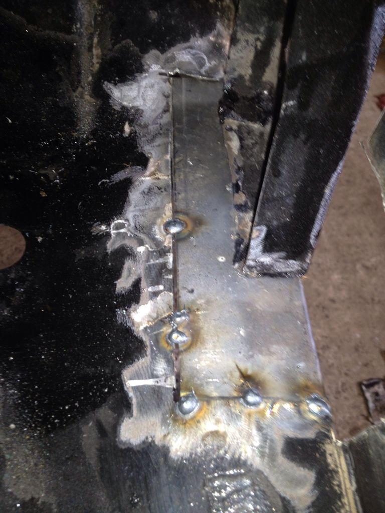

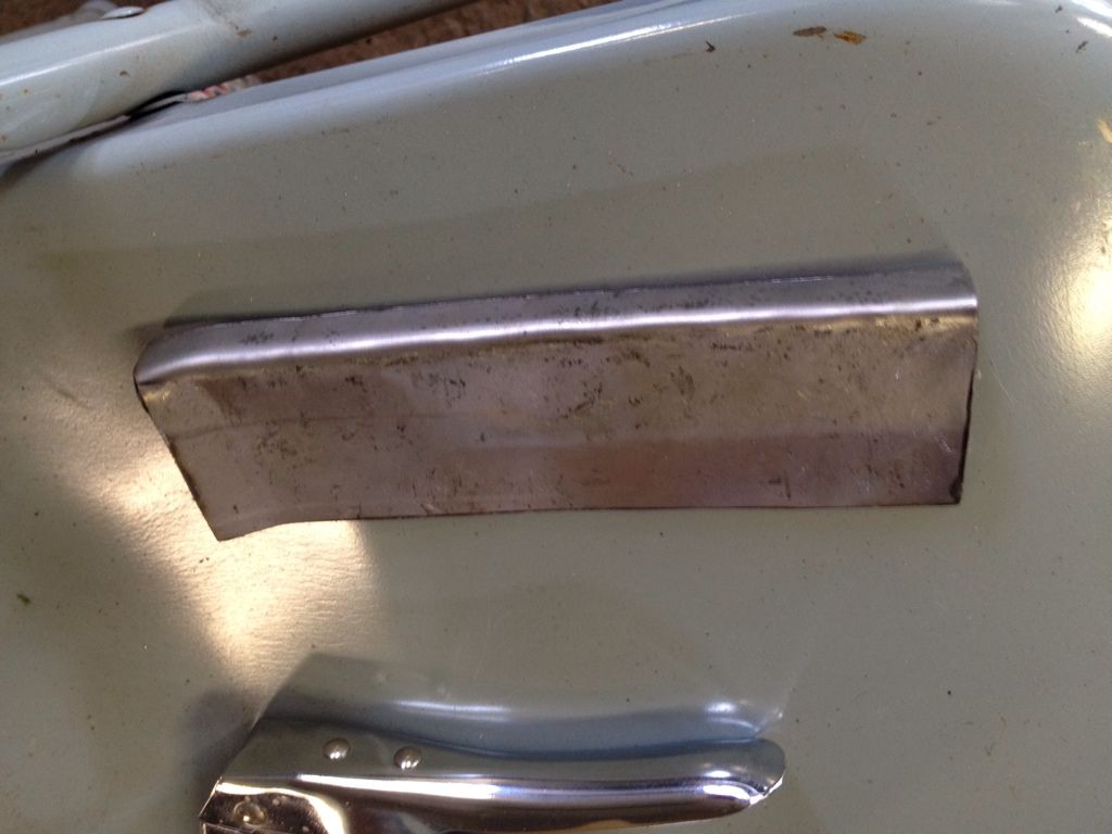

Today we learn how to and how not to weld. This is my first time welding anything so hopefully it turns out OK. This is why I'm starting with the floor patch because you do not see that so if I mess it up no biggie.
Here's my equipment. Lincoln PowerMig 180C
And my Miller Elite helmet
Here's how the brace looked after soaking in phosphoric acid overnight. Hopefully this is good enough.
Cut my patch out of 16ga as that's all I had. I believe the floors are 20ga but this will have to work.

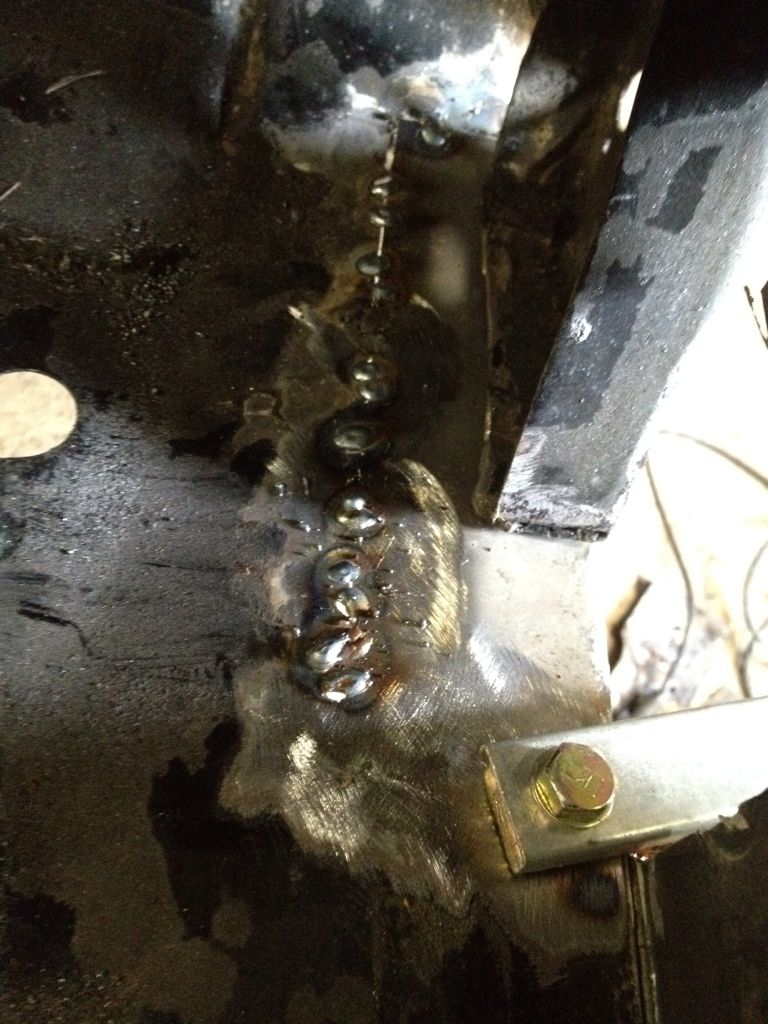

I've put a few tacks on so far. I don't think I've got the heat up high enough. I did get good penetration on one of them.
If anyone has any pointers on what settings to use on the welder for what I'm doing with it I'd appreciate it. I'm going to grind off the bubble gum welds on the left side right now, open the gap justa little as I think it's a touch too tight and give it a few more spot welds and see if I can get them as good as that one thats near the center of the patch.

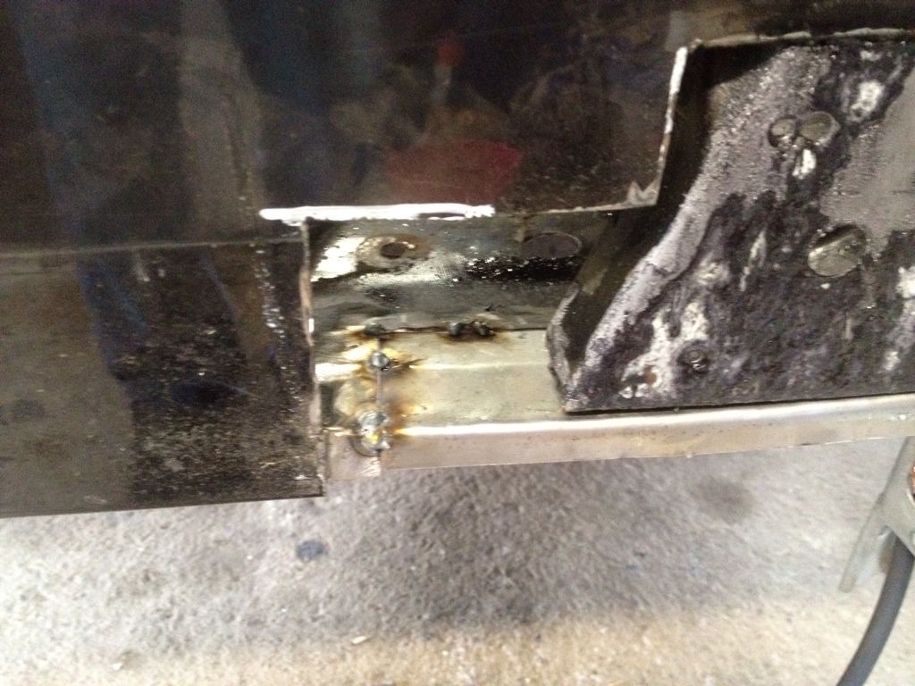

A little more progress. I've got as far as I think I'm going to go with this floor patch. The thinner floor and thicker patch aren't a good mix for an inexperienced welder like me. I've still got a few little spots where light shines thru meaning that part didn't get welded. I think what I'm going to do from here is put some JB Weld all along the weld seam then sand it down smooth and call it good enough for paint.
The outer patch should be easier as it's all 16ga steel. I didn't have any problem with blow thru or anything with that, just with the thinner floorboard material.

An auto body repair guy is born BABY!! Looking good, to this rookie welder.
Are you getting full penetration? It looks like it. Don't stress over the pin holes. A good metal glaze will take care of that.
I bet you're having fun.

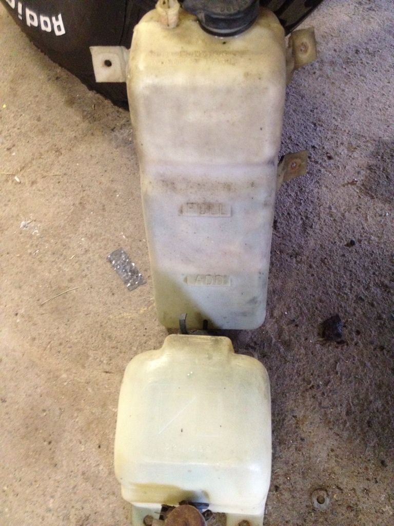

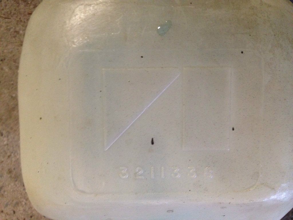

Also... Does anyone have a good method for cleaning up the coolant overflow bottle and windshield bottle? These are the original OEM AMC pieces and aren't broken or anything so I'd just like to pretty them up some. They are the translucent white plastic.
