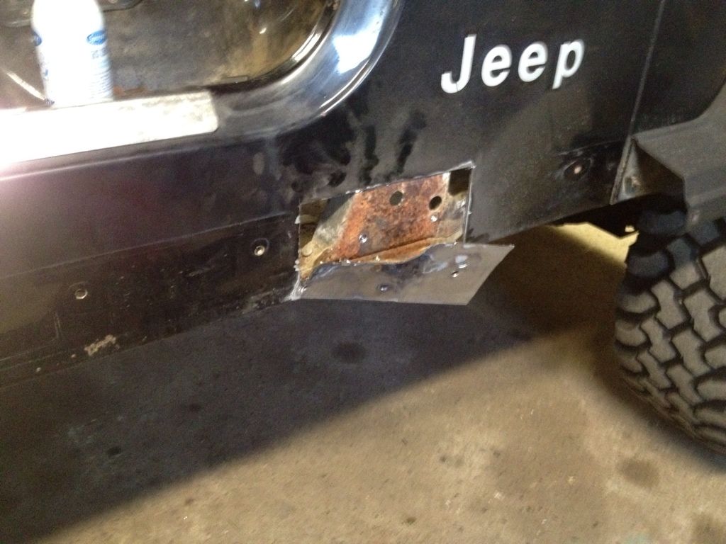

Since I've got nothing to lose here I did a little more work on it tonight after work.
Rust from the inside out where the cowl brace is spot welded against the side panel:
Traced out, cut, sanded down, spot welds drilled:
Started removing the piece. Missed the welds a little. Needed a tiny bit of chiseling:
Rusted piece removed to reveal rusting cowl reinforcement. I'll need to cut out further up to get to clean metal I guess:
This is the problem with rust. How far do I go to reach the clean stuff? I don't want any rust left on the cowl reinforcement that will just do the same thing to my new patch a couple years down the road. This is why I'm debating getting another tub. As far as I can tell the floor lips are clean as I go back away from the cowl reinforcement a couple inches. I'll cut a little more out and see where I'm at. I don't want to get up into the "Joop" stamping as that kills the Jeep if you know what I mean.
