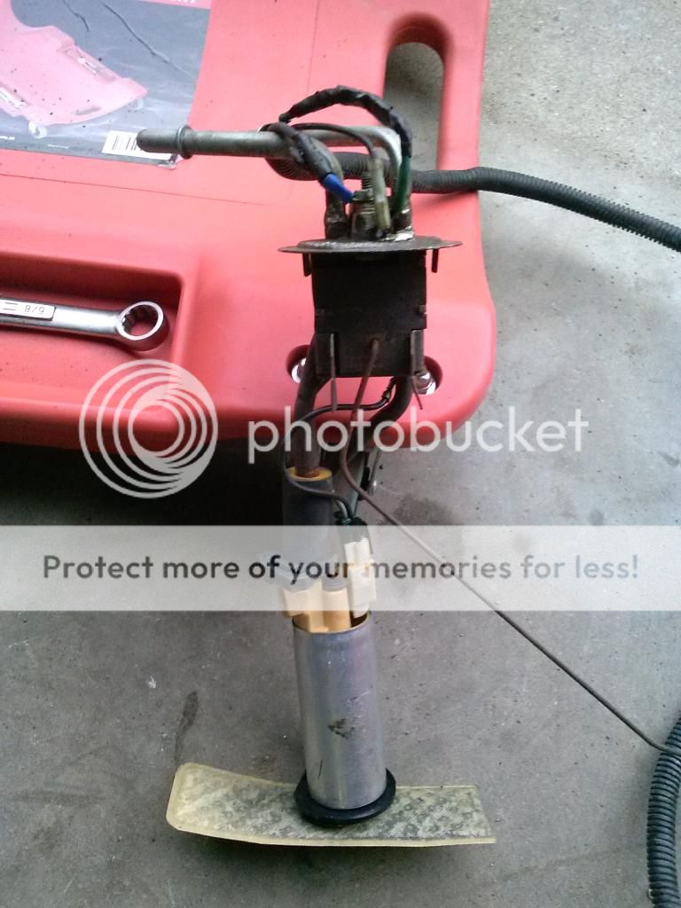

It's the stock pump from 1987-1995 I believe. I'll check to see if the number is on one, as I have 3 or 4 laying around. The pump hangs from the sending unit,suspended into the tank. I added the brackets to my cj sending unit from a Chevy donor.
I found no numbers on any of the 3 pumps I have,but I set it up with a 92 pump and just replaced it with one from an 87.
Dave in Muskegon using JeepForum

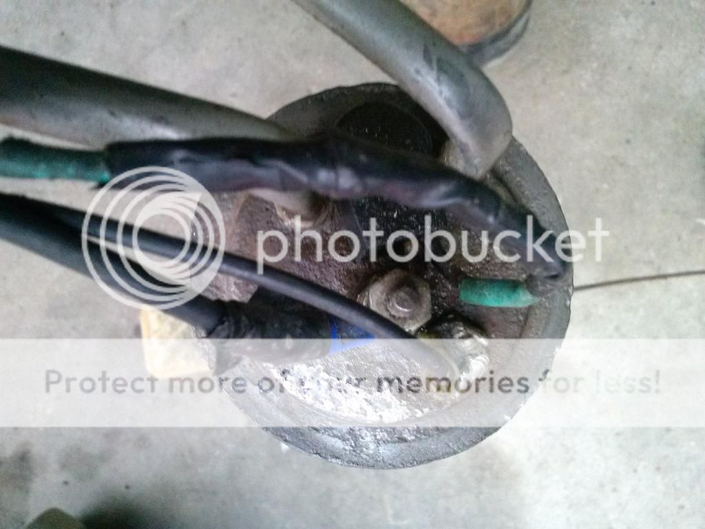

It shouldn't be....you just need to set it so the screen on the bottom of the pump is at the same level the stock pickup would be. This shouldn't be very difficult to assemble. You'll need a cj,or whatever your using,sending unit,a gm sending unit,a soldering iron (a big one) and some cutting tools. This is when I changed mine to quick change fittings. The elbows are available at Parts Plus. They are a elbow repair kit,no number, sorry.
I had to fiddle with the parts so they would fit through a cj sending unit hole as its smaller than a gm hole is.
This shouldn't be too bad to do. I did it,and I'm just a do-it-yourself. And do it I will,if at all I can. So far,I drew the line at a transmission rebuild because of time restraints and that's it. You are out nothing but a few small bucks to try it; if in fact its what you want verses the in-line pump.
