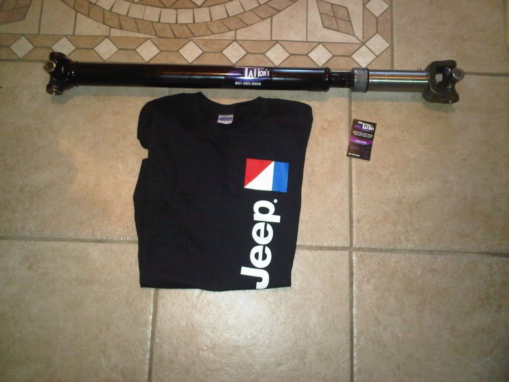

I've had my front drive shaft for 2 years that I got made by Tattons with a "lifetime" warranty. He pretty much said I dare you to break it. Well I broke it and apparently the "lifetime" warranty only covers welds. I will just get another one from someone else and use that one as a spare. I'm not angry... just wanted give everyone a heads up what they mean when they say "lifetime" warranty.

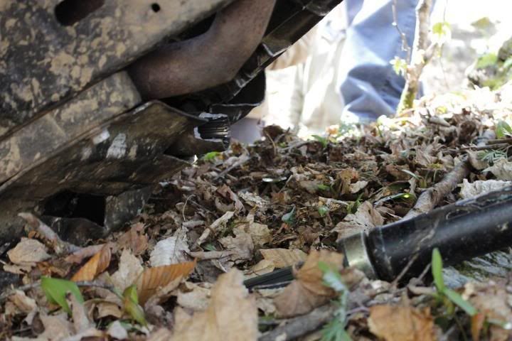

I didnt twist it, i broke a chunk off haha and yes it was the 2" shaft. And this wasnt a post of me yelling etc. I wasnt expecting a lifetime warranty when I bought it but I was just curious when it broke to see what he would say. Everything else about them was great... quick shipping, awesome to deal with etc. So deff not sh!tting on them by any means. I guess I missed the lifetime on welds also on the sight.
Foggy, there is a local shop that will do lifetime on actually breaks but they are pricey. Also I hear that Tom woods will but I have no clue. Also not trying to start anything here haha just saying
Mine broke because even with the extended slip it was at its limit for the shaft length. So it wasnt a design failure either. Again, I wasnt posting this to rage a war lol just to say the lifetime warranty is only one welds but I guess if I payed more attention I would have seen that that is right on the sight.

I'd say the shaft was measured wrong for the amount of extension vs compression.
Or your rig has that much articulation where the 7" slip/spline is too short & insufficient.
I would have been pushing the limit of the 7", so I went with Jessie @ High Angle and had a 18" slip/spline bomb proof 2.5" .250 wall shaft built.
You might need to do the same if 7" isn't cutting it anymore
