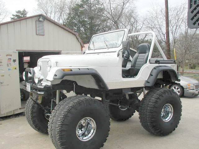

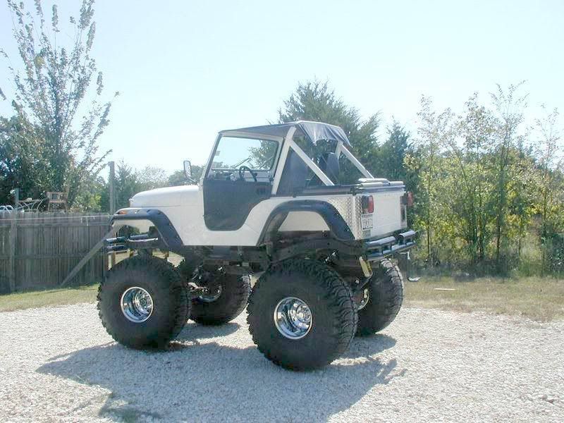

This is the tallest lift hehe

I'm just curious as to where the rear drive shaft goes to on that thing, it can't possibly be drivable, lol!

now that is a CJ.... thats insane lol

Couple of the shaft makers have monster CVs that will run to approx 80 degrees. That CJ would be scary to drive. Doesn't have a full cage either..

There are NBA players that couldn't jump high enough to get into the seat of that thing.

Whoa, whoa...check out the rear shackles in the first picture.
I think they have a shackle-to-shackle thing going on (not a boomerang, just two really long shackles)...I'd hate to have that thing bind up the wrong way...
