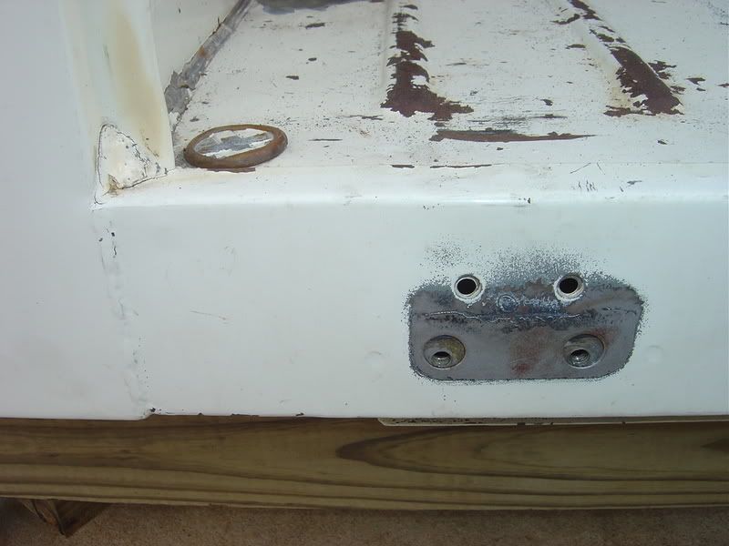

Well we put CJ grills, fenders, and hoods on our YJ's to get more of a classic look so why not the tailgate of a CJ? If anyone has any pictures of how their tailgates secure to the body and the top latches and the body lines of how they match up with the tub, could they post them? A few people have done this conversion but not in a way that pleases me, its always done sloppy and looks bad up close or underneath. I'm going to try making it look cleaner and function better. Thanks in advance.

Here are some pictures, it wasn't too bad to do.
I filled the YJ holes and just put the tailgate in place, had the other latches and welded them on.
A lot of people cut the bottom of the tub to get the 4 bolts in for the hinges and put a backing plate in there.
You can do this or just attach nuts through the holes. It all depends on if you plan on "using" the tailgate or not. If you use nuts, i wouldn't put a ton of weight on it, if you want it for show, it will work for you. If you want it to be really sturdy and supported, put a backing plate on it to help distribute the load.

If you saw the article and have looked at the various online write-ups (I personally did this mod and wrote it up 10 years ago), then what else is there to see? Drill four holes for the hinges, decide how you want to secure the bolts, get the interior brackets from a CJ tub or fab something similar and weld them in.

Alright what I'm getting at is, are there places in the CJ body that are cut away like they did in the article to the YJ body? Do you guys have clear access to your tailgate hinges on the back side? Thats all I want a picture of.

No, no clear access...you have to cut or pry your way into the body channel. This is how I did mine:

I didn't even have do any cutting. The plates just fit through the holes on the bottom and I was able to get them lined up with the holes without much trouble.

I left the 'cages' around my plates so that they'd sit on the bottom of the channel for support.

Alright those were what I needed, Thanks!
