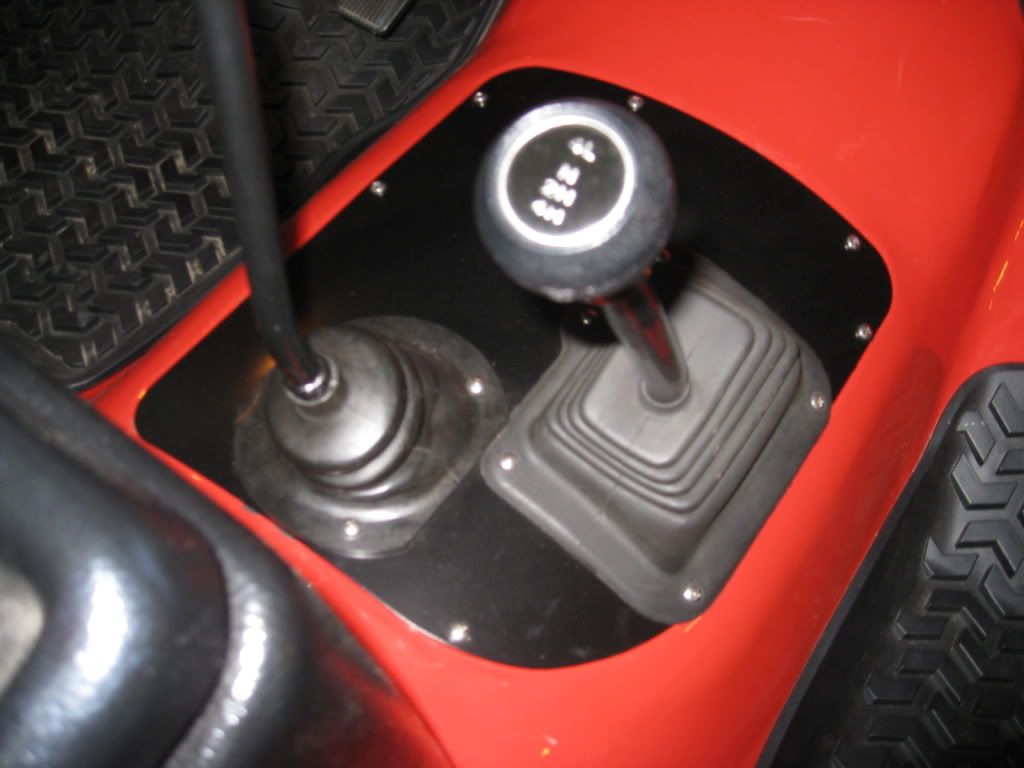

Yes I have. It's got a flat on the side where it goes against the 300 boot. Not a good pic but you can see it. I replaced this boot about every 10-12 years or so after it develops a tear / crack that can let mice in.

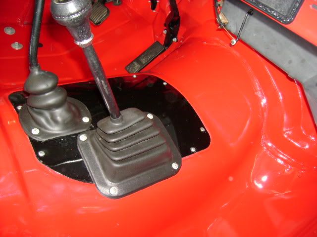

Yes and have had the T4 and now a T5 with the D300, same boots.
Typically the D300 shift boot is screwed to the sheet metal of the tub on the right hand side. I have a Repli-tub made in the Philippines that had the wrong year version of the trans tunnel opening so I made it fit for the later opening and widened it by 1 inch so the D300 shift boot would screw to the new cover I made and not the tub floor.
OEM is pictured below.

Sure, make my pics look like kindergarten crayon drawings!
I did want to add that one time I had gotten a boot, and I don't recall where (prob. Qtec or 4WDinc. or Ariz. Desert Rat), that was the same shape but no folds/pleats, just a smooth side. But that was years ago. And pics on websites can be deceiving. Just sayin'...
Sorry, didn't mean to offend but, there was a lot of wires around said boot and I didn't think it came looking that way from the factory.
Turkish6, if you plan on buying the aftermarket Crown boot, don't waste your time. They are a POS and belong in the trash. The OEM boots are still available from the dealer and cost a little more but they will last 30+ years instead of 30 days before tearing. P/N: J575 2010
