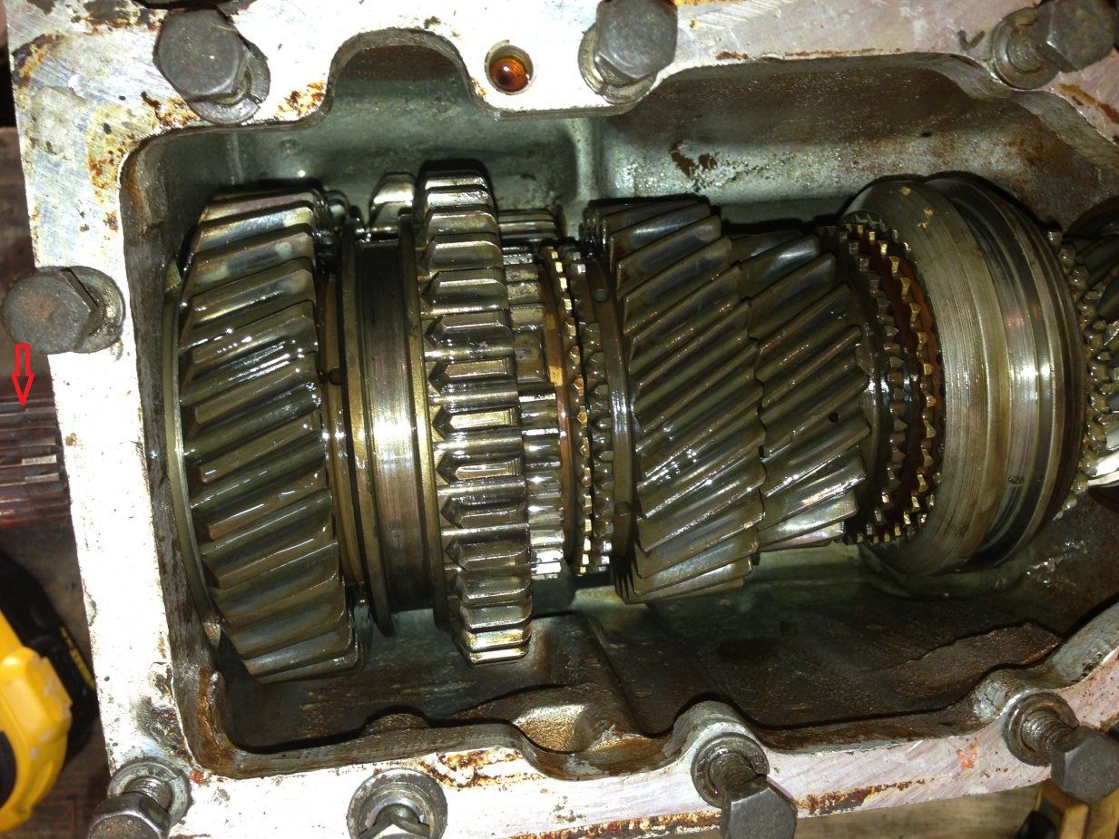

If you think they are only braking devises, your missing half of the job they do.
John, what I meant was that the brass synchro rings act as friction/braking device to bring the respective gear up to speed with the main shaft. Worn synchro rings will not by themselves cause a transmission to jump out of gear. Worn synchro teeth on the gear or shift collar? yes, they could cause a gear to jump out.

I also read that poor motor mounts and tranny mounts could cause it to jump out as well. Has anyone had past experiences with that being the problem?

Only if the are broken and the shifter is knocking on the tub from it bouncing around so much.

Originally Posted by 80cj View Post
While looking at your pic, I happened to notice that your output shaft splines appear to be a bit worn. You might take a look at them.
I just noticed the same thing. They look paper thin to me. Look at this starting at post #59
http://www.jeepforum.com/forum/f8/st...12/index4.html
You can see the difference between new and old splines.
