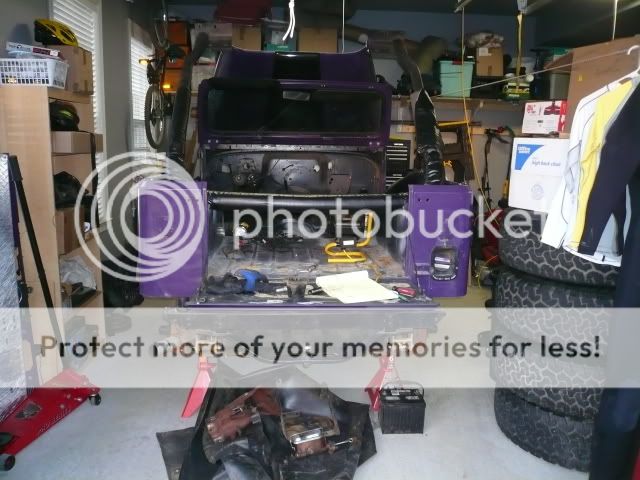

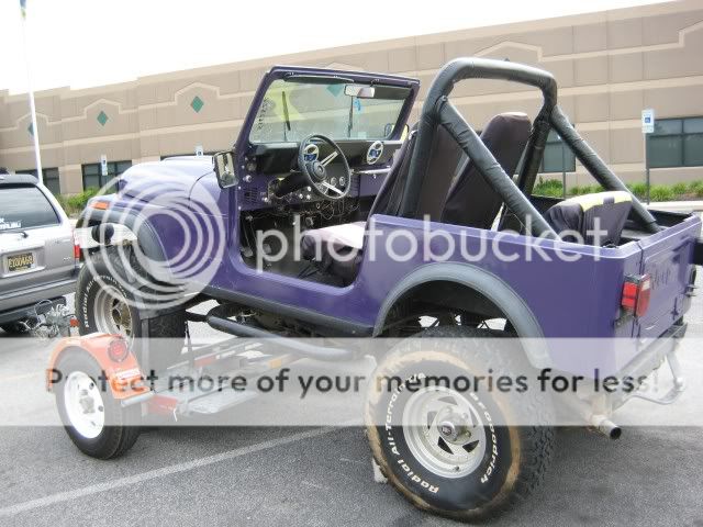

Well I cant say enough about how much I have learned and been inspired by all of you that have embarked on a full tub-off restoration of your CJ and I am finally ready to begin the process and figured I would of course share the process with everyone. I am a NOVICE mechanic. I have owned a few CJ's prior but have only done minor work to them. I cant weld, I just bought my first compressor and have never done anything more to an engine than replace the oil, belts and hoses. I did rebuild my last T150 tranny on my own which was quite an experience but I am looking forward to sharing this project and PLEASE do not hesitate to throw whatever advice you can since I will need it. So, enough banter here's the info:
1983 CJ7
258 I 6
T4 tranny
4" suspension lift 2" BL
Body and frame were in pretty good shape when I picked it up and motor runs a little rich but not too bad. Here
s the day I picked her up. (God knows why someone painted her purple)
1983 CJ7 - Project "Surf Jeep Restoration"

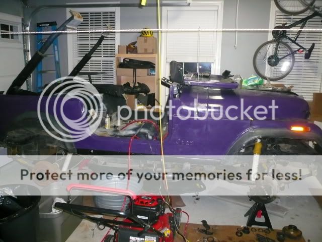

First couple days of teardown (How anyone could do this with just hand tools and no air tools is beyond me)

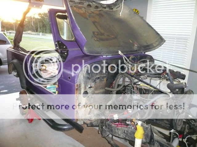

Made pretty good progess in just a weekend and with the help of my fiancee and some dude walking his dog, I removed the tub today. So far except for a few stubborn bolts and having to take the breaker bar to a couple old Torxs the tear-down has gone pretty smooth. PB Blaster is worth its weight in gold.

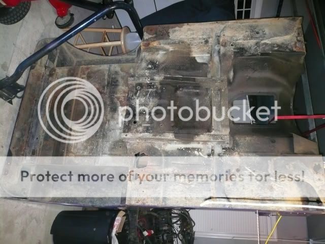

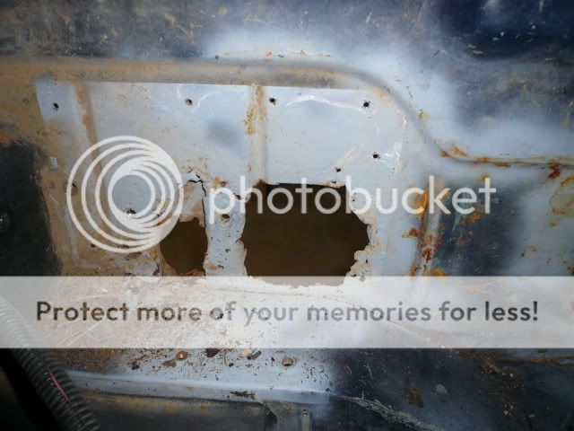

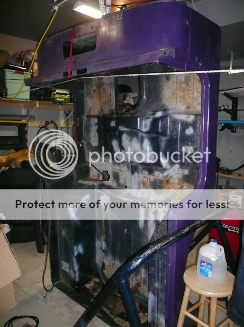

So after pouring over all your build threads, I have reached the "what the heck do I do as far as coatings" debate. I have a buddy that will sodablast anything I need done free of charge so my first step is to take every part, including the frame, body, axles, tranny, etc to him to get cleaned up. I am a little worried about the tub though. Look at the holes where the roll bar was. Is a sodablasting going to make these way worse? I was planning on having it welded of course after it gets blasted but I am concerned I am going to end up with a swiss cheese tub. Any thoughts??

Soda blast it. That is what I do, soda blasting, having it done for free is sweet! I charge. Go over the VERY rusty spots with a SAND, then soda. You will see why. It will save you an extra step....SODA BLASTING will not damage the tub further, though if their is glazing over the tub, it will be removed, as with light bondo jobs. Sand blasting removes heavy rust (unlike soda blasting) and will remove metal if you not careful.
You may or may not be surprised after a soda blasting, usually you have to go over with metal filler to remove pin holes. General rule of thumb applys here, if you can fit you thumb in the hole, patch it.
