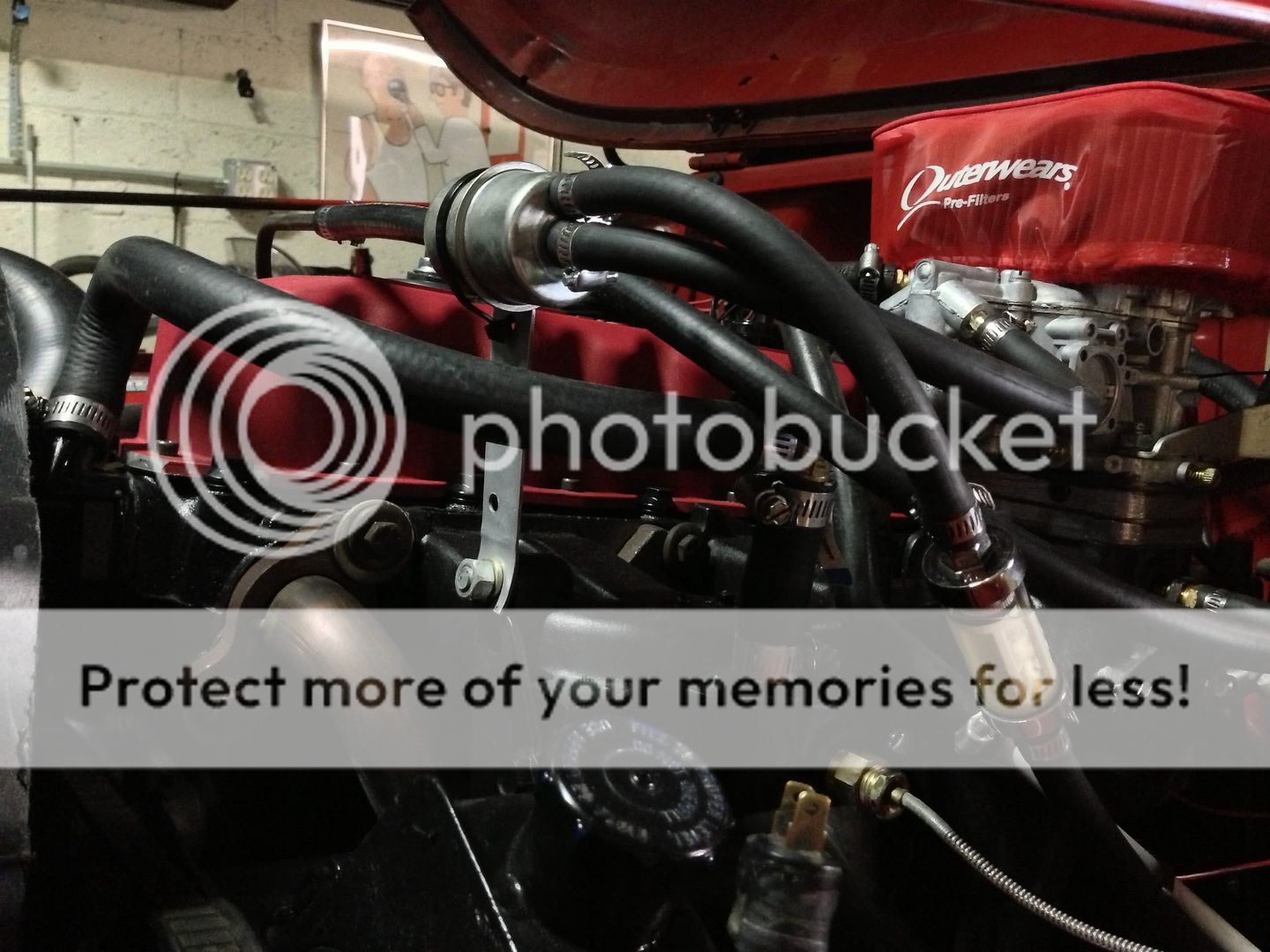

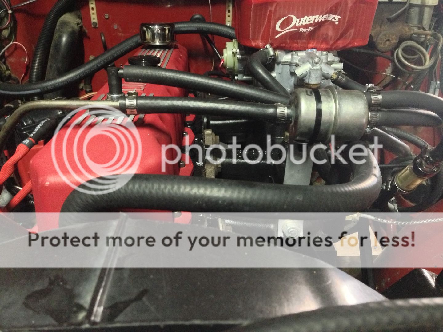

Had nothing to do last night and after a few beers came up with this, a support for fuel filter. Shawn and Matt got me thinking and this was the result. And before you say it, that's not a fuel filter on the return line. Its a "visual fuel return pressure gauge"...that just happens to filter lol.
I thought what the hell it can't hurt, and it's always cool to see what's going on. Hell I think the "clear" DUI distributor cover would be pretty cool too!

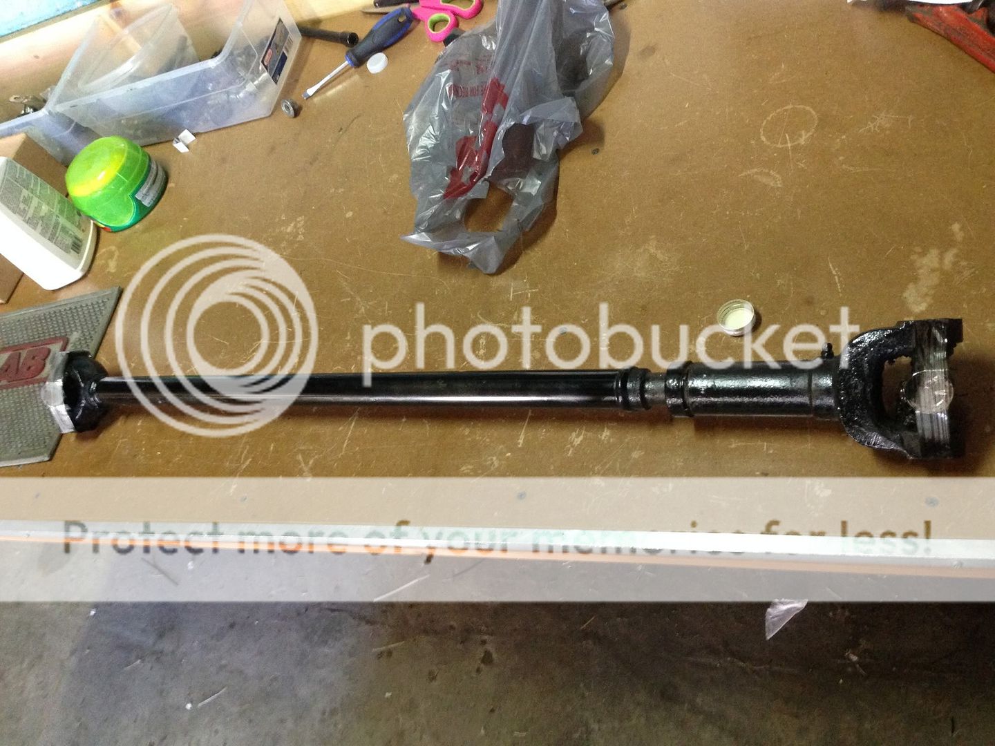

Got the last piece of the puzzle installed today, she's officially 4WD again. I might even go to Bundy Hill this weekend!!

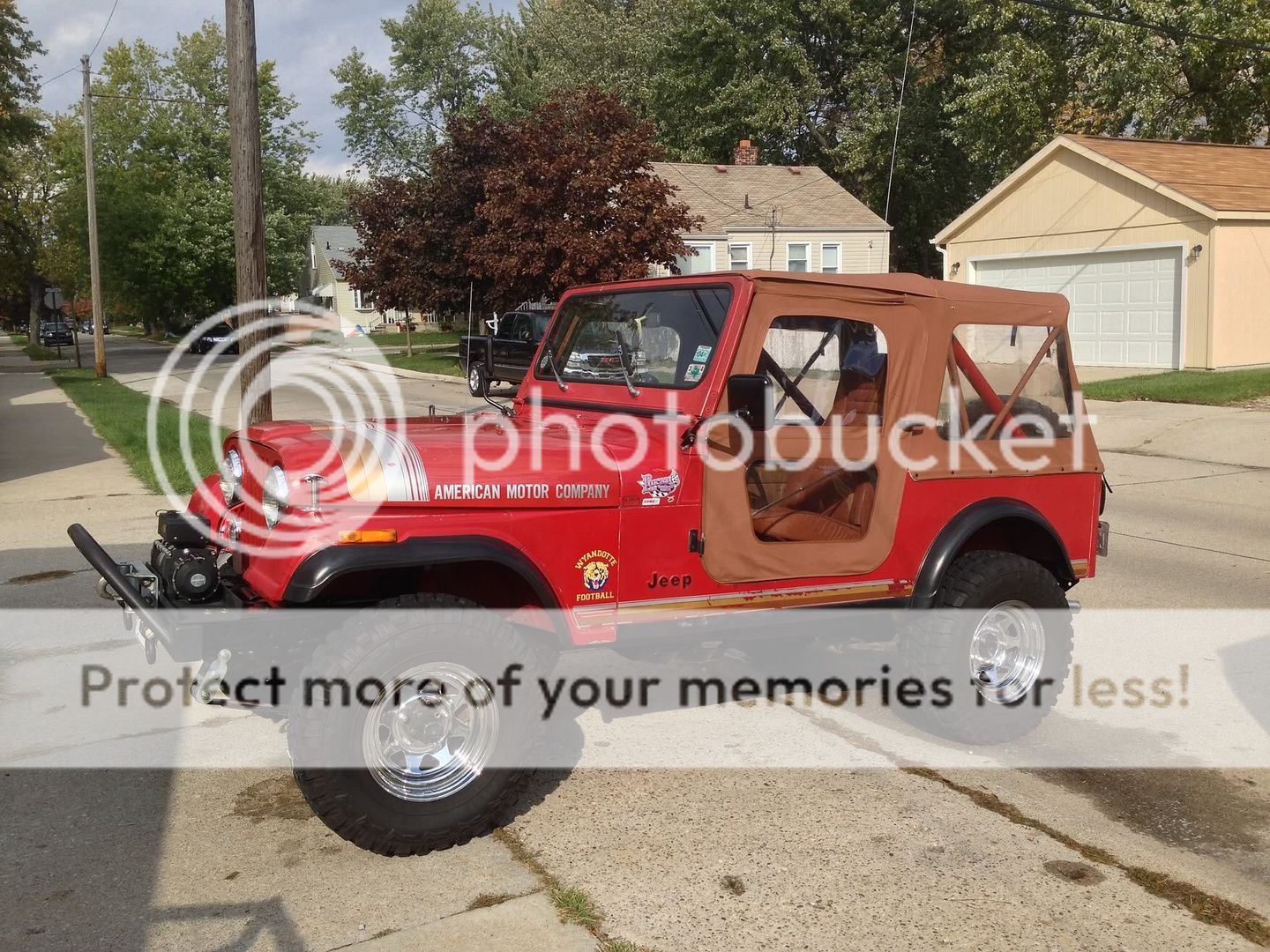

Update: Jeep is running strong. Been having a blast this winter with all the snow and haven't babied her either. Even got a -11 degree cold start in or two. Been ripping up all the snow I can find, and even been hitting the highway a little. I'm running about 66 MPH @ 3K RPM. I feel I can run 3K, three or four times a year, for a few 3-5 hour trips. Not idea I know,.. but for the other 90% of the time I sure do like the gearing!
Paint is really bumming me out though. Chucks are just blowing right off at the car wash. Michigan just wont allow 30 year old paint to live here. The 5 winters my jeep has been in Michigan has surely been its worst. Its either keep it in the garage and stare at it, or use it and suffer the consequences
