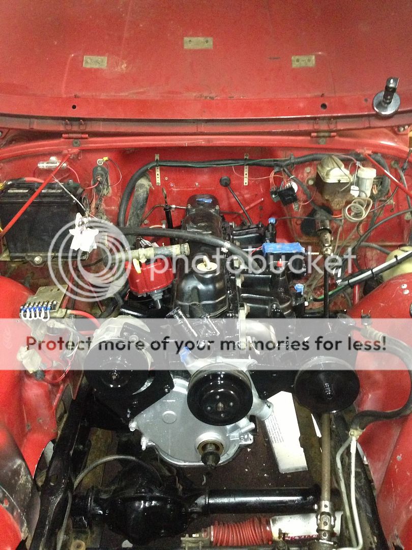

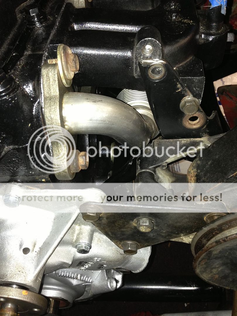

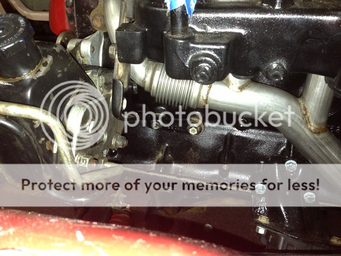

Got some more done, had to really modify the power steering bracket to clear my header.

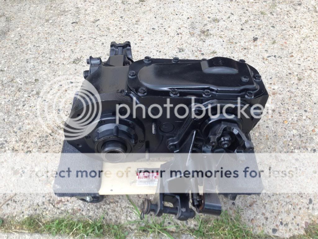

transfer case is in, rebuild cost was 175.00. They said it didn't anything but seals and gaskets and looked good inside. got it in tonight, doing all this solo is kicking my ***. I struggled getting that sucker in and had to let it go once. new drive shafts for sure, but we all knew that. I was at least hoping the rear would bolt up enough to drive it up to the exhaust shop.

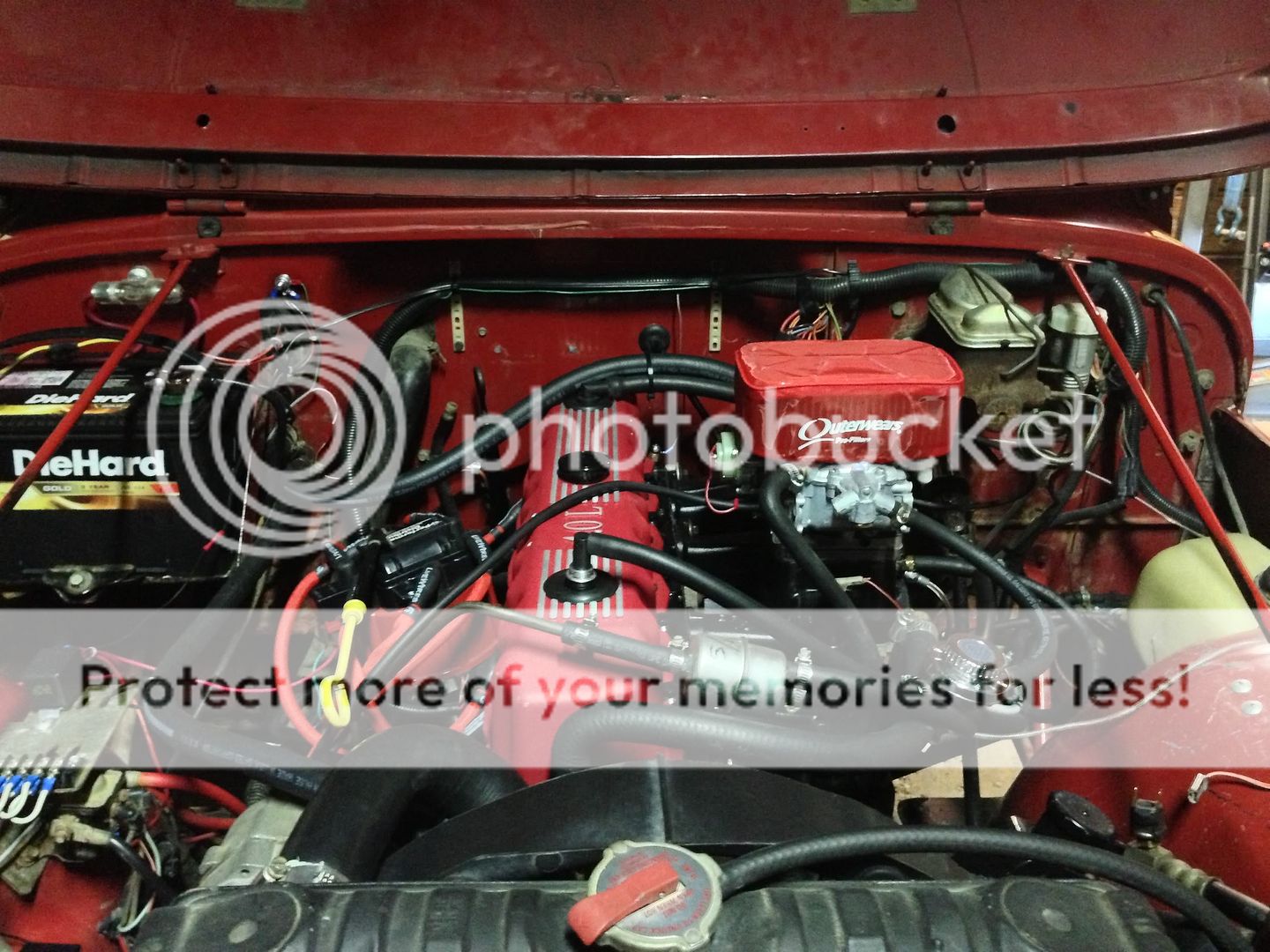

Got jeep running, break in last week. This week has been getting the trans shifting right. I installed a Lokar kick down cable and still getting shift points adjusted. I haven't really updated this post on time but it didn't show much interest. Video to follow of engine running soon

My only critique is your modified fuel line. The reason for the steel line from the pump, running over the top of the valve cover, is to prevent heat from rupturing the rubber fuel line. I'd be leery of your setup.

Thanks for looking, I'll keep an eye on the lines
