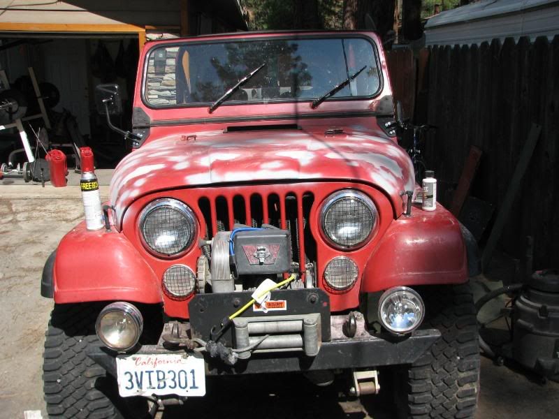

So this all started last winter when I bought my first Jeep an 86 CJ 7. It seemed to be in pretty good condition, just needed a little TLC. Through out the winter I got her running pretty good. Fixed some vaccum leaks, new intake manifold gasket, new Webber carb, Juicebox ignition, some lighting issues and she was running pretty good.
My plan was simple, when the weather warmed up I would do a little body work, put some tube fenders on the front and throw some fresh paint on it. Next year I planned on fixing up the interior. So in early May I ordered a DIY tube fender kit from Whiterhino Fab White Rhino Fabrication's Online Store

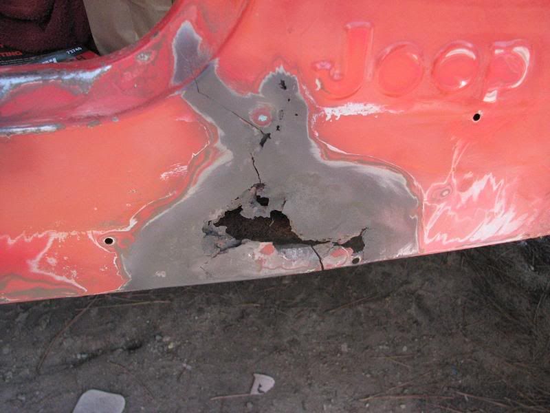

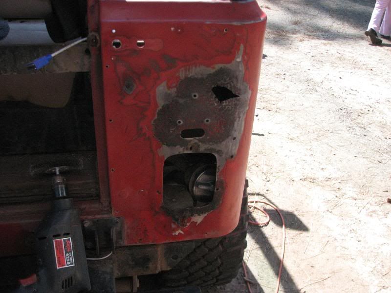

Seemed like a really good deal for $175. I also ordered their inner fender kit for $125. My fenders didn't show up until July, but I had plenty to keep me busy. While I was waiting for my fenders I started pulling the corner garurds, rocker gaurds and such off the jeep to prep it for paint. Well suprise, suprise there was rust and lots of it.
Some examples.
I didn't know how to weld so I didn't want to try and tackle replacing body panels. I planned on learning to weld during the tube fender portion of the project but replacing body panels ugh.
I borrowed a buddy's Lincoln wire feed and did my best at patching some of the holes by welding in some sheet metal. Some of the damage I repaired with fiberglass. This part of the project took me several weeks, we had a lot of rain during June and kinda put a damper on the project.

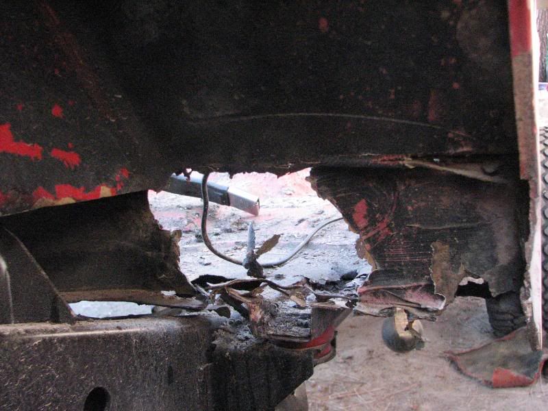

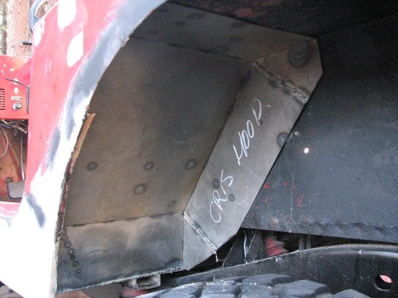

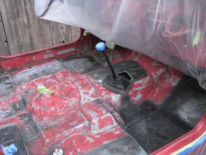

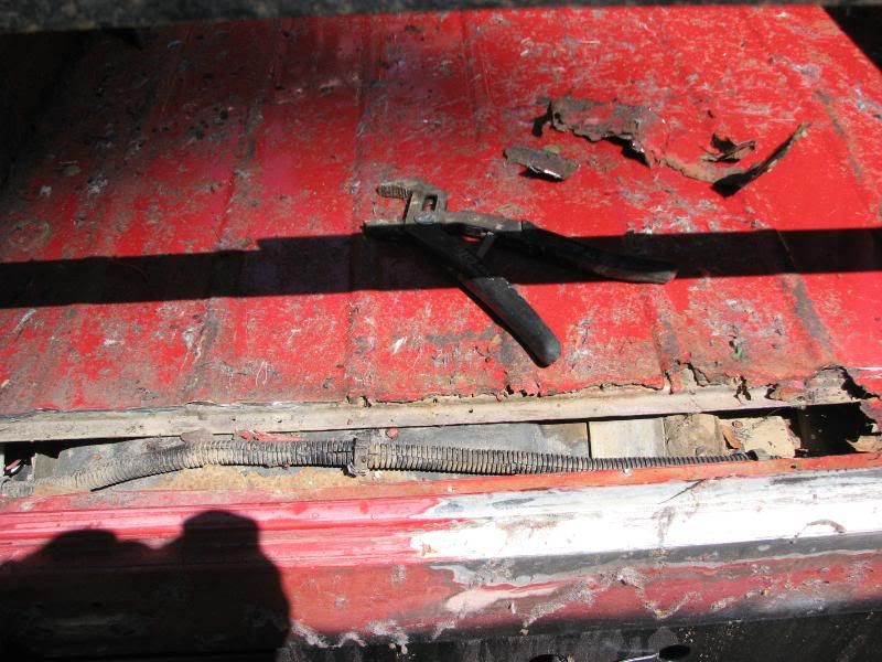

While repairing the body I pulled back some carpet inside to prevent it from catching fire while welding some of my patches. Guess what I found, more suprises. Yep the floor was in worse shape than the body. The front seatbelts were hardly hanging in there by rust. I discovered the rear seat and belts were attached to a piece of plywood that was attached to the fender wells by two rusted sheet metal screws. nothing else.
What was left of the inner fenders after I removed roll bar.

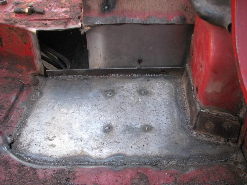

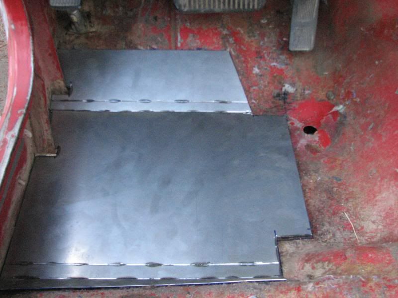

So at this point I decided to go ahead and get myself a welder. I picked up a Lincoln 140 wire feed. I also finally got my tube fenders so I could start on them. I picked up some sheet metal to fix the floor and went to town learning how to fab floor boards and weld.
rear inner fender

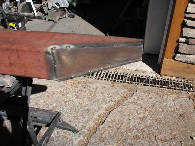

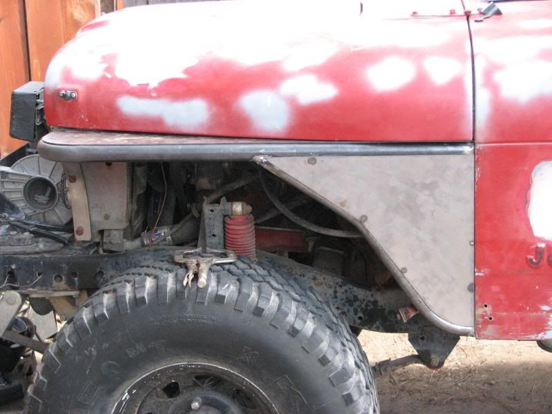

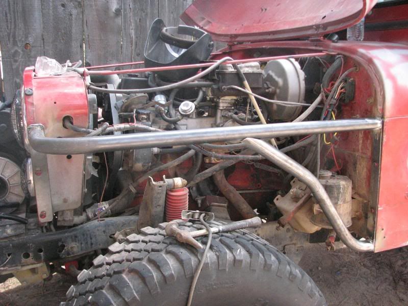

I was pretty happy with the way things were turning out considering this was the first time I had ever done anything like this. I started on the DIY fenders, it was pretty straight forward, everything was pre-cut I just had to do some trimming and welding.
Before:
During:
After:

Inner fenders welded on:

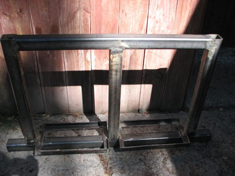

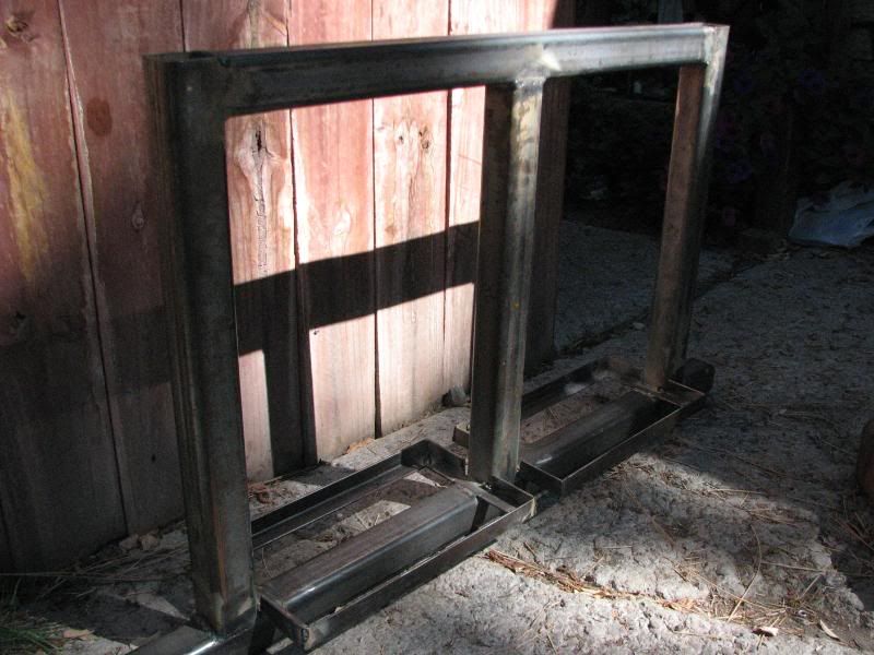

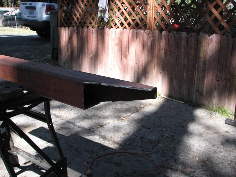

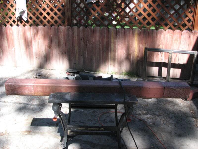

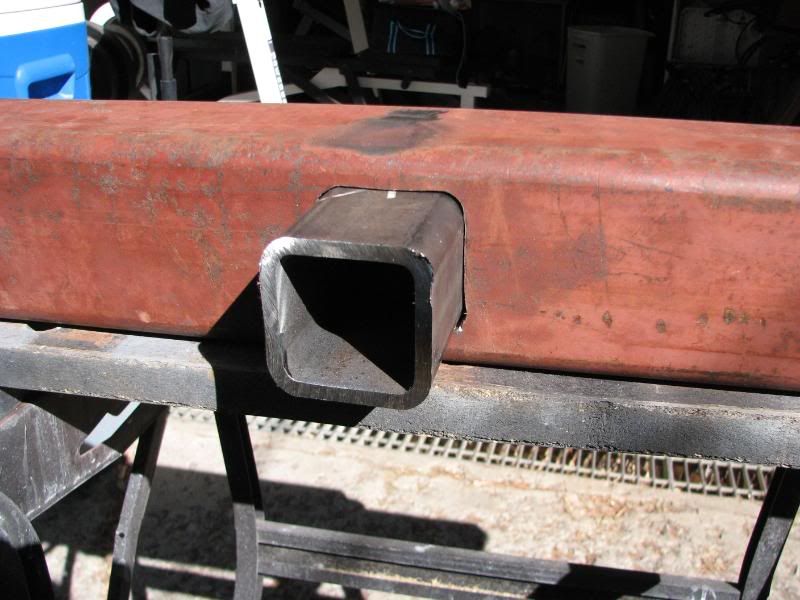

Here are some pics of my progress with the rear bumper / tire carrier.
Johnnylaw is offline

what gauge of sheet metal did you use for the floor boards? looks good!
jsc7002 is offline
post #10 of 134 Old 09-22-2009, 10:41 PM Thread Starter
Johnnylaw
1986 CJ7
Location: Northeastern CA
Posts: 169
I used 18ga for the floors, and yes my welding has definately improved since day one. Welding that thin stuff is pretty tough, just gotta go slow.

Got some more welding done today on the bumper.

in that 1st post second picture it says moe on the frame is that in reference to the band?

MOE was the PO's nick name I guess. Thanks for the kind words.
