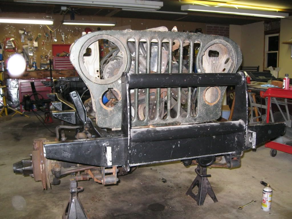

Once I got it home I stripped off the front clip and anything else bolted to the tub.
I then found a set of 31x12.50 Baja Claws for $300 with 75% tread, i mounted them up on the soft 8's and they will be my CJ's new shoes when shes back on the road
While taking off the front clip I found the front edge of my hood was rusted out. I thought it was a weird place for it to rust but in a few days I had a new hood and a pair of hard doors... I got all 3 for $200

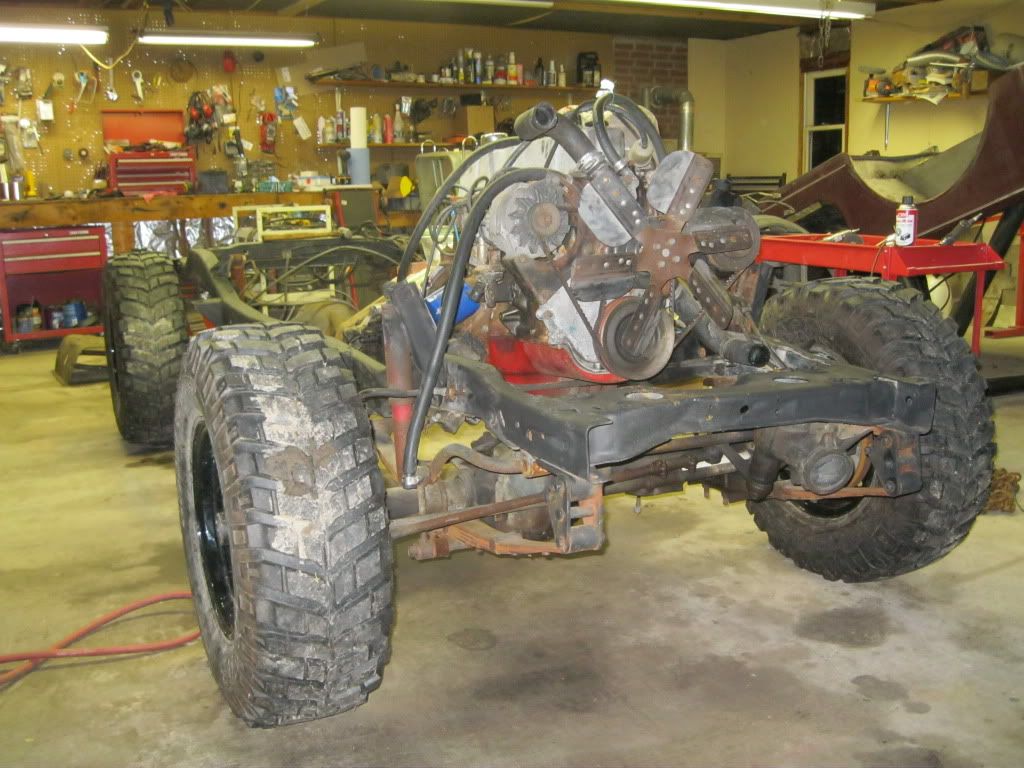

I bought a chain hoist from harbor frieght and used the rafters of my barn to pull the tub
Once I had the body separated from the frame I pushed it out from under, dropped the drivetrain in it, and wheeled it down to the garage to start work

flip those front shackles. They are currie towable shackles and you have them backwards
Ben

I was wondering about that! Ha thanks ben.

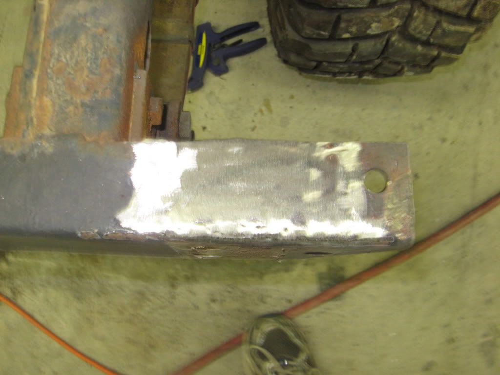

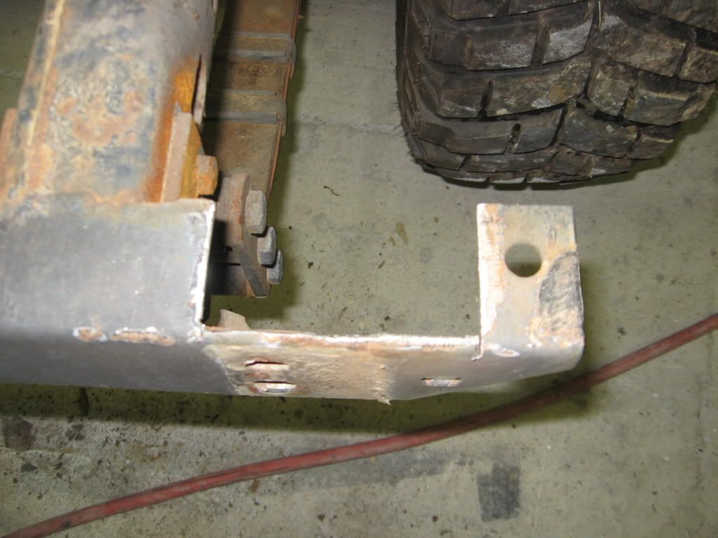

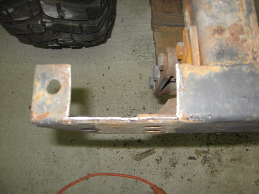

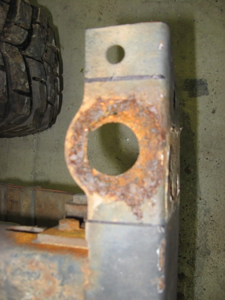

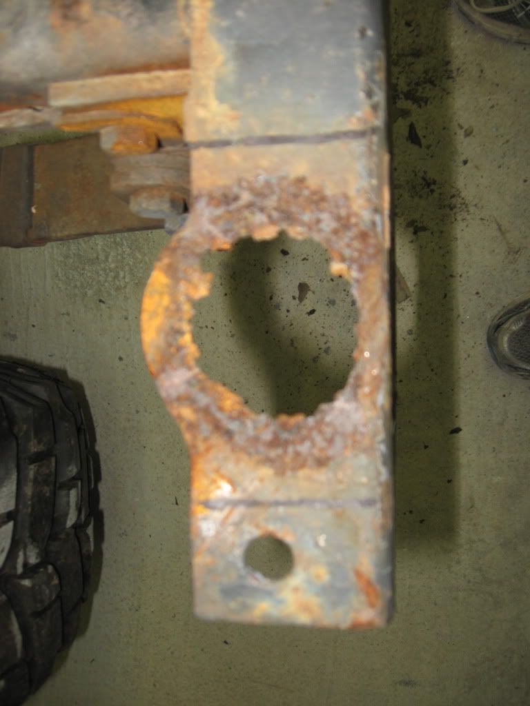

The rear crossmember was rough around the body mounts...
Drivers
Passenger
So I cut out the bad and used 3/16 plate i had around to fix them

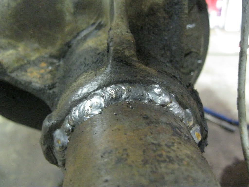

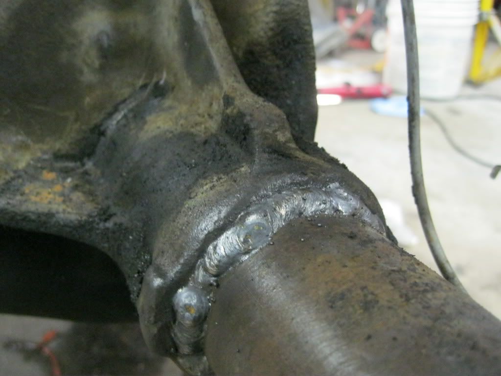

I got the new pinion seal and diff cover gasket on tonight. After that I welded up the Dif tubes and just picked up some tools and swept so I'd be ready to wrench this weekend
Welded Tubes

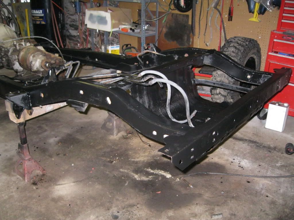

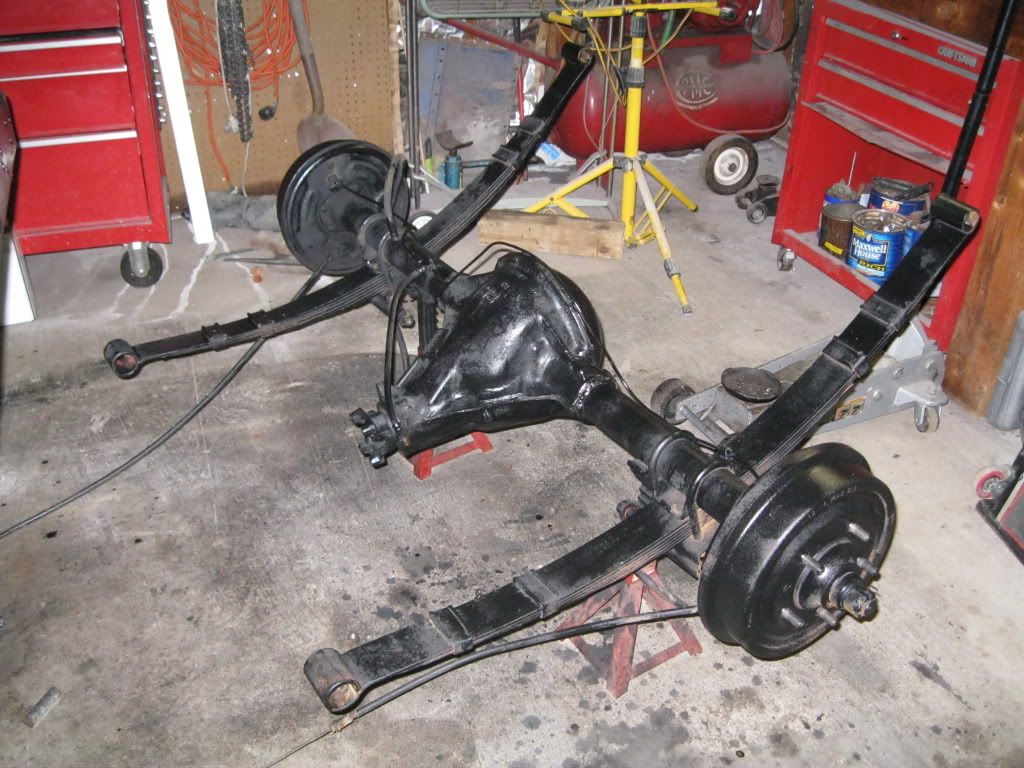

Pulled the rear axle and masket off the drivetrain and painted the frame this weekend... Used this stuff called chassis saver that I can get really cheap from work. It seems like a knock off POR15 but time will tell how it holds up.

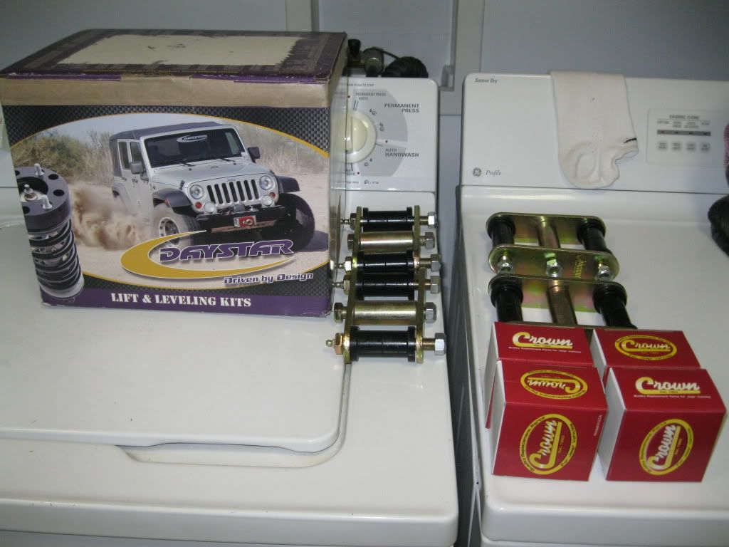

ThE UPS MAN LEFT SOME STUFF ON THE DOOR STEP TODAY!
Front Currie Shackles
Rear Currie Shackles
Main Eye Bushings
Daystar 1" BL

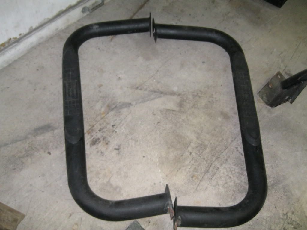

I also picked up a grill shellm, semi rugged front bumper, and some side steps in return for doing a little welding for a guy The bumper is staying but im not a fan of the whimpy side steps so if anyone wants them let me know!

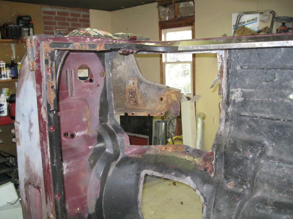

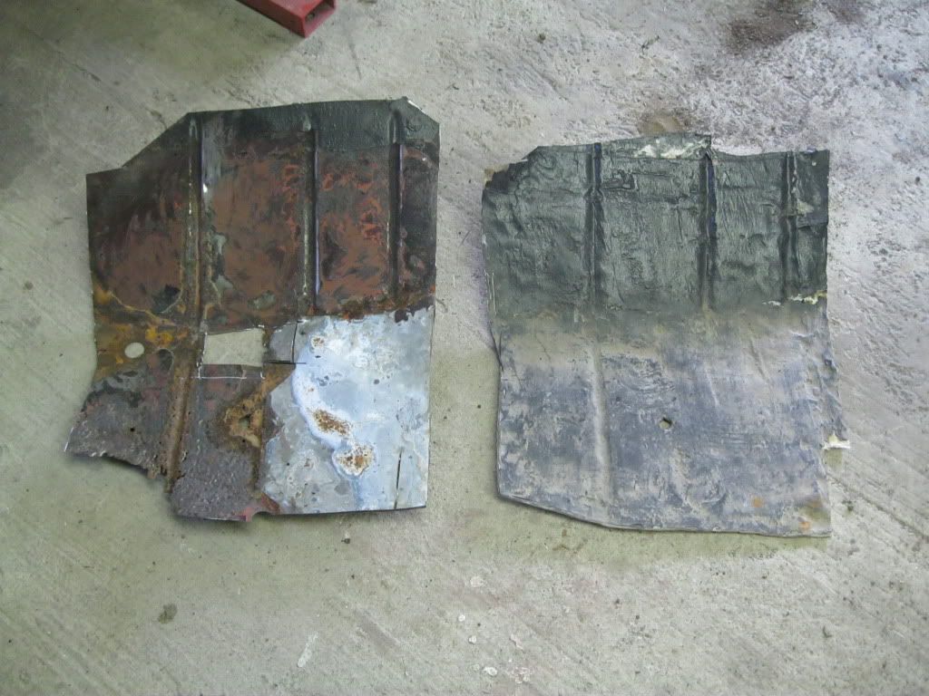

I got started on the body a little today. I cut the passengers floorboard out and found that the PO had gotten a little fiberglass happy...
The steel part is on the left and on the right is the fiber glass that was layed over top of it! You gotta love what people consider proper fixes (sarcastic voice).

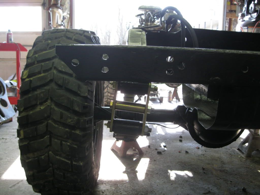

After that I re-bushed the rear suspension and slid the rear back under the frame. One problem though, the drivers side shackle is way crooked? It was like this before I took it apart and I thought new bushings would correct the problem but I was mistaken. Any Ideas on how to fix this issue?

Your shackle hanger looks tweaked from the picture. I am no expert but I bet a new set of Crabtree Tool & Die shackle hangers all the way around would fix that problem.
