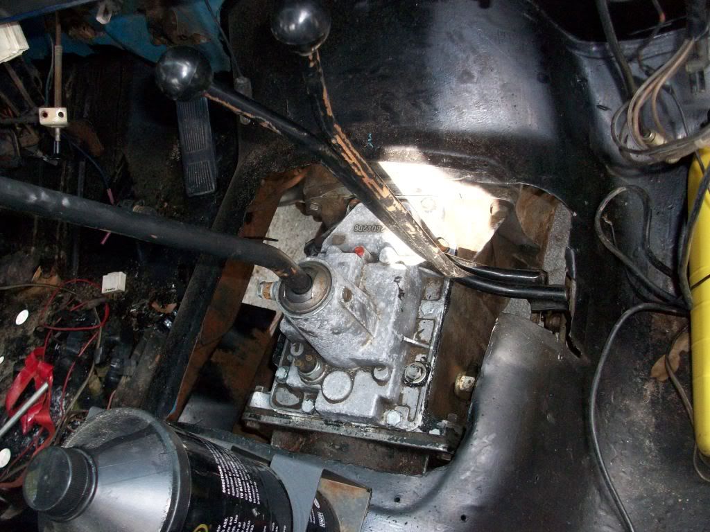

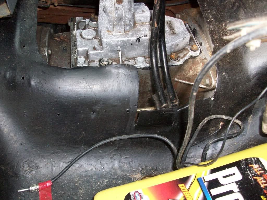

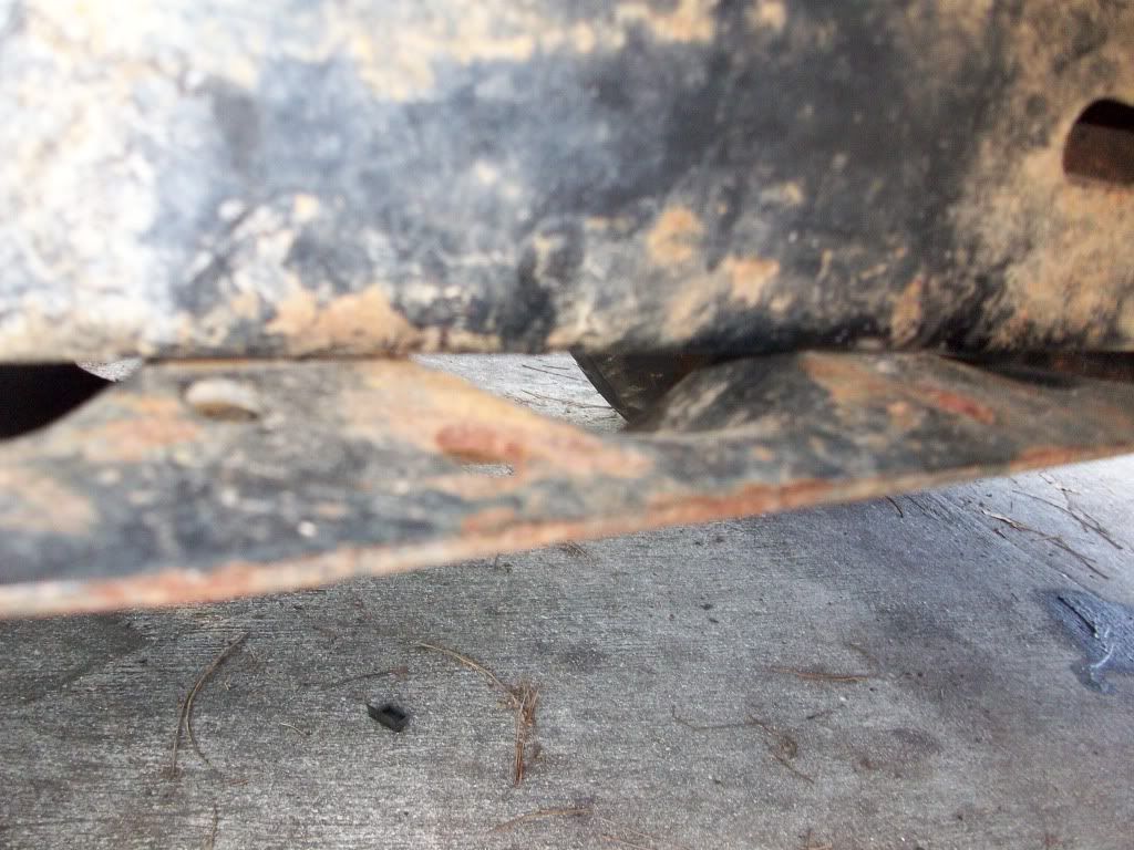

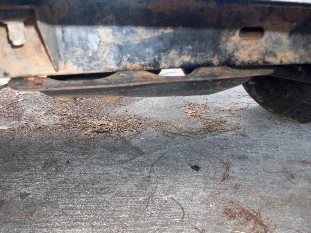

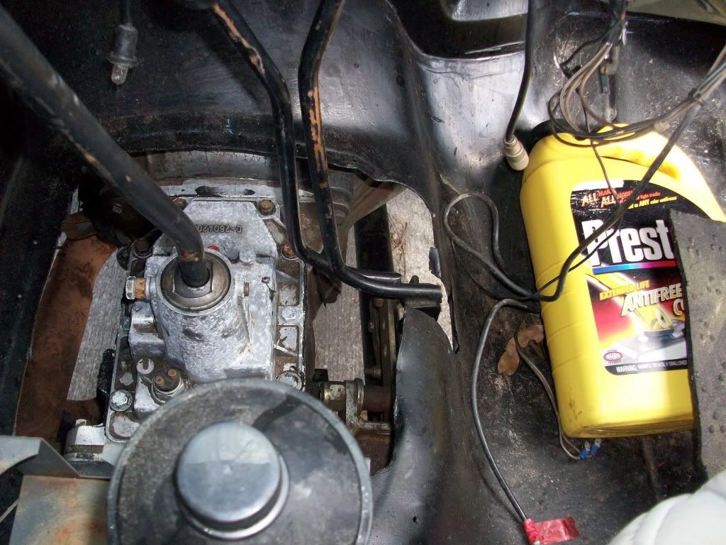

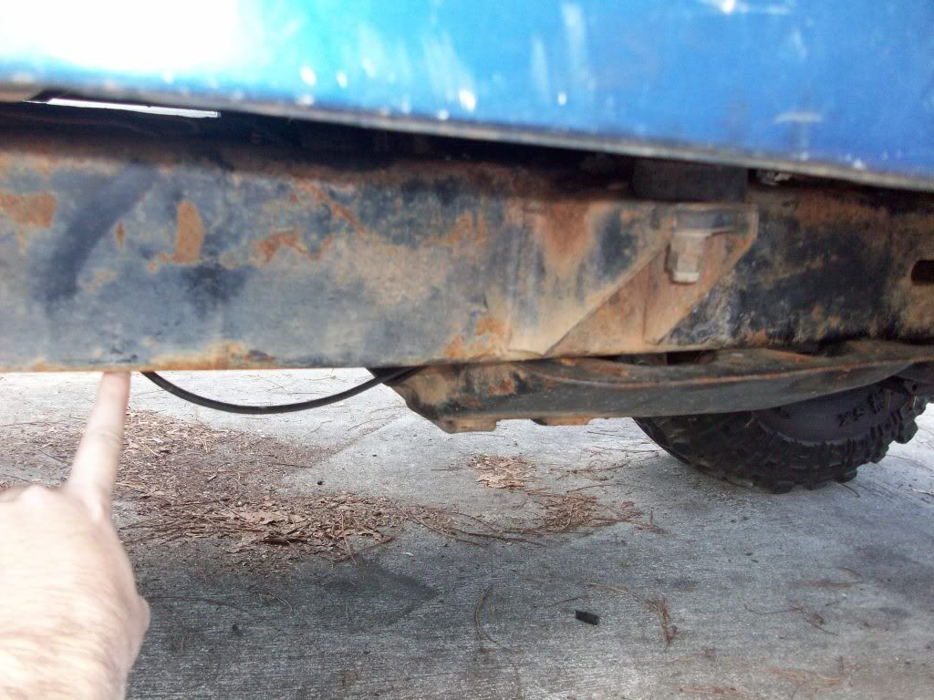

wow, mine looks absolutely nothing like that. I need to go snap a quick picture so I can post on here.
Pics:
Rear most mounting hole in the frame
Overhang on frame:
Inside location of shifters:
Side view of plate on frame:
Skid plate is very hacked up to allow clearance for front drive shaft, as well as rear drive shaft and exhaust. The PO actually had to weld a piece of steel across the skid plate to keep it from breaking in half.
