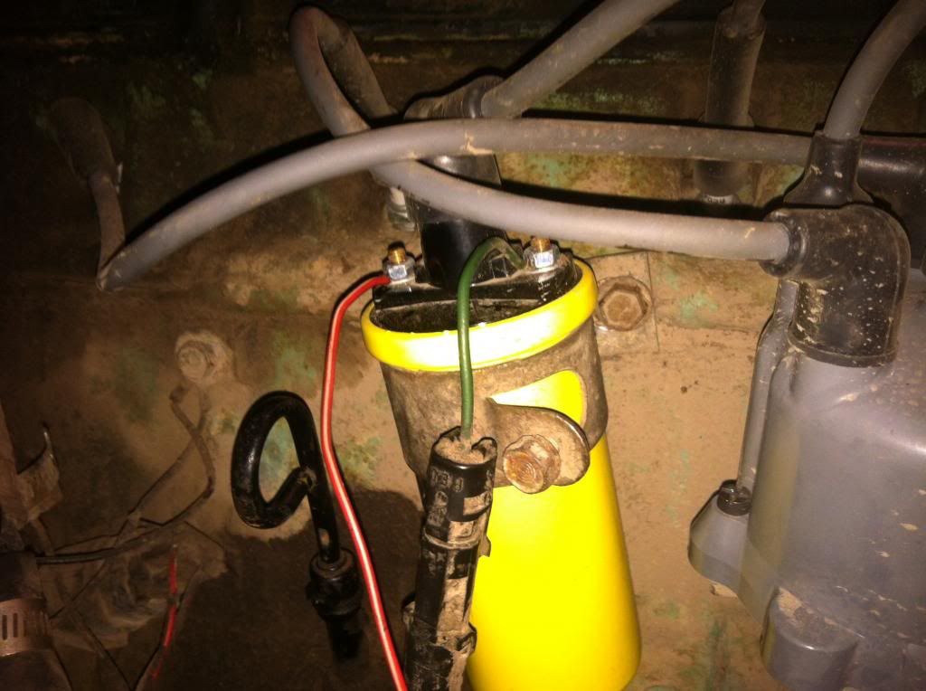

We need to see some pics of the dizzy wiring to the coil.
LG

here you go.
[IMG][/IMG]
i checked the voltage and it was getting about 3.75 to 4. Also i noticed the choke was getting super hot, almost as soon as the car was turned on and the choke would open right up. So i checked the power to that and it was 12 constant.

To get more output on a coil they would design it to pass more current. Unfortunately in a ballast setup like ours, that means the voltage is lower on the primary side. So lower input voltage lower output voltage. Maybe not enough to fire a plug consistently causing you to raise the idle speed, causing the main circuit to dribble gas. It's a vicious circle.
Trying to pass more current through the coil will only burn up the cheap ICM that are available these days.
The choke getting hot is OK.

It also looks like the correct wire for the plus terminal of the coil.
However saying that if it were me I'd still verify that you have a dim bulb probing it to ground with the engine running. Or using a volt meter look for 6 to 9 volts.
86cj74.2L is offline
