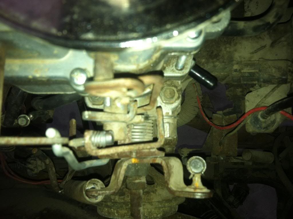

So I got home from work and started to look around and this it what I found
[IMG][/IMG]
It looks like two idle screws are missing? Am I right? If so what do I use to replace it?

Ya looks like they are missing. What is that screw on the other side of the arm with a spring on it. Is the idle adj rigged there some how. Do you have a manual choke? Right now you dont have the screw that does the electric choke on warm up. I was just reading that you could just get any screw that fits to work. There are some videos on youtube that show how the fast idle screw works.
INowUnderstand is offline
post #25 of 116 Old 06-07-2013, 09:06 PM Thread Starter
ryancrotty
1984 CJ7
Location: fort walton beach
Posts: 97
I'm pretty sure it's an electric choke, that screw I'm assuming is in the wrong spot , when I get new screws do they need to have springs on them?

YES, the spring is what 'holds' the screw's adjustment.
You a want 'stiff' spring, BTW.

Ok so do I just get some fine thread screws with springs and screw them in? How do I know there in the right way? Also the one in the spot farther away from the carb looks like it won't touch anything.

The extra screw looks like it was for sol-vac. Which you don't have I believe. See video below
They are in right when the idle is adj right. The one further out sets the curb idle. It rest on a little block and you set it to have idle right when warmed up. It basically keeps the throttle open just a bit. The scew further in touches nothing at operating temp. When working right, you depress the gas pedal all the way. A little stepped cam will pop in place and catch the screw holding the throttle open and the ckoke will be closed. Adjust to about 1700 rpms. After starting blip the gas and it releases the the screw off the first step. And goes down based on temp of engine, where the choke plate is. The scew will hold throttle open based on where it catches the stepped cam. When choke off, the cam Will fall out of place and it is no longer needed, curb idle screw should be the only one touching.

That picture looks to me like to whole carb link. set up is bent, with the screw shown almost off it's stop.
