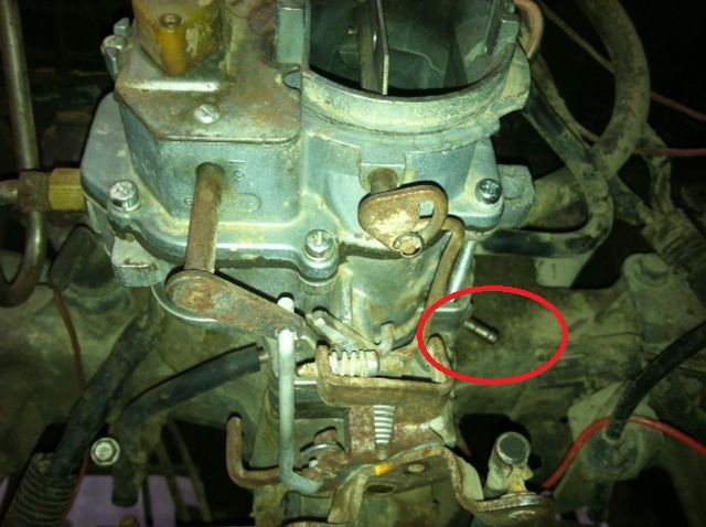

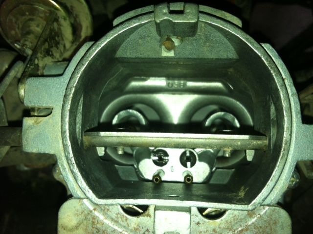

Lately the jeep has been having issues starting up, but once it starts it will run fine until you let off the gas, and then it just dies it wont idle at all. I am figuring the venturi jets need to be cleaned. When i went to dive in and start cleaning this is what i found, i dont know if it looks quite right. Also there seems to be a missing vacuum tube. I have been constantly trying to figure out and redo what the PO has done. Any help would be great.
It seems to have the stock carter on there and i just re did the plugs, wires, cap , rotor and coil
Thanks again for the help i would be lost without jeepforum
Missing vacuum ?
[IMG][/IMG]
Is everything correct here?
[IMG][/IMG]

Is that port capped? If not that will make it idle like crap. That is manifold vacuum. I have the air cleaner dampners hooked up there.

Location: fort walton beach
Posts: 97
It is not capped, should it be ?

If its not used yes needs to be capped. Should be sucking air. If the problem just started then maybe a vacuum line fell off.

Ditto on the vaccuum hoses leaking and that port needs capping off, some use a short length of vaccuum tube with a golf tee or small bolt in the end. With vaccuum leaks you will have problems with starting and maintaining the idle, a very common problem.
When it is up and running again look down that carb and see if there is fuel dripping from the idle tubes. if so they are clogged. They should be flowing a small amount but steady.

It does not have a stock air cleaner. So I just need to cap that port off?

If that goes to the fuel evaporation canister that could be part of the problem as well.

Cap that port and see if it idles better I am sure it will. In 81 that port supplies vacuum to the air cleaner too. Also just so you know the idle circuit does not get its fuel from the boost venturies. All idle fuel comes from two small holes under the throttle plates. the jets you are referring to are air bleeds for the main circuit which only operates at speed

Ya cap it off if you don't see a line to hook into it that fell off
On mine I'm pretty sure That port is manifold vacuum. Don't want the evap canister signal line hooked to that. Canister signal should be hooked up to ported so that it turns on the canister only when on the gas. The purge line is usually t-ed into the same line as the pvc line in the middle of the carb on the back side just over from that port.

CAP IT!
That is where the vac. switches that should be mounted on the valve cover get their signal.
It's a 'live' port.

Bottom line is, that v'port needs to be 'pluged'.

So I capped it of and still have the same issues? What could it be vacuum leaks elsewhere?
