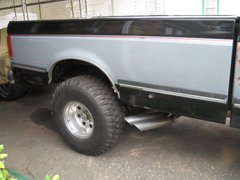

Using 15 inch wheels has it's limitations with tire selection. But if I go with 16x8 inch wheels like this:
I can use these Cooper Discoverer tires, which are 32.5" tall, Section width is 12.2" and the tread is 9.7" (305/70R-16)
I have these on my F350. They last forever, and plow snow great. The concern I have putting them on the Jeep is they are a Load Rating E with a max load of 3,500 lbs. each. That is a heavy duty tire!
Will it be too stiff! I supect they will work on the Jeep with no air in them at all. LOL
Does anyone have any experience using these HD tires or something similar?

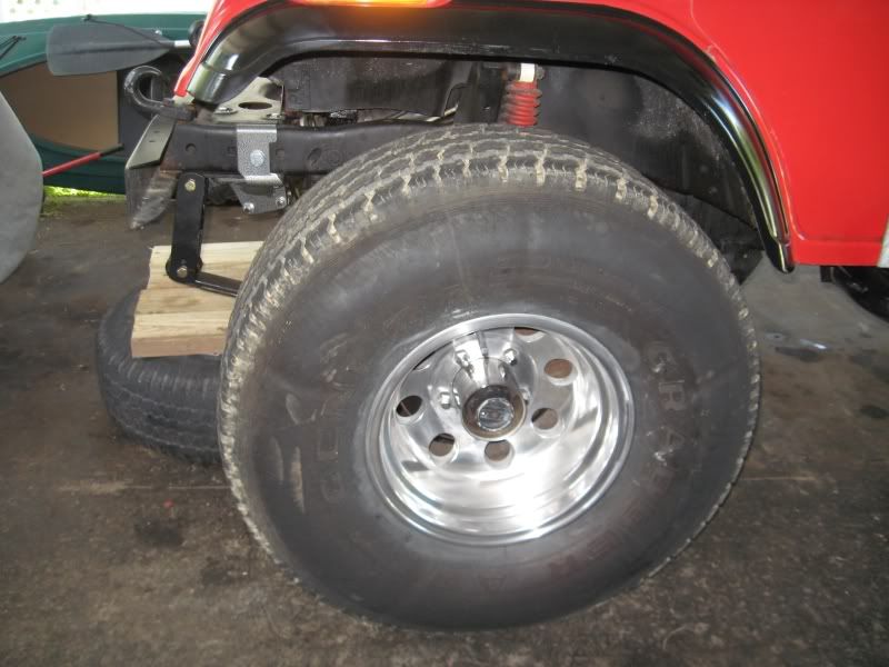

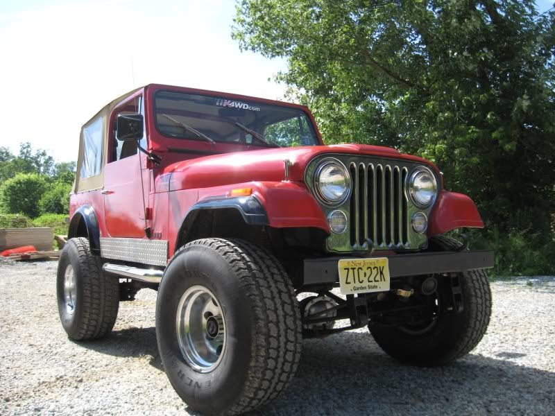

Thanks for the pics Rob. Couple questions:
Are those 33x12.50's?
Are the rims 3.75 backspacing?
What brand of tires are they? I like that big dounut look. Do you like the brand? (Yes, I realize this will be the 4th change of mind on tires this week.)
Looks like they stick out beyond the flares. Is that a problem? Do they throw water in the air when you drive in the rain?
Thanks
Bob
They are 35x12.5x15 General Grabber AP..I don't think they make tgem anymore. They were quiet on the road. Ok offroad..not great. Stuck out passed flares..flung water all over.
CJ7ROB is offline

"flung water all over"
Thanks. That's what I was afraid of. I plan to drive this Jeep all winter and don't want a salt bath every time I take it out. At least not on the top. The bottom is bad enough.
Another change to the wheel plan..............
