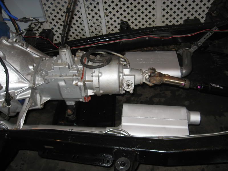

Originally Posted by S76 View Post
The 302 has that nice "Cammy Idle" to it. If I can fit a couple of Flowmaster mufflers under there it will sound real good.
You can..
Any pics of the 302 and Stang?
